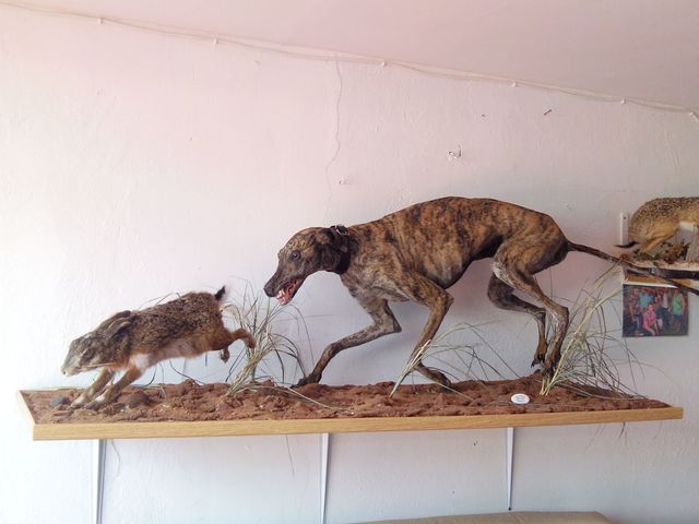

Grimor Posted July 2, 2017 Share Posted July 2, 2017 Probably the most real and cheap method will be Taxidermy. Quote Link to comment Share on other sites More sharing options...
kaylee Posted July 3, 2017 Author Share Posted July 3, 2017 was that meant to be funny? thanks a lot you moron anyway~!!! im learning all about zbrush and its really awesome~! i might be a lot better at this than i thought, it seems very intuitive, like sculpting with clay, and i can use my wacom tablet! ? i made something in sketchup recently that almost killed me ? sketchup is NOT what i would call intuitive, but at the end of the day it inspired me to think that maybe i could do even MORE with 3d programs...???? ? should i use zbush?? is it kewl?? pls let me kno addendum: im assuming that models made in zbrush can be used for vfx, a video game, 3d printed, or whatever... is that right? Quote Link to comment Share on other sites More sharing options...
