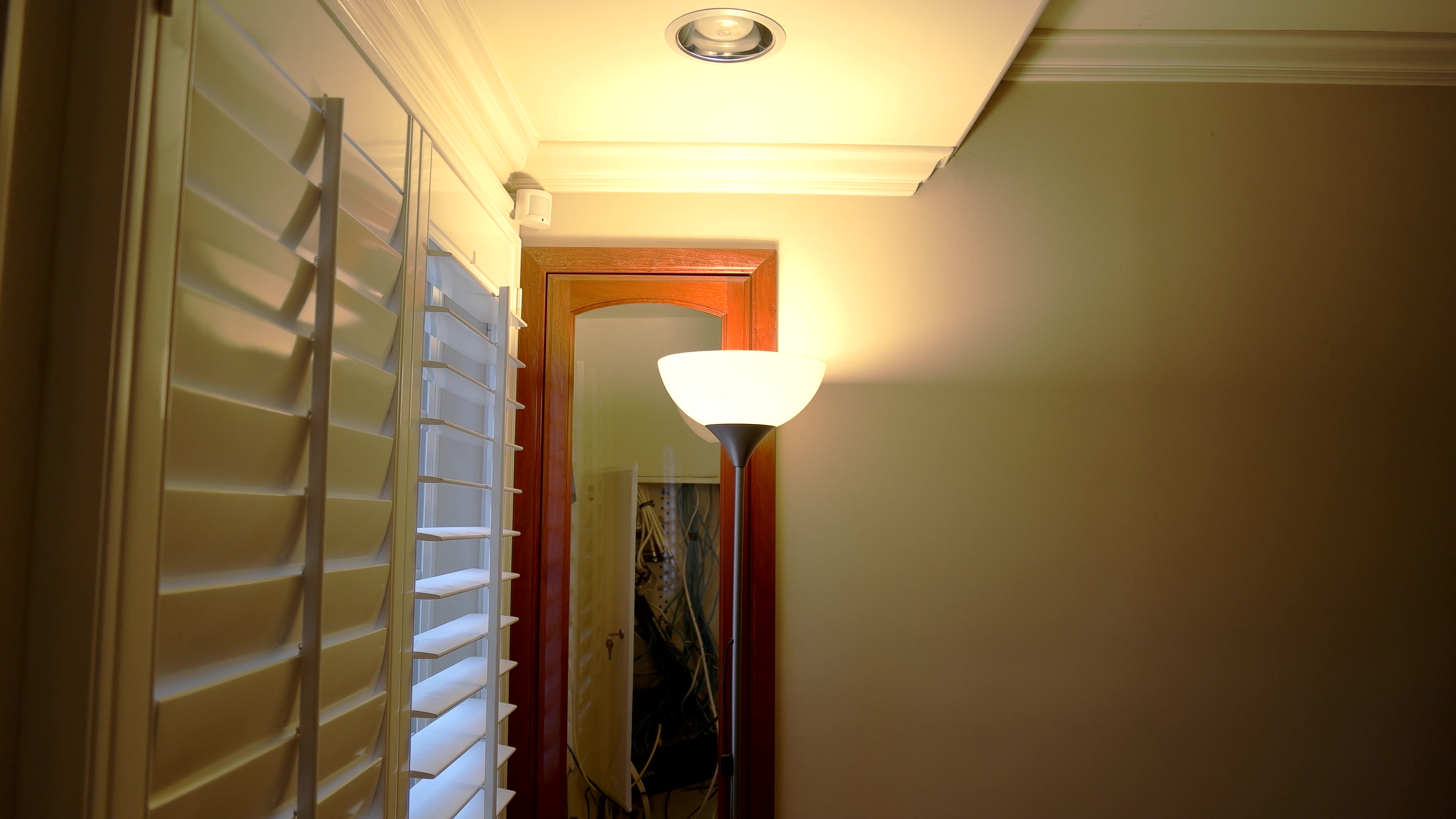

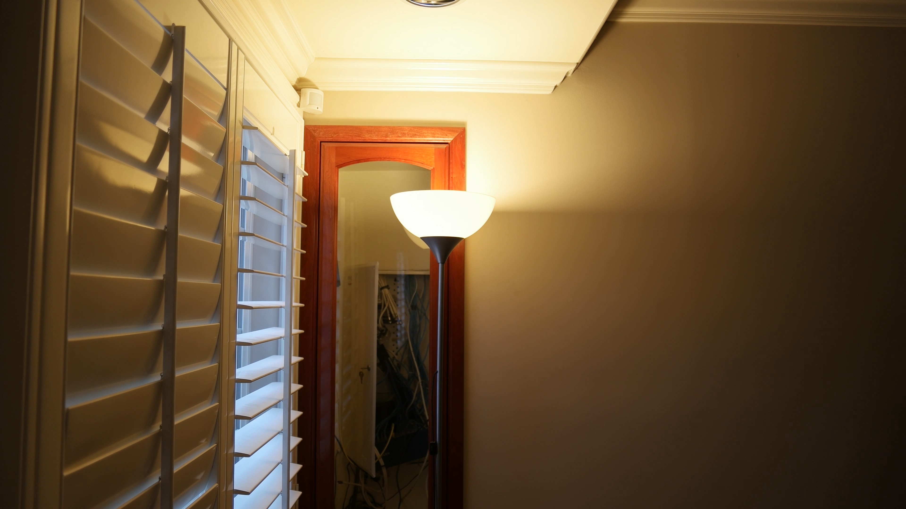

  1. Do you see a color shift when reducing contrast (whether in DR gamma or DR normal)? I'm getting a weird color shift at the transition between highs and mids when I reduce contrast, see attached images (both with DR gamma, but one with contrast 0 and the other with contrast -10) - see the color changes in the light pattern.

This is a bummer - I have seen this same pink color cast on skin tones using Gamma DR. I have not used Smart Range+
