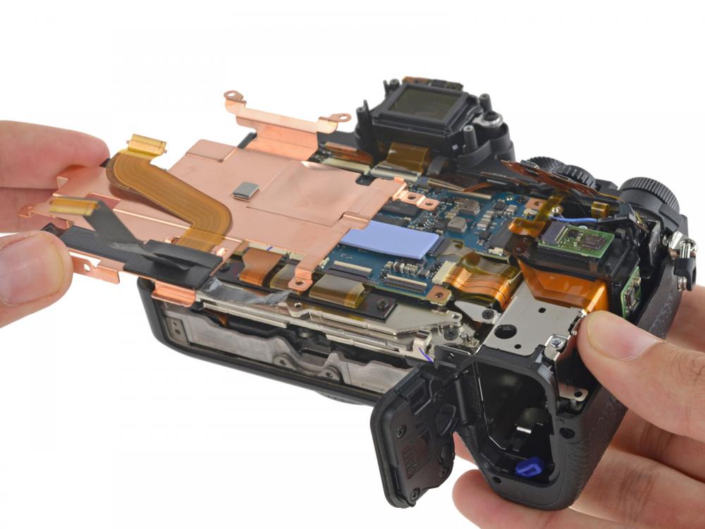

Administrators Andrew Reid Posted August 9, 2015 Administrators Share Posted August 9, 2015 If the mainboard and main CPU backs straight onto the rear (likely) then it is indeed the heatsink being covered by the LCD.Also I notice when 4K is enabled, you can't enable Sunny Weather mode which makes the LCD backlight go crazy bright, thus generating more heat. It gets greyed out in the menus.Worth testing this I reckon...----How often do you record continuous takes one after the other of 30 min+Live events and interviews... that is about it.For everything else including the long hikes in the sun, you should be less worried than you guys seem... Julian and Damphousse 2 Link to comment Share on other sites More sharing options...
Don Kotlos Posted August 9, 2015 Share Posted August 9, 2015 If the mainboard and main CPU backs straight onto the rear (likely) then it is indeed the heatsink being covered by the LCD.Also I notice when 4K is enabled, you can't enable Sunny Weather mode which makes the LCD backlight go crazy bright, thus generating more heat. It gets greyed out in the menus.Worth testing this I reckon...Can you test it next time please ----How often do you record continuous takes one after the other of 30 min+Live events and interviews... that is about it.For everything else including the long hikes in the sun, you should be less worried than you guys seem...Here in Texas things can get hot..Sony made it hard for us to find something to complain about so everybody is focused on this now Link to comment Share on other sites More sharing options...

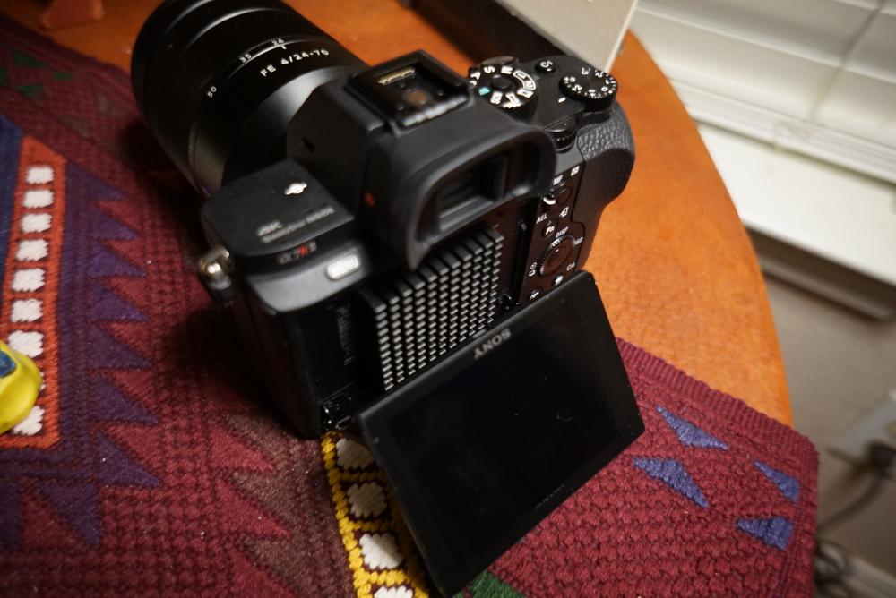

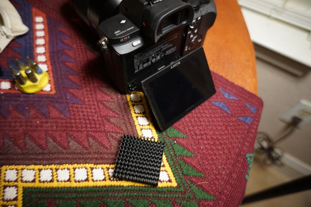

JurijTurnsek Posted August 10, 2015 Share Posted August 10, 2015 So many Sony fans, but still such a lack of understanding of their mirrorless bodies ...1. Anyone who ever has issues with overheating on a Sony NEX body was first advised to keep the LCD pulled out (shame on you testers for not trying that). Some have even attached a small heatsink on the backside to help the heat dissipate. There are many more tips if you just google them, but the gist of it all is the CPU is overheating - an external recorder can go on forever.2. You all compare the A7 line with DSLR sized-bodies - even GH4, NX1 etc. are all insanely big bodies in comparison to the sensor size and the laws of thermodynamics cannot be ignored. On one hand you applaud it for it's small size, then you forget the obvious drawbacks. And the DSLRs you are comparing it to can't even go above line-skipped 1080p.3. Get informed and use the body according to what it is capable of. A7RII in not a video-centric A7 body - wait for the A7SII or do great stills and superb video with this one. Link to comment Share on other sites More sharing options...
