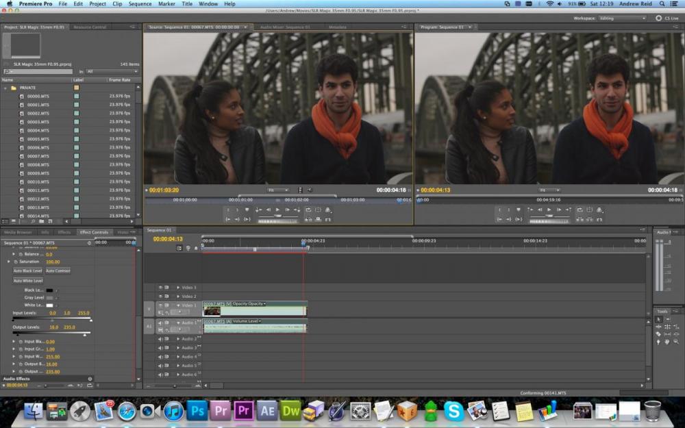

Administrators Andrew Reid Posted September 22, 2012 Author Administrators Share Posted September 22, 2012 [quote name='chauffeurdevan' timestamp='1348320764' post='18899'] From this grab, it seems it is just your monitor that is clipping. Non-calibrated Apple screens are really bad, they are too contrasty, a crush the black by a big margin. Not speaking of being glossy glass. On my calibrated Nec LCD2490WUXi, the left image is correct. No black crushed and - as there is any - no highlight clipped. You should really look to calibrate your screen, or get a better one. [/quote] The monitor calibration did help the blacks but now other aspects of my display are a little crazy and it is too bright. The skin tones on the juggler's face issue - one is clearly awful and the other much better - any idea what causes that? Link to comment Share on other sites More sharing options...

MatthewP Posted September 22, 2012 Share Posted September 22, 2012 Hey Andrew, just a quick note regarding gamma. Note: this post assumes that you think the left image has the 'wrong' gamma setting, and the right one has the 'correct' gamma setting. Are you sure 100% that you're getting crushed blacks and highlights? I did extensive testing some time ago, and have a good method of testing for sure. As you say, the GH2 records in 16-235. The picture you posted before had correct gamma on the left, not the right. The right hand one had, I think (might be wrong), lifted shadows and darkened highlights, giving a pseudo low contrast look, which doesn't actually recover any detail, as black is effectively never truly black, nor is white ever really white. They're limited because 16-235 footage is being shown in a 0-255 space, so black is 16 levels brighter than it should be etc. The way to test is by a histogram. Record some video with the lens cap on, low iso, and fast shutter speed, then record one with 100% blown out sky or something else that's bright. Now, bring it in to whatever editing software you're using, and see if the brighter gamma (the same method you used to get the brighter result on the right) results in a black level that's truly black (looking at the histogram), or a black level that is actually grey (which won't reach down to the bottom of the scale on the histogram). Same for the highlights - see if the "white" you're seeing is truly white, or actually darker. Perhaps comparing it to a webpage window would be easy to spot, too, if you want a visual representation of what the histogram says. All this is assuming that your monitor isn't the culprit of these crushed blacks and highlights that you are seeing... Anyway, if you still don't get what I'm saying, take a look at this modified picture of what you posted... if the blacks were truly being crushed and the whites clipped, I wouldn't have been able to recover that information in the left image. I have literally just lifted the blacks and brought down the highlights on the left image using levels in photoshop. Hope it's useful! I personally just wish everything was 0-255... but anyway :) zephyrnoid 1 Link to comment Share on other sites More sharing options...
galenb Posted September 22, 2012 Share Posted September 22, 2012 [quote name='chauffeurdevan' timestamp='1348320764' post='18899'] From this grab, it seems it is just your monitor that is clipping. Non-calibrated Apple screens are really bad, they are too contrasty, a crush the black by a big margin. Not speaking of being glossy glass. On my calibrated Nec LCD2490WUXi, the left image is correct. No black crushed and - as there is any - no highlight clipped. You should really look to calibrate your screen, or get a better one. [/quote] I have to agree with this observation too. On my monitors the Right image look washed out and the one on the left looks just right... well maybe a little dark but I think that's due to the overcast sky. Link to comment Share on other sites More sharing options...
see ya Posted September 22, 2012 Share Posted September 22, 2012 The GH3 encodes luma over full 0 - 255 (based on that native file Rich pointed to in the other thread) and the stream is flagged 'fullrange' on. Just like Canon and Nikon. This is a departure from the GH2 which was 16 - 235 luma. The full range flag is there to tell the decompressing codec to squeeze luma levels 16 - 235 for playback which is the correct luma range for conversion to 0 - 255 RGB in the media player. If you are seeing 16 - 235 in a luma waveform it's because the flag is working, Premiere and AE on Windows respect the flag. VLC depending on config with hardware YUV->RGB conversion active may not respect the full range flag so it may just crush black and compresses white giving increased contrast if not setup right. Many other media players will do the same. Quicktime Player (on windows at least) does it's own thing and f--ks it up totally. Perhaps test playback with ffplay from ffmpeg or better still Media Player Classic, which will honour the flag. Here's a couple of test files, they are both from the same 0 - 255 YCbCr source file, one is encoded with the stream flagged full range on, as GH3, Canon, Nikon MOVs, the other flagged full range off. [url="http://dl.dropbox.com/u/74780302/fullrangetest.zip"]http://dl.dropbox.co...llrangetest.zip[/url] If your media player / NLE whatever doesn't display the 255 & 16 text then you won't be viewing GH3 or Nikon or Canon MOV's correctly, it will crush shadows and compressed upper levels to white. If you do see the text then you can check if the levels are correct and not stretched the other way by doing a frame grab and checking in a image editor using the sampler to check 0, 16, 235 & 255 RGB values correspond. Link to comment Share on other sites More sharing options...
see ya Posted September 22, 2012 Share Posted September 22, 2012 [quote name='EOSHD' timestamp='1348309262' post='18887'] [img]http://www.eoshd.com/comments/uploads/inline/1/505d90ded65c3_gh2levels.jpg[/img] For reference this is the levels problem I am still having with the GH2 after all these years, and now GH3. Why does my Mac not recognise that GH2 footage should be 16-235 not 0-255? Quicktime treats it as 0-255 as well, crushed blacks and blown highlights. Full resolution screen grab: [url="http://www.eoshd.com/uploads/gh2-levels.jpg"]http://www.eoshd.com.../gh2-levels.jpg[/url] [/quote] Because you're looking at the RGB interpretation, which will be 0 - 255 from YCC 16 235. What does the YC Waveform show? Link to comment Share on other sites More sharing options...

zephyrnoid Posted September 23, 2012 Share Posted September 23, 2012 [quote name='MatthewP' timestamp='1348351052' post='18932'] Hey Andrew, just a quick note regarding gamma.... if the blacks were truly being crushed and the whites clipped, I wouldn't have been able to recover that information in the left image. I have literally just lifted the blacks and brought down the highlights on the left image using levels in photoshop. :) [/quote] Well monitors matter a lot, as is the proper calibration thereof. Indeed that a histogram will deliver a numeric read of the image, irrespective of monitor calibration. Obviously, a $4,000 FSI costs what it costs because of how accurate its CLUT is in depicting the full scale & gamma of an image. Link to comment Share on other sites More sharing options...
