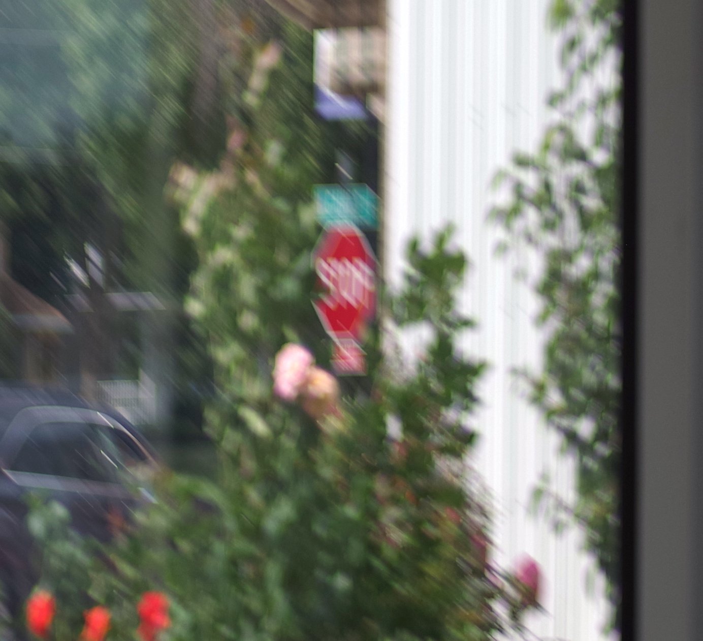

dr5chrome Posted April 12, 2021 Share Posted April 12, 2021 On 4/8/2021 at 10:58 PM, Henchman said: Yes, it does. Hench. My sankor 16D is having a focus issue, but not an infinity. I believe it is alignment. On the 16D do I align this scope at the rear or is the front adjustable? thanks. dw Link to comment Share on other sites More sharing options...
Henchman Posted April 13, 2021 Share Posted April 13, 2021 On 4/11/2021 at 8:16 PM, dr5chrome said: Hench. My sankor 16D is having a focus issue, but not an infinity. I believe it is alignment. On the 16D do I align this scope at the rear or is the front adjustable? thanks. dw Yes. The front. Loosen the guides and rotate the front to the left or right to fix focus. Link to comment Share on other sites More sharing options...
