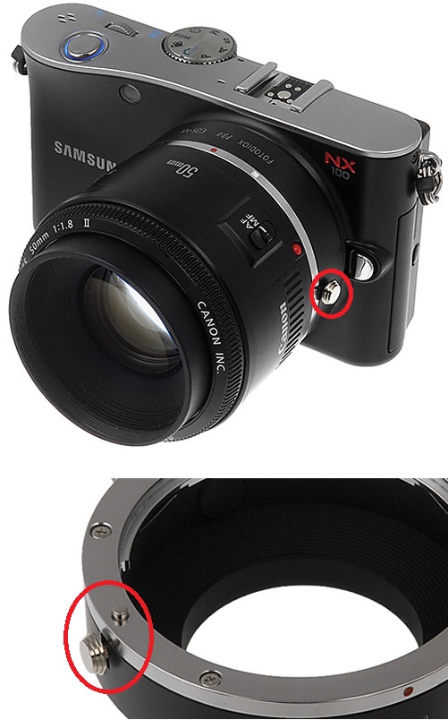

Guest Ebrahim Saadawi Posted October 12, 2015 Share Posted October 12, 2015 @Sekhar The adapter has the same Canon EF lock system, which is a very small metal pin that inserts into a corresponding hole on the lens, therefore making it impossible to turn the lens/remove it. The pin is positioned on a spring lever, when you press the release button, the pin retracts down away from the lens hole, so you can freely turn the lens as long as it's pressed down. Slide/press the button/lever towards the camera body, removing the mount pin and allowing lens turning/removal. Press it in the direction you press on an actual Canon body mount button. (the same direction as if you were pushing the pin itself from the lens hole)This little boy over here:According to your complaint the obvious diagnosis is a stuck button/lever with the pin inside the lens making it attached. If that's the case and the button is just completely fixed/stuck, send it to Fotodiox for a replacement. (they sent me 2 replacements before with one issue). I would've advised opening it up DIY style to get the pin out but I don't see any screws to get in when a lens is mounted on. Link to comment Share on other sites More sharing options...

Sekhar Posted October 12, 2015 Share Posted October 12, 2015 Slide/press the button/lever towards the camera bodyThanks a lot, Ebrahim, that released it! I was pushing the pin inward rather than slide it away from the lens. So, the adapter works just fine, it was user error...sorry everyone for the false alarm. I change my vote to recommended as I've had no other issues with the adapter. Except of course for lack of aperture control, which some other adapters have, though I believe it might result in vignetting when you go wide.One MAJOR issue I have with the adapter approach in general is that I'm not getting any focus peaking in EVF with video. I know it's possible when using the LCD (you need to click on the little icon that appears on the screen), but I don't know of a way to get it with the EVF. Does anyone know a way? Focus peaking is invaluable for me (and I'm sure many others) as I generally shoot with manual focus, and I'm able to use it only with my Samsung 16-50. I really wish somebody produces a smart adapter that supports this and AF.BTW, Ebrahim, why did you have two replacements for the adapter? What problems did you have? I'm wondering if there are QA issues with the FotodioX that OP and other buyers need to be aware of. Link to comment Share on other sites More sharing options...

Calum MacPhail Posted October 12, 2015 Author Share Posted October 12, 2015 The way to push the button is a bit tricky, they should have drawn a little arrow and an unlock symbol under it. I kept pushing it too the first couple of times. It's a great adapter anyway with no issues whatsoever. Highly recommended. BTW they make one with a built in iris assembly, anyone knows the downsides of that? could be a great solution to control iris.http://www.bhphotovideo.com/c/product/1146821-REG/fotodiox_eosa_nx_apt_declk_pro_lens_adapter_with.html/prm/alsVwDtlThe return issues were with another product, their absolutely useless Excell speedbooster. I thought mine was broken given how soft it was, so replaced, the same, then knew it's what it is, only sharp beyond f/8 (really?). So it wasn't a QC issue but a whole design failure of a product. I advice they keep away from the glass making and stay in mechanics!I've heard really bad things about those artificial apertures, ranging from poor bokeh to vignetting. Haven't tried one myself however, but I could see how that wouldn't perform to the same ability as the lenses actual iris. Link to comment Share on other sites More sharing options...
