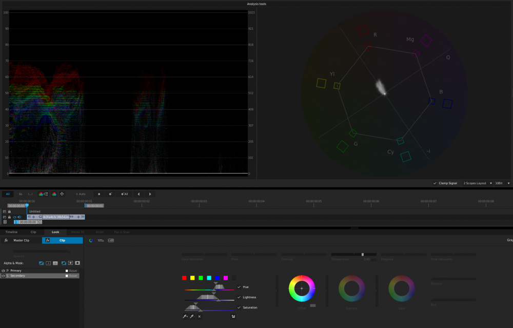

Sekhar Posted October 11, 2015 Share Posted October 11, 2015 This is way too blue. If you have people in the shot, one common way to grade is to isolate the skin and grade it so they line up along the "skin line" in the vector scope. The interesting fact about skin color is that it always lines up that way regardless of the race, so this procedure always works except for extreme black and white.E.g., here's a simple grade of your original (ungraded) shot adjust just for colors. It may not be what you want, but at least it's adjusted more or less for the skin. Grade.tga Xavier Plagaro Mussard 1 Link to comment Share on other sites More sharing options...

Sekhar Posted October 11, 2015 Share Posted October 11, 2015 It's SpeedGrade.As I said, this is a correction for the skin only, and the grade to correct skin may not work for the rest of the scene depending on what kind of look you want. But once you correct for skin, you can always correct the other stuff like the sky (assuming it's not blown out like here), foliage, etc. to whatever you want.The key point I wanted to make was that if you have people in the scene, you generally start by correcting the skins because viewers are much more offended by bad skin color than say bad foliage shades. Link to comment Share on other sites More sharing options...
