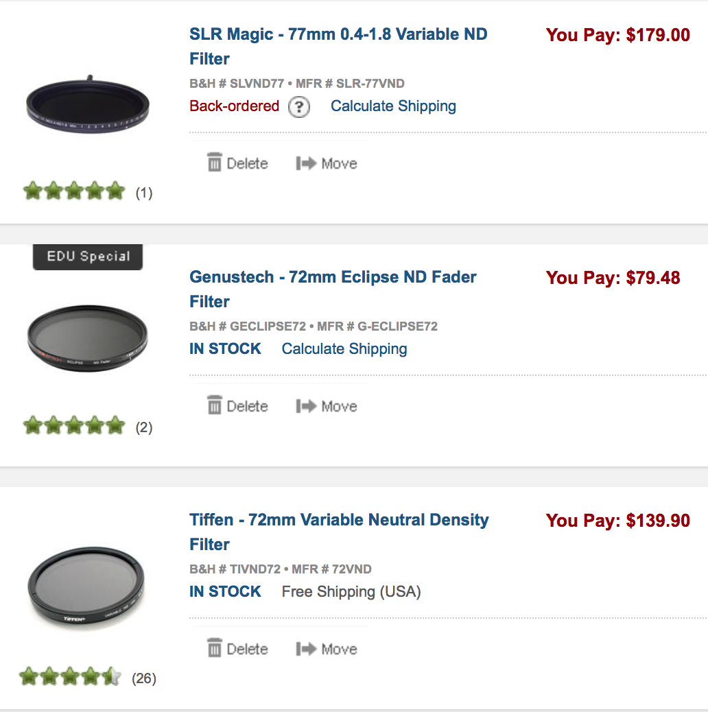

Turboguard Posted October 15, 2015 Share Posted October 15, 2015 So earlier this summer I got an IR/UV cut for my BMPCC and I've been loving it, but after some shoots the past months I keep seeing this extremely annoying red tint to all my footage which is almost impossible to get rid off unless I desaturate the red/magenta channels. I hate it! BUT, it's only visible in the shots where I've had my tiffen variable ND on. Is that really the cause? I've stacked the ND on top of the cut filter, if that makes any difference, not so techy. I also saw that there's variable ND's WITH ir cut. Do I need to get a new ND?I did find the thread earlier discussing this but there wasn't really any talk about still getting such extreme pollution. Again, should I just invest in a Genus eclipse or SLR Magic? I'm sooooo tired of this haha Edit: So this is the Tiffen I own, and here's the two others. Genustech is CHEAPER, so I could prob hand off my Tiffen for 100 bucks and get it plus make some cash. You guys with personal experience of these, please let me know. Link to comment Share on other sites More sharing options...
