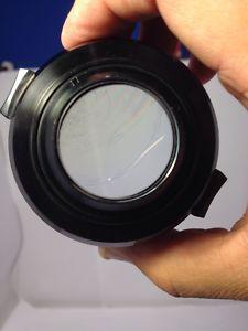

redimp Posted October 25, 2015 Share Posted October 25, 2015 After a bunch of emails back and forth with a seller I bought this Iscorama.He told me that the anamorphic part is in perfect condition, but the lens block is cracked.After I won the auction it turned out that it actually IS an anamorphic block that has a crack on one of the internal lens.So the question is – what do I do now? The crack seems pretty small but I am sure it will affect image clarity. Fixing it also does not seem realistic, but maybe there's something I don't know?I'd appreciate any advice. Link to comment Share on other sites More sharing options...
richg101 Posted October 25, 2015 Share Posted October 25, 2015 from the pictures it looks like one of the main elements has sheered or cracked due to the cement breaking down at different rates at different areas of the glass surfaces., meaning the thinner central portion has been put under stress and has given way. it might have taken a knock to start the process. If I'm right you've definitely bid a crazy figure for something that wont ever be repairable unless you find another damaged iscorama for cheap. to give you an idea, I was gonna bid on the lens and my top bid would have been $400, simply to have replacement front and rear elements for when another iscorama comes in for repair.a possible, and only a possible... it's likely that it may actually not be cracked at all, and instead the separation simply looks like a crack. If it does turn out to be just the cement then I've recently started offering iscorama recementing services - I;ve done one so far and it went well. However the work involved is dangerous, and it comes with a risk. that on top of the fact that it could be the flint element that's sheered and if so will be irrepairable is definitely something to consider before you pay the seller!. Link to comment Share on other sites More sharing options...
Julian Posted October 25, 2015 Share Posted October 25, 2015 It's hard to tell from the pictures. Either the seller can't take proper pictures or he's trying to hide how bad it is. He's pretty honest about it in the description though, selling it as 'broken / use for parts'... I'm curious if it still works - if all the elements are moving it might still give an ok picture. Getting it repaired sounds not very likely or will cost a fortune. But you can minimize your loss by selling it to rich for $400... Link to comment Share on other sites More sharing options...

redimp Posted October 25, 2015 Author Share Posted October 25, 2015 On 10/25/2015 at 8:14 PM, roccoforte said: I was watching this. I thought the photos of the broken parts were very poor which made me suspicious.It all sounds kinda werid now. The day the item was posted I asked which lens had a crack – anamorphic or taking lens, and the seller told me it was the taking one. I asked again if the anamorphic block was in a perfect working condition and the answer was yes.Now the seller is telling me that what he meant was that it was in perfect condition "mechanically". So I did the only logical thing to check what is the actual state of things, considering what Rich posted, maybe that is just a separation of elements. I received the attached images as a reply. I am not sure if ebay is shrinking images down this bad or if it's intentional.I am considering asking for a cancellation since it is probably not what I was bidding on. I was told the anamorphic part was pristine and I expected higher bids on this lens. In fact my maximum bid was higher too. On 10/25/2015 at 5:36 PM, richg101 said: from the pictures it looks like one of the main elements has sheered or cracked due to the cement breaking down at different rates at different areas of the glass surfaces., meaning the thinner central portion has been put under stress and has given way. it might have taken a knock to start the process. If I'm right you've definitely bid a crazy figure for something that wont ever be repairable unless you find another damaged iscorama for cheap. to give you an idea, I was gonna bid on the lens and my top bid would have been $400, simply to have replacement front and rear elements for when another iscorama comes in for repair.a possible, and only a possible... it's likely that it may actually not be cracked at all, and instead the separation simply looks like a crack. If it does turn out to be just the cement then I've recently started offering iscorama recementing services - I;ve done one so far and it went well. However the work involved is dangerous, and it comes with a risk. that on top of the fact that it could be the flint element that's sheered and if so will be irrepairable is definitely something to consider before you pay the seller!. Thanks for your input. I think on the last image I've just posted a long light artifact is a crack indeed. Link to comment Share on other sites More sharing options...
redimp Posted October 26, 2015 Author Share Posted October 26, 2015 Just got a full res images from the seller. It does look like a cement separation indeed. On 10/25/2015 at 5:36 PM, richg101 said: a possible, and only a possible... it's likely that it may actually not be cracked at all, and instead the separation simply looks like a crack. Rich, what do you think about this? Would you be willing to work on this? Thanks. Link to comment Share on other sites More sharing options...

redimp Posted October 26, 2015 Author Share Posted October 26, 2015 On 10/26/2015 at 8:34 PM, Russell Anway said: Good luck. Thanks. Actually that person told me that two people from this forum contacted them after I posted this thread, offering to buy the lens. He's willing to just cancel it with no negative reviews and it's up to me now. I just really can't make up my mind if it's worth buying and basically waiting for Rich to chime in if it's worth repairing. Link to comment Share on other sites More sharing options...
dahlfors Posted October 26, 2015 Share Posted October 26, 2015 Rich will know better - but by the looks of those photos I'd personally back away. I don't see how that rear element could get fixed without replacement. That's a nasty crack in the glass. Link to comment Share on other sites More sharing options...

Jim Chang Posted October 30, 2015 Share Posted October 30, 2015 it looks to me the lens got a hit on that corner, and one of the doublet starts separating....and at the same time, a part of the glass got shuttered. You have to replace the doublet...which is the most expensive piece in this front anamorphic unit, I am sure they are using the achromatic ones...with that OD, you are talking about pretty significant $$$...without considering the man power spent on repair.Good luck... Link to comment Share on other sites More sharing options...
