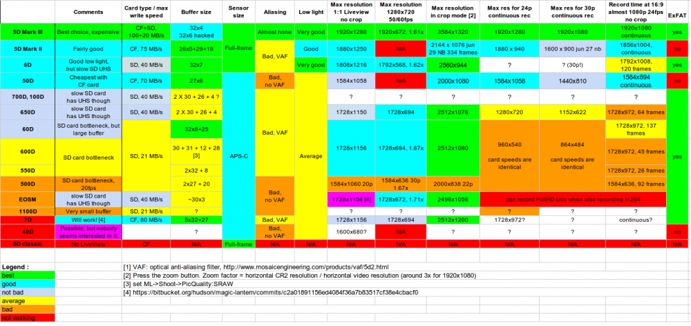

BrorSvensson Posted October 27, 2015 Share Posted October 27, 2015 So yesterday i stumbled apoun this product on ebay ( http://www.ebay.com/itm/new-Nikon-F-G-focal-reducer-speed-booster-adapter-to-Canon-EOS-M-EOSM-M2-M3-/361376870358?hash=item5423bd6fd6:g:u84AAOSwHnFV4muu ), its a Eos m to nikon g focal reducer. I knew that the Eos M have some magic lantern raw capabilities and after further research i found out that it can shoot at a resolution of 720 x 1280. A eos M can commonly be found for about 150$ (http://www.ebay.com/itm/Canon-EOS-M-Body-Gehause-black-schwarz-TOP-wie-neu-OVP-/151853015439?hash=item235b25218f:g:vYQAAOSw~bFWI-fz).If anyone has tried a common combo i would be interested in knowing more. tupp 1 Quote Link to comment Share on other sites More sharing options...

TheRenaissanceMan Posted October 27, 2015 Share Posted October 27, 2015 It can do 720p or so from the whole sensor, but it produces pretty bad moire. You could also go the Tragic Lantern route and just get a jacked up bit rate for h.264. If you're a stills guy, pair it with the 22mm and you've got the best, cheapest 35mm compact on the market. tupp 1 Quote Link to comment Share on other sites More sharing options...
maxotics Posted October 27, 2015 Share Posted October 27, 2015 Yes, like TheRenaissanceMan says, you can do 1280 native focal length, but get moire. However, if you have shallow depth of field and are not shooting anything with hard edges you'll get that rich color look. The biggest problem are the focus pixels. You need to remove them or they create "pink dots". I wrote software for windows that does it well (but only in crop mode) https://bitbucket.org/maxotics/focuspixelfixer/downloads For other resolutions, you want the PinkDotRemover. The best combo, IMHO, is a 10-20mm type lens, then shoot crop mode, which will make it 40 to 80. Also, you'll need a 95MBS read/write card (even though it will max out at 40mbs). Here's a cool video I did using the EOS-M to show you what your sensor really sees in Bayer mode: https://vimeo.com/79857693 And here's one that show the basic quality, it's VERY filmmlike to me. Here's one with the kit-lens https://vimeo.com/76181035 And this one with a Sigma 10-20. Finally, here's a good one in H.264 with the EOS-M. I LOVED that camera. https://vimeo.com/75122636 I now have a BMPCC. But I LEARNED so much using the 50D (another great ML camera) and the EOS-M. tupp 1 Quote Link to comment Share on other sites More sharing options...

tupp Posted October 28, 2015 Share Posted October 28, 2015 So yesterday i stumbled apoun this product on ebay ( http://www.ebay.com/itm/new-Nikon-F-G-focal-reducer-speed-booster-adapter-to-Canon-EOS-M-EOSM-M2-M3-/361376870358?hash=item5423bd6fd6:g:u84AAOSwHnFV4muu ), its a Eos m to nikon g focal reducer.[snip]If anyone has tried a common combo i would be interested in knowing more.I've got the EOSM and this RJ focal reducer. Essentially, it makes the EOSM a full-frame camera and gives an extra stop of brightness. It goes a little soft (with a slight chromatic aberration) on the edges, but most don't notice it unless they are looking for it. When I received the RJ adaptor, the back mount (EF-M) was loose/wobbly and could not be tightened. Basically, the mount screws were too long and/or the threads were not tapped deep enough into the body of the adaptor. RJ was diligent in corresponding on the problem, and RJ sent shorter screws which eliminated looseness/wobble. The RJ adaptor mostly stays mounted to the EOSM, as all my lenses except one are old Nikkors and as it prohibits dust from getting to the sensor. Sometimes the RJ gets replaced with an tilt-swing adaptor ( EF-M-to-Nikkor-F), which is a lot of fun. Almost never used are my EF-M-to-Nikkor-F dummy adaptor and my EF-M-to-EF adaptor. On the RJ adapter, I am considering using tape to fix the "G" aperture adjustment ring to the smallest position, as I don't have any "G" lenses and as you can inadvertently bump it so that it keeps the aperture on "F" lenses from closing without your realizing it. By the way, the EOS M2 can currently be had new for almost the same low price to which the original EOSM sunk, but ML is just now starting to explore the M2. IronFilm 1 Quote Link to comment Share on other sites More sharing options...

tupp Posted October 28, 2015 Share Posted October 28, 2015 With just the 3x crop on, the camera is insanely better than the original canon specs, so I was wondering what the image would look like with the Nikon focal reducer shot in 3x crop... Would it bring it back to apsc sized without the aliasing?Never tried the 3x crop on the EOSM (nor on the T3i), but I can't imagine that a pixel peeper would be happy using the RJ focal reducer in crop mode. Lenses only have a finite number of resolving lines within their image circles. The more one crops into the image circle, the more one reduces the number of resolving lines in the frame. Focal reducers squeeze more of a lens' resolving lines into the frame, but at the same time the focal reducer causes a slight loss of sharpness by introducing another piece of glass into the optical chain. If the focal reducer is high quality, this tradeoff is optically "equitable" and no loss of sharpness is noticed between the images with and without the focal reducer. I don't know if the RJ focal reducer will hold up to such a crop, but if you like the look of the Cosmicar 12.5mm-75mm in 3x crop (I love it), it might be okay. Also, the RJ wouldn't bring the 3x crop close to APS-C size. The RJ focal reducer crop factor is 0.72x, and the crop factor of the EOSM's crop mode is 3x:0.72 x 3 = 2.16 So, the effective size of the frame in 3x crop mode with the RJ focal reducer would be 2.16 times smaller than (or slightly less than 1/2 the size of) an APS-C sensor. mercer 1 Quote Link to comment Share on other sites More sharing options...
