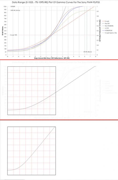

Next I Googled for the biggest pictures I could find for S-log and V-log. I opened them in Photoshop and traced the curves. In a separate layer I created a square divided in 8 rows and columns, just like the background of my master curve looks like. Next selected the ‘traced curve’ and with the transformation tool forced the x-dimension inside the square. Flattened the image, imported it in my NLE and with three points recreated the curve in the master curve window. Bingo! Saved the the curve to an .acv format for later use.
tracing_S-log3.thumb.jpg.acf609d2fd16568
….And that is al there is to de-logging a 1D-LUT or spline.  It’s easy to create, something you can do yourself.

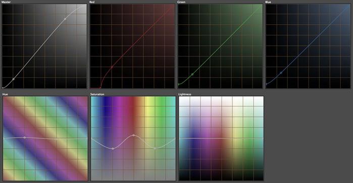

Next an Adjustment layer is added to the timeline. ColorFinesse is applied to the Adjustment Layer and under HSL  Saturation under Shadow and Midtones is set from 100 to 133,33, Highlights left for what it is. My guess is that when 33,33 % saturation is added to each channel, you would get full Saturation. But that is just a guess.
You now have a ‘basic color corrected de-logged file’. To grade further let you imaginations go wild…
In the linked mov with Andrews footage I adjusted the curves like so. By banding the red curve downward you add a slight red cast to the footage as the curve to the top is no longer straight. Doing the opposite with green curve amplifies it. Blue curve is kept as straight as possible while adding blue to the shadows. HSL curves speak for themselves. Alas the girls skin still falls apart, so there must be something wrong with the footage ;)
