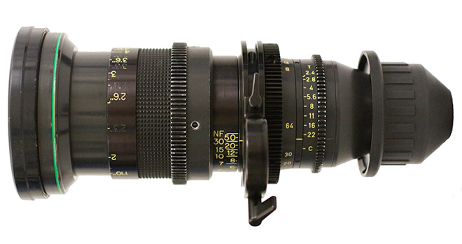

Administrators Andrew Reid Posted January 11, 2013 Administrators Share Posted January 11, 2013 Usually most Super 16mm cinema glass won't cover the larger sensor in the Blackmagic Cinema Camera. The sensor is closer in size to the Panasonic GH3. However Shane Hurlbut has had a rather useful discovery, in shooting with the Canon 8-64mm F2.4 on the BMCC he found it covers the sensor just fine without vignetting. Canon 8-64mm F2.4 PL / Arri on eBay US Sean Cunningham 1 Link to comment Share on other sites More sharing options...

tristan Posted January 11, 2013 Share Posted January 11, 2013 It looks like Shane just replied to @Kholi and says the lens vignettes to about a 12mm, just FYI. https://twitter.com/hurlbutvisuals/status/289863888579747843 Link to comment Share on other sites More sharing options...

Administrators Andrew Reid Posted January 12, 2013 Author Administrators Share Posted January 12, 2013 It looks like Shane just replied to @Kholi and says the lens vignettes to about a 12mm, just FYI. https://twitter.com/hurlbutvisuals/status/289863888579747843 How is that 'perfectly' covers. Bloody hell. Link to comment Share on other sites More sharing options...
Bruno Posted January 12, 2013 Share Posted January 12, 2013 Many 16mm lenses would lose about 2mm focal length on the wide side when converted to Super 16mm. The Zeiss 10-100mm for instance, originally made for 16mm, became a 12-120mm when modded for Super 16mm. Maybe something similar can be made to go from super16 to the BMCC sensor size, allowing good 16mm cine lenses to be used with the BMCC. Link to comment Share on other sites More sharing options...
