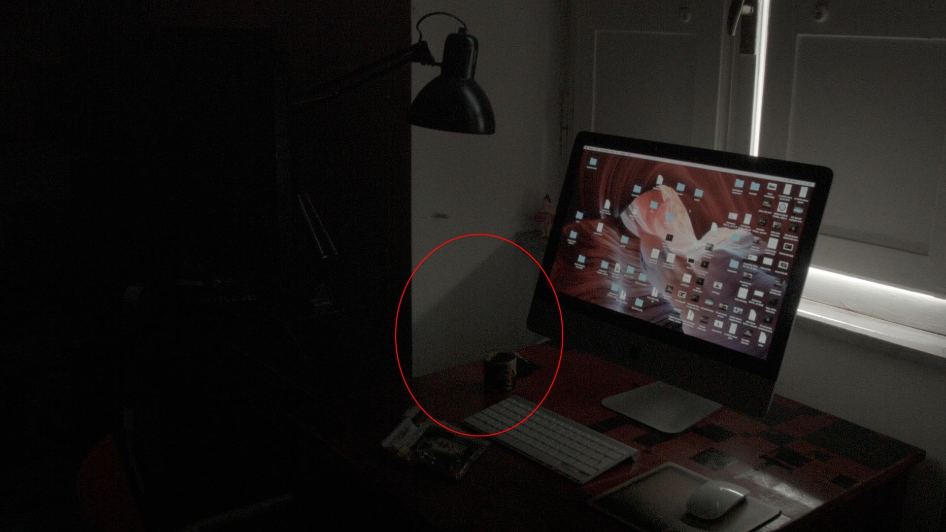

giostrante Posted April 7, 2016 Share Posted April 7, 2016 Right now is clearly visible in dark enviroments with contrasted zone at iso 1600,is still there at 800 but less pronounced, in different conditions is extremely difficoult to find, fortunately. But it's not acceptable anyway. Here's a little test of the problem,but in still images is less visible than in motion. Link to comment Share on other sites More sharing options...

Bioskop.Inc Posted April 7, 2016 Share Posted April 7, 2016 5 minutes ago, giostrante said: Right now is clearly visible in dark enviroments with contrasted zone at iso 1600,is still there at 800 but less pronounced, in different conditions is extremely difficoult to find, fortunately. But it's not acceptable anyway. Here's a little test of the problem,but in still images is less visible than in motion. That's not a normal shooting situation & you really shouldn't expect to be getting anything worth while by doing that. Sorry, but there's nothing wrong with your camera. You're being totally unrealistic about what you can achieve. Now do the same test again with just that lamp on or even a big candle - that would be a minimum of light, not a few leaks coming from the cracks of the shutters. Link to comment Share on other sites More sharing options...
cantsin Posted April 7, 2016 Share Posted April 7, 2016 @giostrante, your picture is severely underexposed. You need to learn that you need to expose a Blackmagic camera differently than a conventional DSLR or video camera, i.e. according to the ETTR/expose to the right principle. (You expose to the possible maximum/just under the clipping point even if it looks like overexposure on the camera display, and pull back your exposure/gamma in post.) Link to comment Share on other sites More sharing options...
JazzBox Posted April 7, 2016 Share Posted April 7, 2016 29 minutes ago, giostrante said: Right now is clearly visible in dark enviroments with contrasted zone at iso 1600,is still there at 800 but less pronounced, in different conditions is extremely difficoult to find, fortunately. But it's not acceptable anyway. Here's a little test of the problem,but in still images is less visible than in motion. That's perfectly acceptable for my taste: with my GH4 I have other issues but they all are things normal (as today) for a digital camera. This is a very dark shot and it is not very "cinematic" per se: this problem would be unacceptable if it destroy a well exposed (or slightly underexposed) image, but you would not underexpose so hardly normally. Each camera has pro and cons, I do love my GH4, and I hope the Micro that will arrive today will be as good as the Pocket I had, just with 60 fps and a better batteries' life my 2 cents Xavier Plagaro Mussard 1 Link to comment Share on other sites More sharing options...
giostrante Posted April 7, 2016 Share Posted April 7, 2016 31 minutes ago, squig said: If you can't handle a bit of fixed pattern noise, maybe digital filmmaking is not for you. It's more than a bit I'm afraid Link to comment Share on other sites More sharing options...

giostrante Posted April 7, 2016 Share Posted April 7, 2016 33 minutes ago, Bioskop.Inc said: That's not a normal shooting situation & you really shouldn't expect to be getting anything worth while by doing that. Sorry, but there's nothing wrong with your camera. You're being totally unrealistic about what you can achieve. Now do the same test again with just that lamp on or even a big candle - that would be a minimum of light, not a few leaks coming from the cracks of the shutters. 19 minutes ago, cantsin said: @giostrante, your picture is severely underexposed. You need to learn that you need to expose a Blackmagic camera differently than a conventional DSLR or video camera, i.e. according to the ETTR/expose to the right principle. (You expose to the possible maximum/just under the clipping point even if it looks like overexposure on the camera display, and pull back your exposure/gamma in post.) Relax guys, I know what I've done, it's just a stress test,I didn't want to awake the professor inside all of you, keep calm! And as I said, even with more light is clearly visible at iso 1600 and even at 800 when you look at the footage of course, here is just a still image. Link to comment Share on other sites More sharing options...
