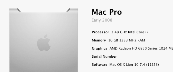

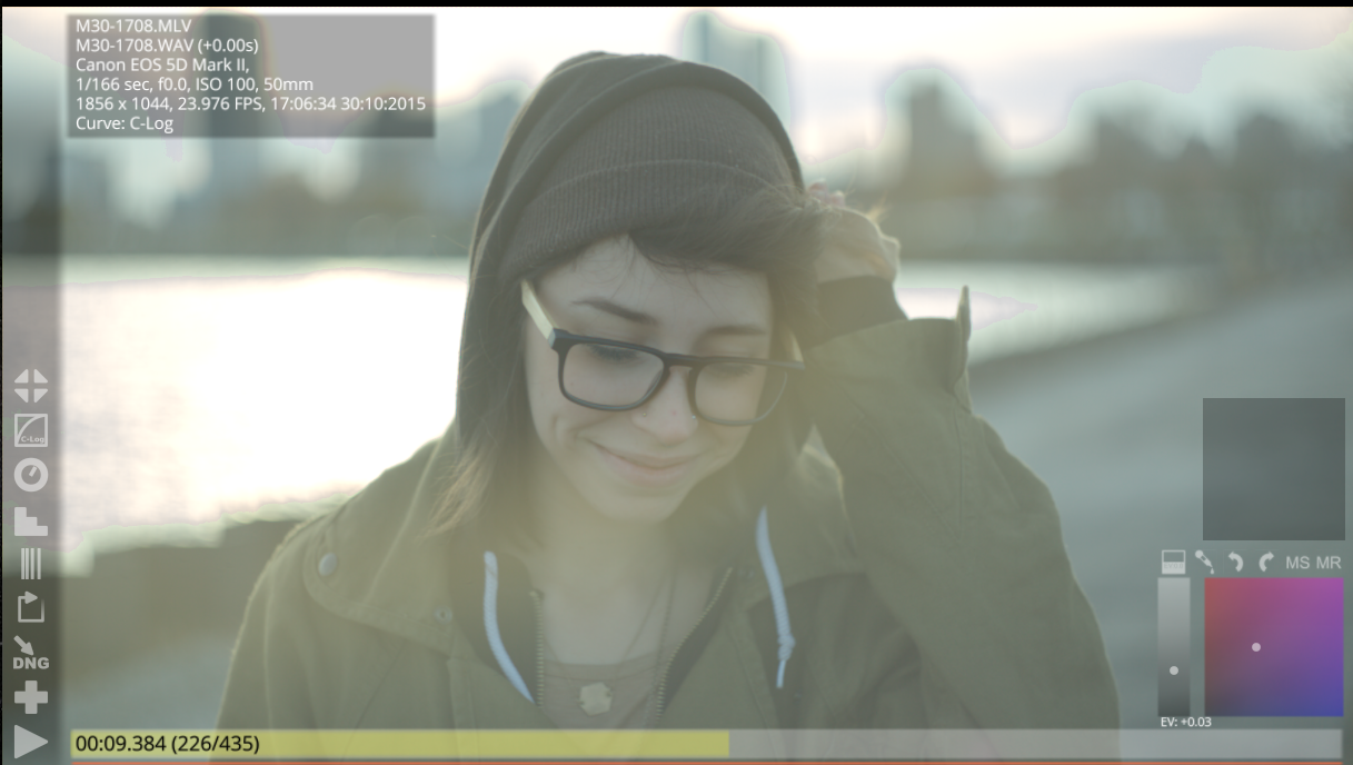

thlbeal Posted November 10, 2015 Author Share Posted November 10, 2015 Much Resolve love! I might have to give it a try. The thing is, I have a hackintosh that I can't update past 10.7.4 (I'm scared to touch the thing, because if I mess something up I most likely won't be able to fix it). Can I use an older version of Resolve that will work with the specs below? Maybe Resolve 9, will that be good enough?Also, I originally planned on exporting to ProRes, but when I use MlRaw Viewer I get these nasty highlights that I don't get when using crd2hdr. Am I doing something wrong? Thanks again guys! +1 for using Resolve!There is also this program called MLVFS which "virtually" encodes your MLV files into cDNG.This way you don't even need to convert the MLV files and can thus save some harddisk space.Here is a how to: https://www.youtube.com/watch?v=xr2pT5mrn8Q I looked into this! I can install it fine, but unfortunately it won't run? I think it's because of that fact that at I'm on 10.7.4 Link to comment Share on other sites More sharing options...
