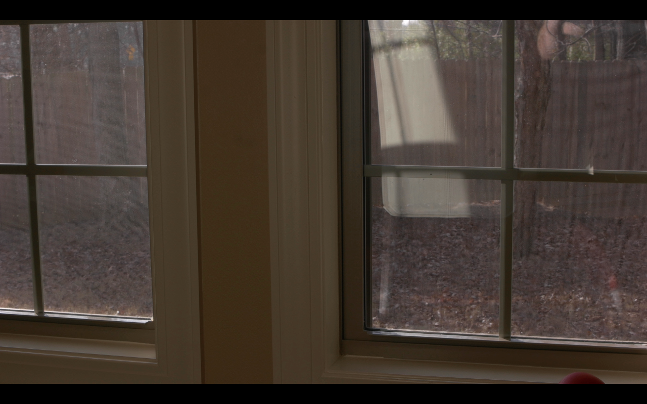

KarimNassar Posted January 13, 2016 Share Posted January 13, 2016 Here's what I did:1. Plug the NX1 into the VA and set output to 1080p2. Hit the d-pad right once to get to video preview3. Hit the d-pad up four times to clear the overlays from the monitor. Give it a shot! Would you mind shooting a white wall next to a window, with the wall being slightly underexposed?Once internal and once with the blackmagic video assist.Just to see if the external recorder format makes a difference with banding or macroblocking. I assume it won't but would be interesting to compare in premiere. Link to comment Share on other sites More sharing options...

Raney Rogers Posted January 17, 2016 Share Posted January 17, 2016 Would you mind shooting a white wall next to a window, with the wall being slightly underexposed?Once internal and once with the blackmagic video assist.Just to see if the external recorder format makes a difference with banding or macroblocking. I assume it won't but would be interesting to compare in premiere.We don't have any white walls at home, but I think you can see what you are asking in the trim. The first is the NX1 shot in UHD transcoded to 422, the second is the VA recorded in 422. If you're looking for the blocks in the shadow areas, I've seen alot less with the VA so far. KarimNassar 1 Link to comment Share on other sites More sharing options...
Lintelfilm Posted January 17, 2016 Share Posted January 17, 2016 Difference in focus makes it hard to draw any conclusions. Artefacts in the shadows (inside house) look much less in lower image but that could be the soft focus? Link to comment Share on other sites More sharing options...
KarimNassar Posted January 17, 2016 Share Posted January 17, 2016 We don't have any white walls at home, but I think you can see what you are asking in the trim. The first is the NX1 shot in UHD transcoded to 422, the second is the VA recorded in 422. If you're looking for the blocks in the shadow areas, I've seen alot less with the VA so far. thanks for taking the time to do this, much appreciated. And what a difference in the example you posted! very cool. If you have the time to post some more I would be very interested. I'm seriously considering the VA even strictly for monitoring and the added cleaner 1080p out of the nx1 is quite an interesting plus.I asked for a white wall next to a window because it would have been easy to spot differences in banding in the light gradient. I would assume there would be none, since the nx1 output is 8bit, but you never know. However your test does seem to demonstrate that the VA internal compression is significantly better than the one of the NX1 regarding macro blocking. It is easy to test as well, anything you record in the shadows with no detail and flat colors should introduce some. Link to comment Share on other sites More sharing options...
Raney Rogers Posted January 17, 2016 Share Posted January 17, 2016 Difference in focus makes it hard to draw any conclusions. Artefacts in the shadows (inside house) look much less in lower image but that could be the soft focus?I recorded simultaneously so it's the same focus, but I was shooting on an old Canon FD lens, so the image does end up kinda soft.thanks for taking the time to do this, much appreciated. And what a difference in the example you posted! very cool. If you have the time to post some more I would be very interested. I'm seriously considering the VA even strictly for monitoring and the added cleaner 1080p out of the nx1 is quite an interesting plus.I asked for a white wall next to a window because it would have been easy to spot differences in banding in the light gradient. I would assume there would be none, since the nx1 output is 8bit, but you never know. However your test does seem to demonstrate that the VA internal compression is significantly better than the one of the NX1 regarding macro blocking. It is easy to test as well, anything you record in the shadows with no detail and flat colors should introduce some. No problem! I see what you mean with the banding, when I get the chance I'll post more tests here. Link to comment Share on other sites More sharing options...
Lintelfilm Posted January 17, 2016 Share Posted January 17, 2016 I recorded simultaneously so it's the same focus, but I was shooting on an old Canon FD lens, so the image does end up kinda soft.So the moire in the net curtains is completely eradicated by the VA (or caused by the UHD transcoding)? iamoui 1 Link to comment Share on other sites More sharing options...
hmcindie Posted January 17, 2016 Share Posted January 17, 2016 So the moire in the net curtains is completely eradicated by the VA (or caused by the UHD transcoding)?Looks like a scaling artifact. Either image is not even HD. Link to comment Share on other sites More sharing options...
Raney Rogers Posted January 17, 2016 Share Posted January 17, 2016 So the moire in the net curtains is completely eradicated by the VA (or caused by the UHD transcoding)?The moire in camera on the NX1 is not as bad as it looks there, but there is definitely less in the VA. But hmcindie is right, it's really hard to tell from those pictures since they are cruddy stills. If you want me to test something, let me know, it will help me learn the camera! Lintelfilm 1 Link to comment Share on other sites More sharing options...
KarimNassar Posted January 18, 2016 Share Posted January 18, 2016 If you want me to test something, let me know, it will help me learn the camera!if you could upload any short clips (5sec is enough) of a high contrast scene with shadow areas and some light fall off on wall, internal + BMVA so we could check the difference in macroblocking and banding in premiere would be awesome. Link to comment Share on other sites More sharing options...
Raney Rogers Posted January 19, 2016 Share Posted January 19, 2016 Here's a test clip: NX1 UHD converted to 422 vs the VA recording in 422 (not converted). The video here is 1080p h.264, so it might be kinda hard to tell the difference, but it looks like the NX1 had less banding. If you can't tell what you needed from the clip, I can upload full-sized stills from each device. LIghting test.mov KarimNassar and Lintelfilm 2 Link to comment Share on other sites More sharing options...
KarimNassar Posted January 19, 2016 Share Posted January 19, 2016 Here's a test clip: NX1 UHD converted to 422 vs the VA recording in 422 (not converted). The video here is 1080p h.264, so it might be kinda hard to tell the difference, but it looks like the NX1 had less banding. If you can't tell what you needed from the clip, I can upload full-sized stills from each device.LIghting test.movthanks for taking the time to do this and upload. could you have possibly mislabeled the video sections?because the bottom one looks cleaner in the shadows to me and is labeled nx1 Lintelfilm 1 Link to comment Share on other sites More sharing options...
