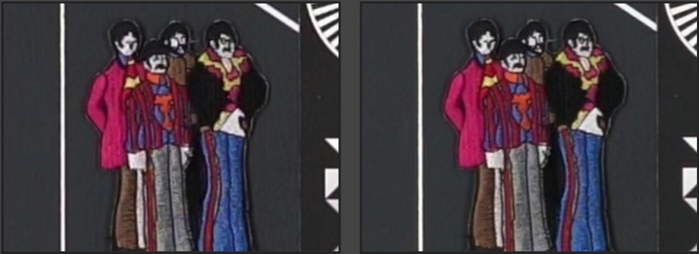

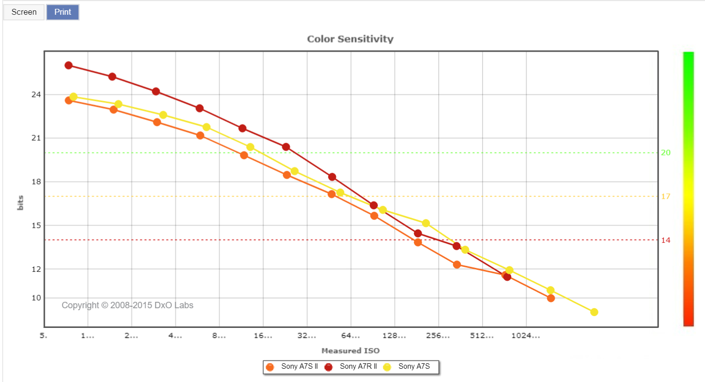

Don Kotlos Posted December 21, 2015 Share Posted December 21, 2015 Since I have only used the A7rii, my biased opinion is that the a7rII is NOT just a S35 camera. Unless you can spot the differences between FF and S35 mode here:If you shoot landscapes or buildings with critical focus you will see more aliasing and less detail in FF mode. But in my experience for most shoots with people at low ISOs there is really no difference in quality. I will also mention here that you can shoot m4/3 and S16 lenses at 4K with A7rii, or use that for fast zoom. So you can have one 35mm lens that gives you all 35-100 range with amazing 1080p final result. An important distinction is the rolling shutter which is much better in A7rii FF mode and it becomes really useful with moving subjects that CANNOT be fixed in post. If you want FF look with the advantage of resolution and low noise pick up a speed booster that also gives a bit more light making the distance between A7sii and A7rii even smaller. Here is a take on both cameras: https://youtu.be/T2Y_QdGwjac?t=378There is an interesting point at 6:20 about color sensitivity at high ISOs. I believe it is related to what DXOmark found here in stills mode:So colors if anything should look better. Finally the A7rii has amazing AF in video. Now the A7sii is great if you shoot in extreme low light or you use the sgammut3.cine. For example a shoot under the moonlight would be hard to do with A7rii:Again this is my personal opinion. Link to comment Share on other sites More sharing options...

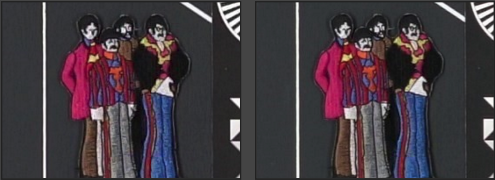

richg101 Posted December 21, 2015 Share Posted December 21, 2015 I think I have a different point of view.The A7R II is really a Super 35mm camera.The A7S II is really full frame.The 4K in full frame on the A7R II is very poor in low light, can't even do ISO 3200 nicely and the moire & aliasing will always bite you when you least expect it.So Super 35mm vs full frame, very different look.Speed Booster Ultra is a good solution for the A7R II but I still think it looks pretty different.Looking deeply into it at the moment with some real world shooting.I agree.Speed booster on my a7rii is close to full frame but not the same. I can live with the slight drop in overall 'full frame magic' in video mode, but whenever taking stills I'd always go full frame. Would be nice if the a7rii full frame video mode was as good as the aps-c mode! https://www.dropbox.com/sh/3odfgdrxutb2rnr/AADgX5roi_ioq-2yW7A-FgHpa?dl=0one shot is full frame, the other is aps-c. the one with the more refined focus is the full frame mode. being the SB Ultra I expected the aps-c mode to outdo the full frame mode but as you can see.. Link to comment Share on other sites More sharing options...
Don Kotlos Posted December 21, 2015 Share Posted December 21, 2015 being the SB Ultra I expected the aps-c mode to outdo the full frame mode but as you can see.. But isn't that showing how small the differences are between S35 and FF? Especially with the shallow DoF that adds to the FF "look" you would be hard pressed to find any differences at all. What am I missing here Rich? Link to comment Share on other sites More sharing options...
richg101 Posted December 21, 2015 Share Posted December 21, 2015 But isn't that showing how small the differences are between S35 and FF? Especially with the shallow DoF that adds to the FF "look" you would be hard pressed to find any differences at all. What am I missing here Rich? my point of focus was the 'zenit' text on the camera body. at 100% the difference in refined sharpness is pretty drastic. assuming that was a shot of a face where the eyes needed to be tack sharp while still with the same background defocus then the full frame shot owns. It's the fact that the in focus area is twice as refined, while the amount of defocus is the same. it's also very clear how the step between the foreground and the background is a lot more crisp and abrupt meaning the objects in the foreground pop out of the frame a bit more. It is slight but the difference is there to see and is enough to warrant going a7sii if it means enough to a video shooter looking for the ultimate refinement in fov/dof control. The shot was a contax cy 50mm/1.4 at f2.8. So on full frame it was a 50mm/2.8. and with the speed booster it was a 35.5/2. I had to crop the edges of the frame on the full frame shot too (since it was still wider by quite a margin due to the sb ultra still not delivering a complete reduction of crop factor) Link to comment Share on other sites More sharing options...
