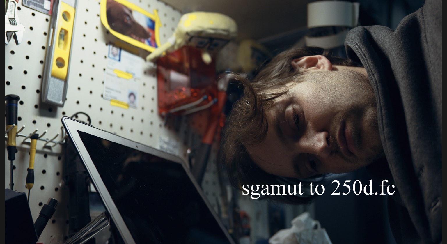

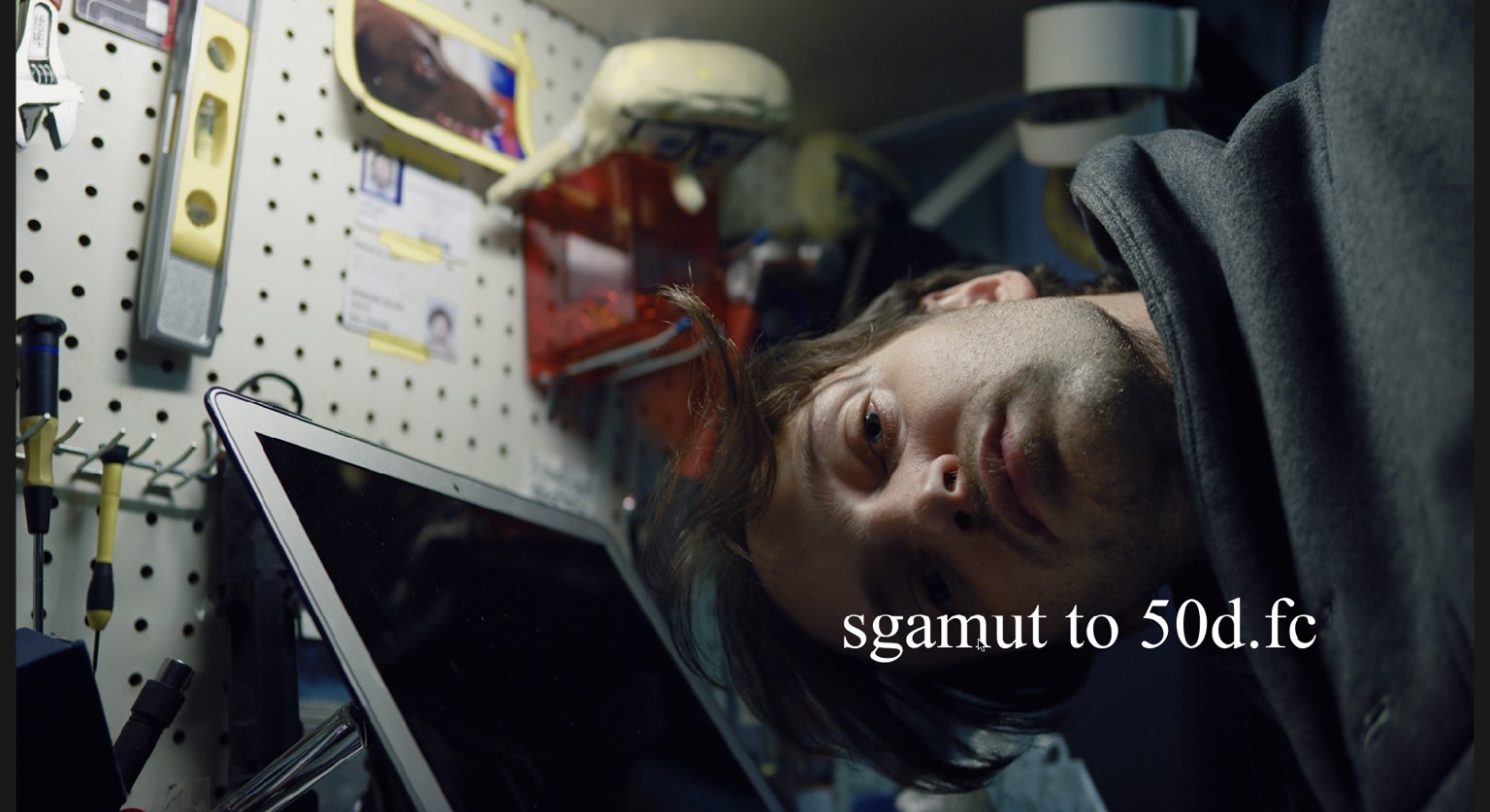

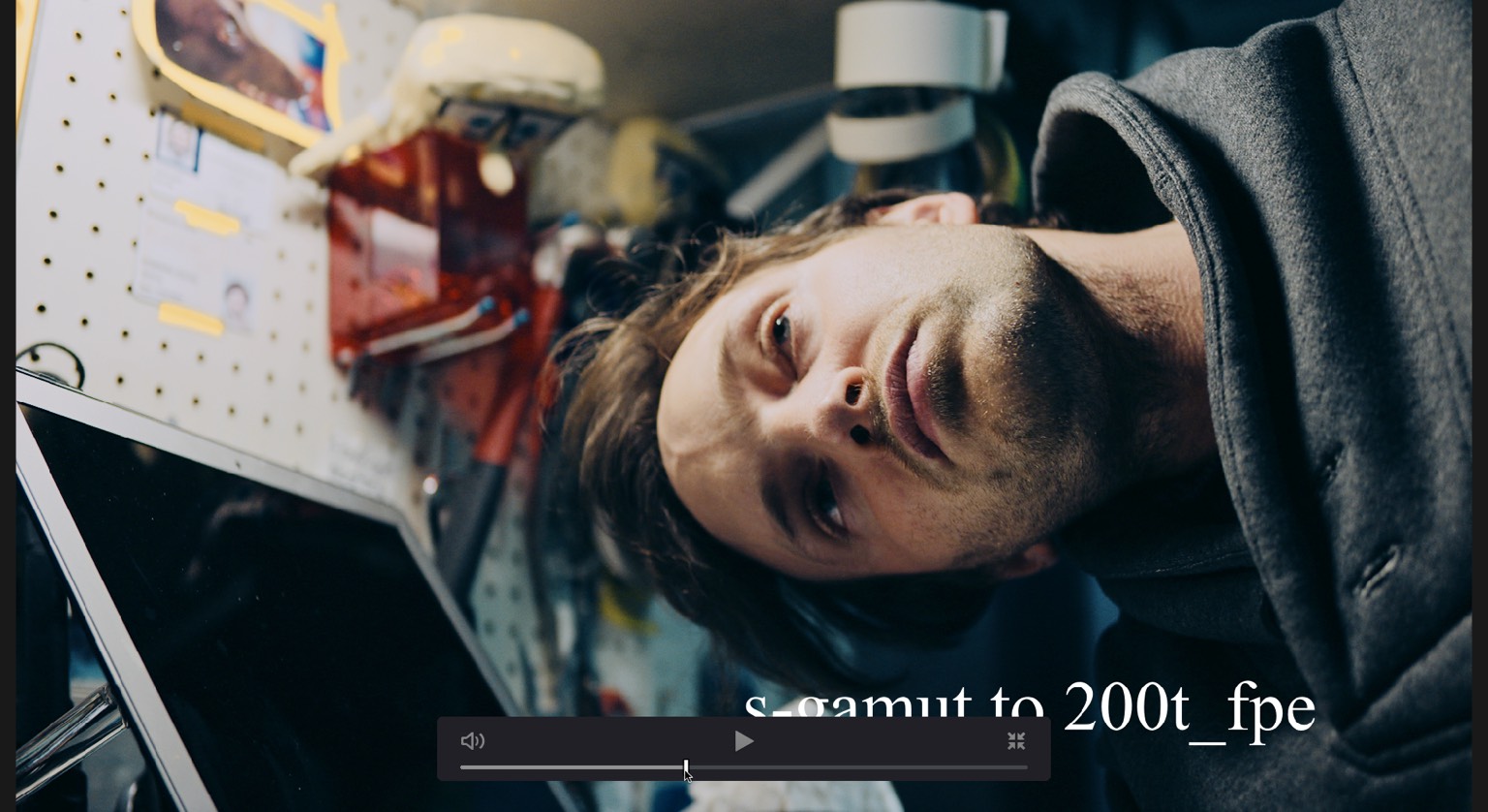

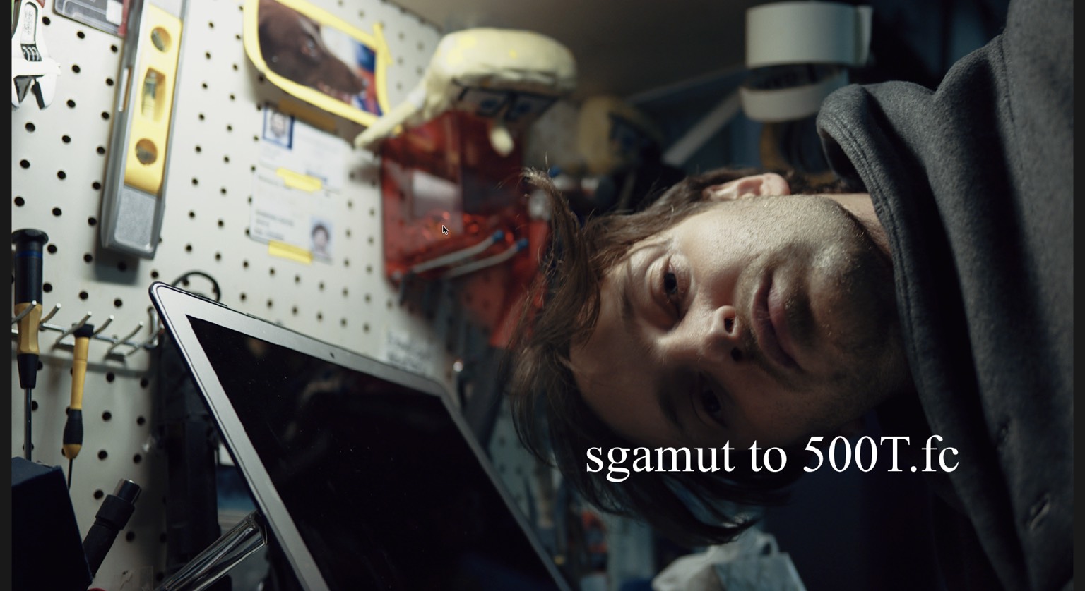

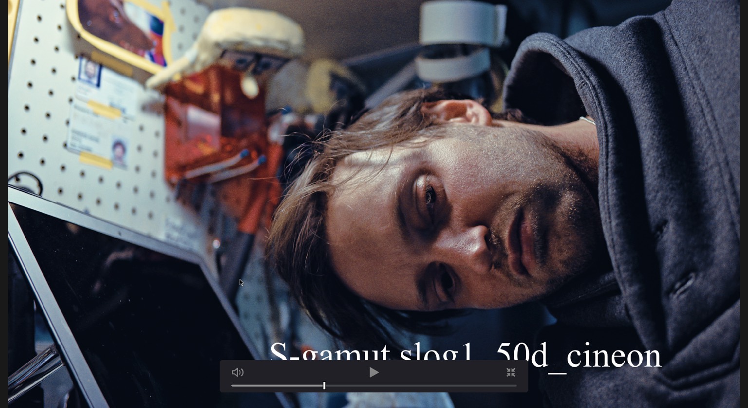

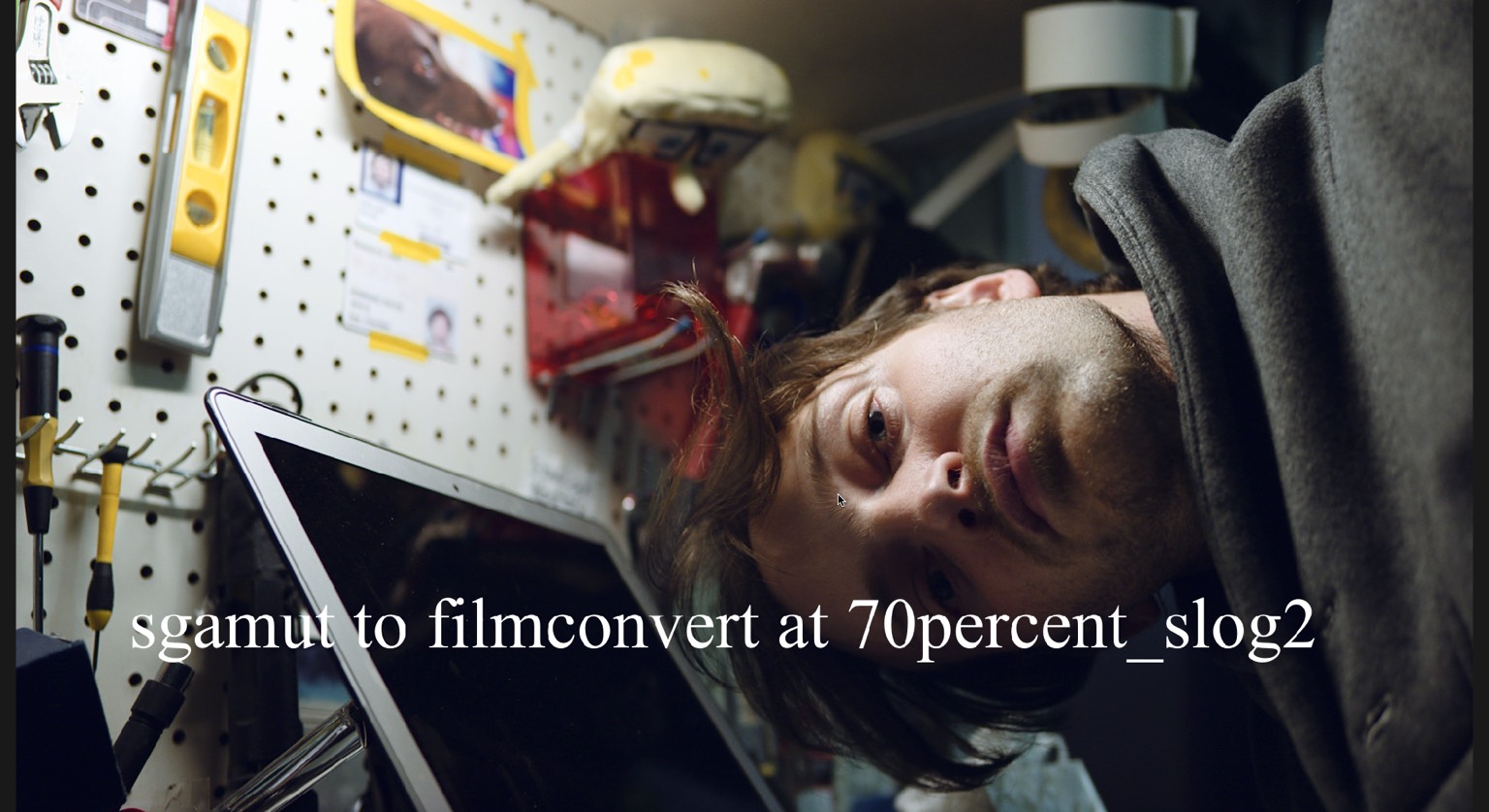

Ed_David Posted November 26, 2015 Share Posted November 26, 2015 I did a bunch of grading - checking out Impulz vs Filmconvert Overall filmconvert feels more forced, retains less detail. Impulz luts gives a better starting point - more image detail retained in ut - to play with - to shape it and move.I also just did a rec 709 conversion and graded - and it's a lot harder to work with to get to where I want to go. So if you don't like luts, good for you. For me, it gets me there faster. And then I tweak and tweak and tweak. The overall image, then skin, then lips, everything.Also now being able to shoot pro res 444 12-bit from the sony f35 to the odyssey 7q is really, really nice. Mixed lighting test - sony f35 to convergent design pro res 4444 - with overhead crappy 4000k fluorescents - shooting s-gamut then with p3-dci gamutthe lighting is all over the place - crappy overhead flourescents - 4000k mixed with more crappy flourescents and in some scenes led glow from macbookthe p3-dci definitely falls apart faster.s-gamut - with pro res 4444 - very clean secondary color correcting and stress to push pro res as far as it needs to go.shot underexposed 1 stop. amazing how clean can make - used neatvideo on impulz footage Phil A, Bioskop.Inc and benymypony 3 Quote Link to comment Share on other sites More sharing options...

Ed_David Posted November 26, 2015 Author Share Posted November 26, 2015 I love those looks - I need to play with those luts again!Just really isolate skintones and mess with them, and play with power windows, defocus edges, play with sharpness, endless endless playing around. here's some screengrabs of tests. mercer 1 Quote Link to comment Share on other sites More sharing options...

Bioskop.Inc Posted November 27, 2015 Share Posted November 27, 2015 Yep, those Impulz LUTs sure look good!However, I'm not a sharpness freak, so I take all talk of that with a huge grain of salt - just does nothing for me, a bit like 8bit 4K.Really liked VisionColor for their Canon Picture Profiles - still use them for stills, as they are just the best. So no surprise that their LUTs are amazing.I only bought FilmConvert because at the time FCPX had no way of loading in LUTs. I think the mistake most people make with FC is leaving the sliders at 100% & the grain for Web upload has to be 150% or over for it to actually show up in any meaningful way (best grain out there, as kidz has said). And Ed was a life saver recommending the ARRI profiles, as the BM ones just annoyed me no end. kidzrevil 1 Quote Link to comment Share on other sites More sharing options...

Inazuma Posted November 27, 2015 Share Posted November 27, 2015 I prefer the FilmConvert in your tests. They have more feeling to them whereas the VisionColor looks a bit more generic. Quote Link to comment Share on other sites More sharing options...
Ed_David Posted November 30, 2015 Author Share Posted November 30, 2015 Most of my sample images were to impulz luts. The FC is just a version of their lut called (film contrast). There is also a lower-contrast one call VS (visionspace) Flimconvert is I think is interesting, but I still go towards visioncolor. Mixing the two for the outdoor street test was interesting.Also redid and also did a pass going to CINEON then the release print (2383) and Fuji print - and that's very interesting too.I wish they did vintage film stocks as well - that would be pretty cool.here's the technique of the DI they used in "oh brother" where are thou Zach Goodwin 1 Quote Link to comment Share on other sites More sharing options...
