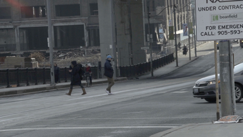

dishe Posted December 4, 2015 Share Posted December 4, 2015 The commlite adapters are great and only $99. You just need flocking paper to block the light from reflecting off the shiny plastic "tunnel" in the adapter. That's the only design flaw, likely what you are seeing now and is easily fixed.The metabones doesn't suffer from that, but really has no other advantages that I'm aware of. In fact, the cheaper commlite has been shown to be more reliable with more lenses and works more consistently (metabones users complain of lens disconnects, IS cutting out randomly, etc). I wouldn't spend the money on it personally. As far as why people prefer Canon lenses- because there are lots of them, they are of high quality, and you get to use features like IS. None of the other adapted lens types can get you that right now. So, to some, its not just the best choice, its the ONLY choice until Sony rolls out more native glass. Link to comment Share on other sites More sharing options...
