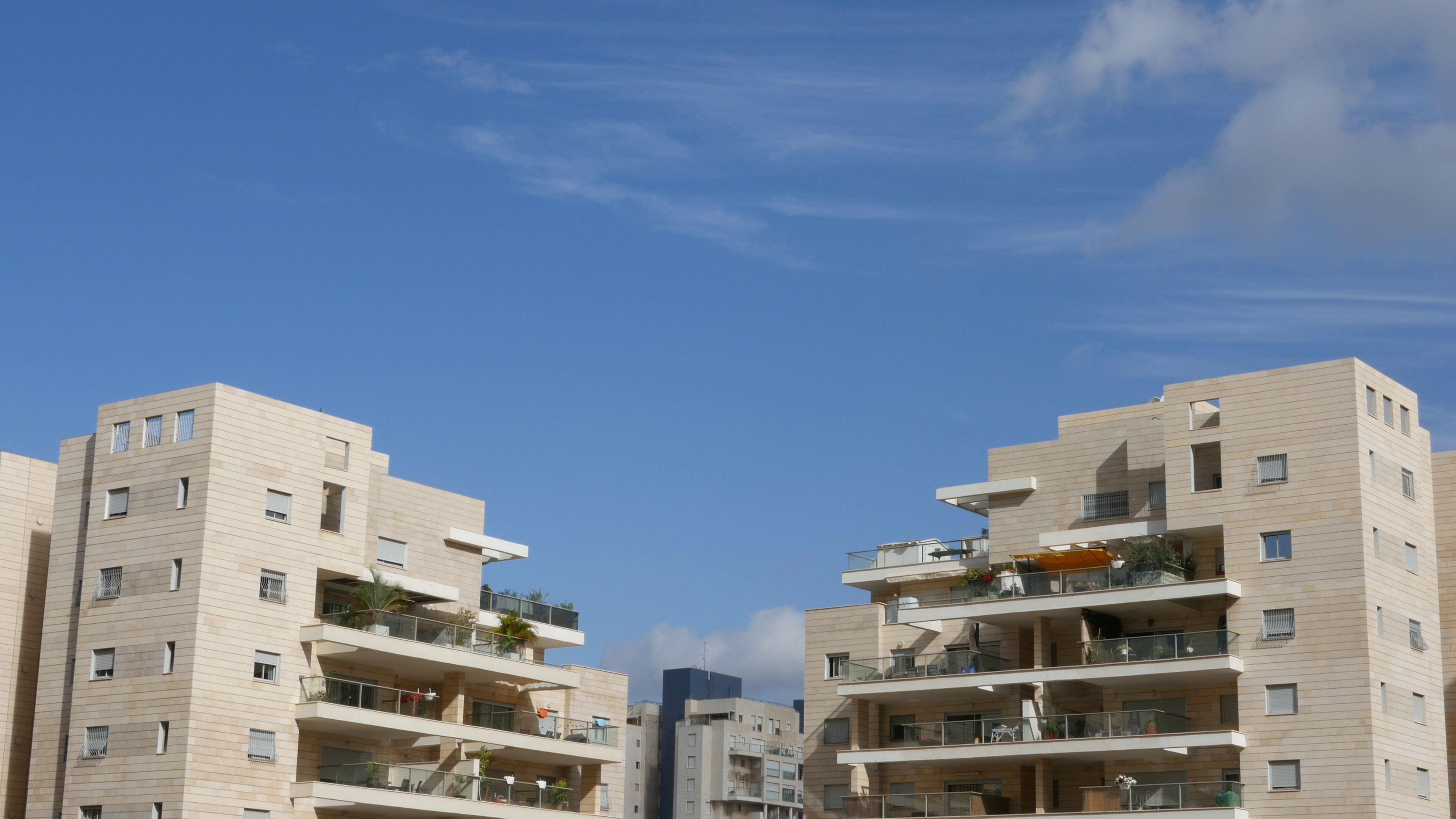

liork Posted November 30, 2015 Share Posted November 30, 2015 It happens in S-Log3 and S-Log2 as well.Funny, I dont remember it so severe in A7S. Link to comment Share on other sites More sharing options...

Guest Ebrahim Saadawi Posted November 30, 2015 Share Posted November 30, 2015 Could you show us some grabs? All 8bit cameras will band shooting a blue sky gradient, all of them, from an iphone to C300, you only have 256 blue gradients while painting a smooth blue sky transition needs a few thousand blue gradients. Actually all 10bit cameras too, just a bit less. Does it look unnatural vs normal banding?A frame grab or video would go a long way in us helping you, Link to comment Share on other sites More sharing options...

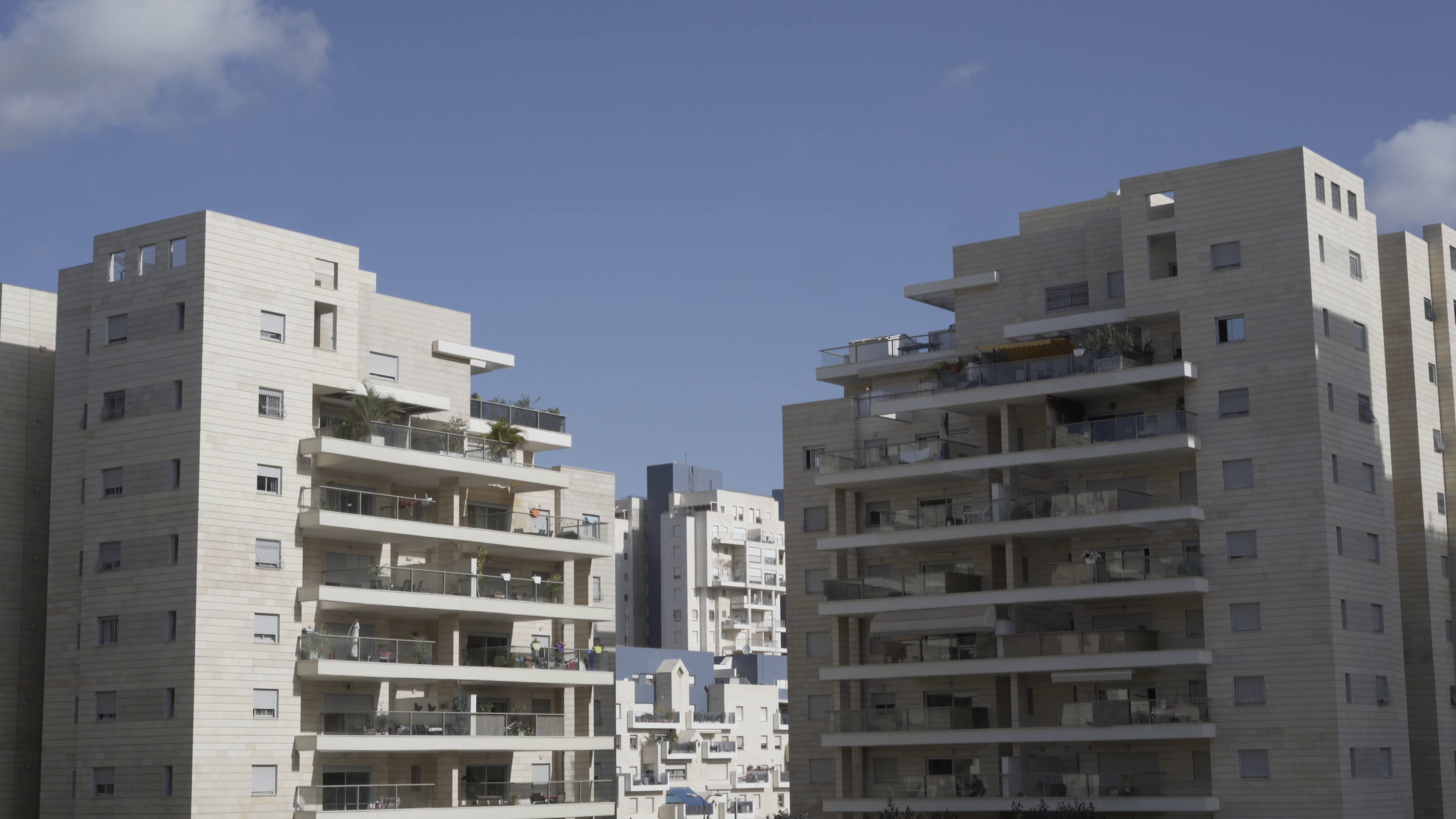

liork Posted November 30, 2015 Author Share Posted November 30, 2015 You can see it in the attached sample. Shot with Cine4 S-Log3. Ungraded. You have to look at full size. Link to comment Share on other sites More sharing options...
liork Posted November 30, 2015 Author Share Posted November 30, 2015 I shot also with Panasonic G7, its also there, but the pattern is better - not in steps like the Sony. The steps cause worse problem in grading. Link to comment Share on other sites More sharing options...
