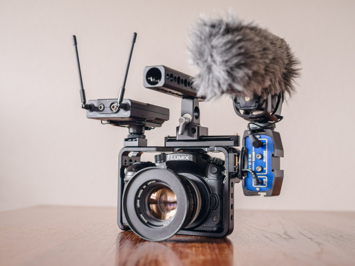

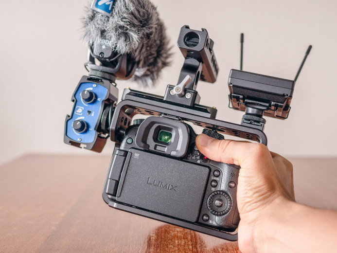

Juxx989 Posted December 24, 2015 Author Share Posted December 24, 2015 I seem to have found my solution... A bit bulkier and more expensive but flexible and still pretty run and gun.On this website http://suggestionofmotion.com/blog/view-factor-contineo-gh4-cage-review/He is reviewing a Cage for the GH4 but at the bottom he shows his audio rig. Looks great for me.. Not too big no huge XLR connections to worry about. A video mic pro, A Wireless Lav Feed into a Device that splits it into 2 channels with Level control. Giving you 2 separate Completely in sync audio tracks. (no post syncing) Just to test the the rig out I found this super cheap Pyle wireless system on Amazon ($15) and a $40 ish Mini Boom Mic http://www.amazon.com/gp/product/B0007L8BQW/ref=pd_luc_rh_bxgy_01_01_t_img_lh?ie=UTF8&psc=1Ill test it out just to see how the whole thing works then get a more expensive one Probably this one if the sale continues till early January when im prepared to buy it.http://www.adorama.com/ATATW1701L.html?emailprice=t&hotlink=t&svfor=5m&utm_medium=Affiliate&utm_source=rflaid62905&cvosrc=affiliate.62905 If anyone interested Here is Links to the components im considering (some are repeats of above)http://www.amazon.com/gp/product/B00CS9E0XE?creativeASIN=B00CS9E0XE&linkCode=w01&linkId=CYKCKOMLEVSXZ4GB&ref_=as_sl_pc_ss_til&tag=6520-20http://www.amazon.com/gp/product/B00N2GJCB2/ref=pd_luc_rh_sbs_03_01_t_img_lh?ie=UTF8&psc=1http://www.amazon.com/gp/product/B0007L8BQW/ref=pd_luc_rh_bxgy_01_01_t_img_lh?ie=UTF8&psc=1http://www.amazon.com/Rode-VMPR-VideoMic-Rycote-Shockmount/dp/B00YAZHRZM/ref=dp_ob_title_cehttp://www.adorama.com/ATATW1701L.html?emailprice=t&hotlink=t&svfor=5m&utm_medium=Affiliate&utm_source=rflaid62905&cvosrc=affiliate.62905 Im still no going to jump until early January so if anyone has thoughts id love to hear Thanks Cinegain 1 Link to comment Share on other sites More sharing options...
teddoman Posted December 24, 2015 Share Posted December 24, 2015 The blue thing looks like a Beachtek MCC-2 passive adapter. (Can you tell I've been researching these too?) hahaI am buying 2 old active adapters to test out (I'll resell 1 of them), the BeachTek DXA-SLR and JuicedLink - DT454. They can be had for 50-100 on ebay, and a few years ago they were sold retail for $250+ but are now discontinued and replaced by newer better models but the reviews on them are pretty decent, especially considering the money you pay today. I figure it makes sense to start with hand me downs since I have absolutely no idea what's what at this point. This is one of those situations where you can only learn what you need by jumping in.Biggest difference between these and the one you're looking at is:Better mics usually require phantom power. MCC-2 doesn't provide power. (Another option: some mics can get phantom power from their own battery.)Active vs passive. Active adapters have preamps and can boost the signal 15 or 30 db before it reaches the camera. If the preamps are good, the camera will get a strong clean signal without noise (and overwhelm the camera's AGC which otherwise will try to raise the volume together with the noise, resulting in a hiss). If you get the MCC-2, you should get something like the Rode Videomic Pro which has its own strong signal, since the MCC-2 doesn't have any preamps.AGC gain disable function. Active adapters I'm buying can turn off the in camera AGC gain by sending a low frequency sound into one of the stereo channels to trick it. You're limited to the other channel then for actual sound. Reason for this feature is AGC cannot be disabled in camera, except for a handful of cameras. AGC is one reason in camera audio is usually poor, because it raises the sound of the noise.The bigger active adapters I'm looking at are mounted under the camera instead of on a hot/cold shoe like the MCC-2. I decided to start out with XLR cables because it's only slightly more bulky but you get less noise interference through the cable, which could become an issue if you ever have a long cable run. All of the better mics use XLR connections so using unbalanced mic jacks also forces you to use bulky adapters anyways (which may degrade signal).That's cool if you're gonna go wireless. It looks like that's what everyone is doing with lav mics now. I don't think I'm going to have a big use for lav mics, but I bought a cheap used Sony ECM-77B (wired XLR) to try out (which some reviews call an industry standard). Maybe at some point I'll get a recorder for the omnidirectional lav mic, but I just decided it was unrealistic for me personally to sync all audio. I'm mainly trying to find the right mic to put on camera now. Apparently shotgun mics are for outdoors and they recommend cardioid or hypercardioid for indoor rooms which cope with reverb from hard surfaces better. Link to comment Share on other sites More sharing options...
