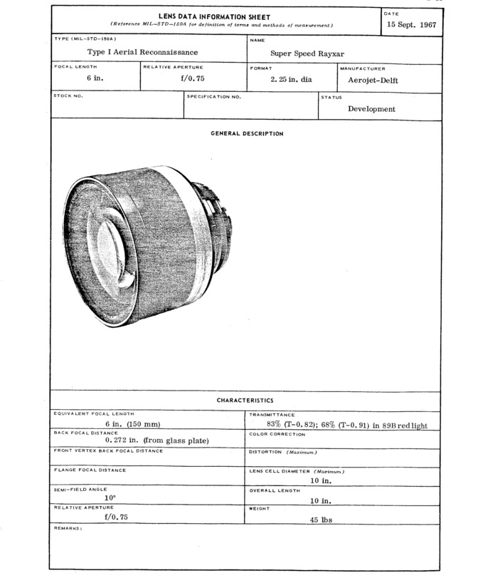

WhiteWolf Posted December 17, 2015 Share Posted December 17, 2015 Surprised no one has mentioned the fastest (and cheapest) MF lens, the Mamiya 80mm f/1.9, known as the Nocilux for Medium Format. It's sharp with lovely characteristic Bokeh. I use the 110mm f/2.8 also, gorgeous glass. I've shot some anamorphic footage also as a taking lens, the image is killer! Yes, the Hasselblads are optimal performers but I find the image less interesting on some versions but that's just me, I love that vintage look. And if we're talking bang-for-buck, nothing touches Mamiya - 200€ for the fastest MF ever made for mass production. Expect that price to go North if Kipon make a Mamiya mount, i'll be getting one for sure.A7rII/sII with this Kipon speed booster and the 80mm f/1.9 Sekor C? *drool*The fastest? Not really... I've got a whole bunch of faster ones sitting here.Here's a complete list of fast medium format lenses:Fairchild 75mm F/1.9Zeiss 125mm F/1.5 SonnarZeiss 85mm F/1.4 PlanarErnostar 85mm F/1.8Ernostar 125mm F/1.8Aerojet Delft 64mm F/1.8 Aerojet Delft 70mm F/1.6 Aerojet Delft 75mm F/1.7Aerojet Delft 100mm F/1.4Aerojet Delft 112mm F/1.4 Aerojet Delft 150mm F/1.5Aerojet Delft 300mm F/1.5Delft Rayxar 105mm F/0.75Delft Rayxar 150mm F/0.75Delft Rayxar 250mm F/0.75Perkin Elmer 75mm F/1.5 Perkin Elmer 150mm F/1.5Perkin Elmer 300mm F/1.5Wild Heerbrugg 98m F/1.4 Wild Heerbrugg 98mm F/1.0Wild Heerbrugg 250mm F/1.8Farrand Optical Super Farron 150mm f/0.87Leitz Elcan 100mm F/1.4Mamiya 80mm F/1.9TTH 100mm F/1.8 Link to comment Share on other sites More sharing options...
Nikkor Posted December 17, 2015 Share Posted December 17, 2015 You can't use that last lens because it has a very short flange focal distance (as said on mflenses.com). There are a lot of fast short teles that could cover 645, but most of them have the same problem. Link to comment Share on other sites More sharing options...
WhiteWolf Posted December 17, 2015 Share Posted December 17, 2015 You can't use that last lens because it has a very short flange focal distance (as said on mflenses.com). There are a lot of fast short teles that could cover 645, but most of them have the same problem.You mean the Delft 112mm f/1.4? The back focal flange distance is 56mm on that lens.The Rayxar 150mm f/0.75 does have a very short back focal distance of only about 7mmhttps://archive.org/stream/USAF_lens_datasheets/03-Section-2-part-2#page/n9/mode/2u Link to comment Share on other sites More sharing options...
