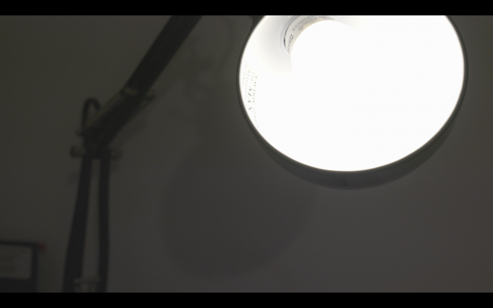

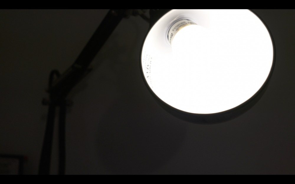

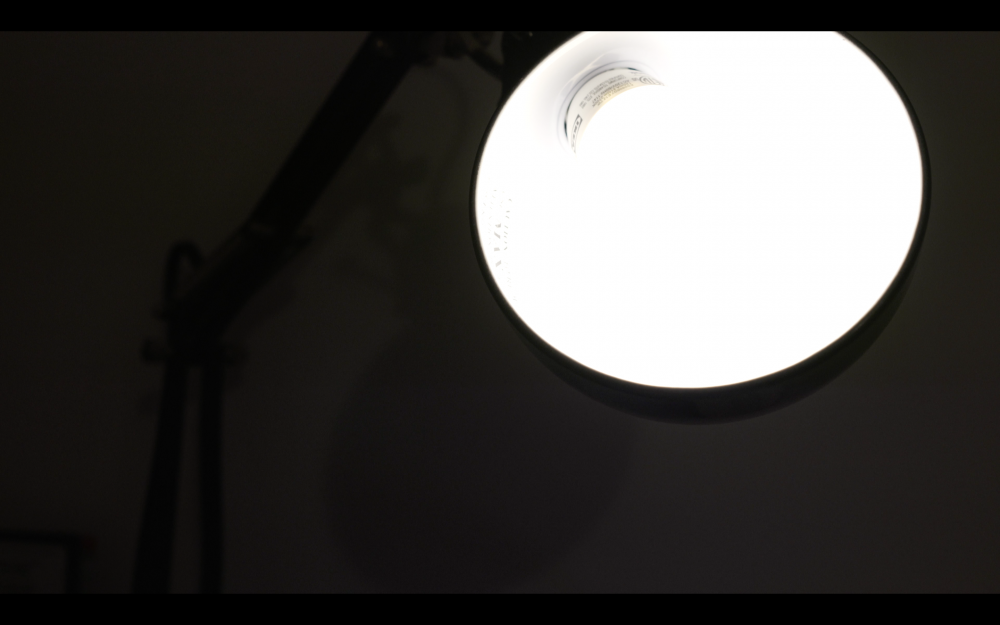

wolf33d Posted December 18, 2015 Author Share Posted December 18, 2015 Just did a non scientific test. As we can see Cine 2 as a clear advantage over Cine4 in term of DR (look at the writing near the light way more visible even though the shadows on the wall are less black).Actually DR is similar with SLOG2 (image not attached but if u raise black levels of Cine2 you get similar shadows while having the writings well appearing) I don't see any better highlights for Cine4, I actually prefer the Cine2 ones.Well this seems to match my "outdoor real" test of yesterday so Cine2 it is for meCine2:Cine4:SLOG Link to comment Share on other sites More sharing options...

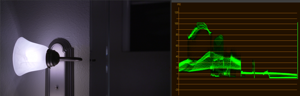

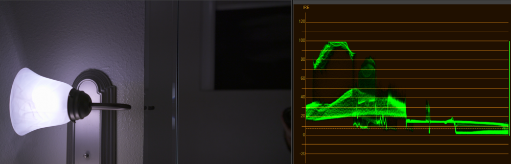

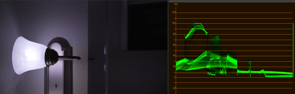

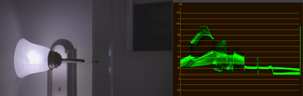

Don Kotlos Posted December 18, 2015 Share Posted December 18, 2015 I don't know how you pulled that off Wolf. Did you use the same profile and expose and only changed from Cine2/Cine4/Slog? Cause when I did this test (same profile, same exposure) here is what I got:Cine2:Cine4:Slog:And the Cine4 uncorrected (0-255 range clipped):You can see that the midtones are the same for Cine2 and Cine4. You can see it also in the YC waveform on the right. Link to comment Share on other sites More sharing options...
wolf33d Posted December 18, 2015 Author Share Posted December 18, 2015 Yep I just changed Cine2/4/slogWas it an A7rII as well ?Interesting because our shadows look similar (better on cine2) but we get opposite highlight!Edit: Well my bad. I reset the settings because the Cine 2 was on wide black gamma +7I have similar result to you but then the Cine2 is just overexposed, so it is the same DR.Interestingly, wide black gammut +7 gives even better highlight than cine4 as seen in my first test. Link to comment Share on other sites More sharing options...
Don Kotlos Posted December 18, 2015 Share Posted December 18, 2015 Yep I just changed Cine2/4/slogWas it an A7rII as well ?Interesting because our shadows look similar (better on cine2) but we get opposite highlight!Yep with the A7rII. The only thing that I can think of is a combination of the knee and possibly your program clipping the Cine4 file. So I am using the parameters in the thread that I posted earlier. I have changed the knee to manual mode. That gave me better highlight rolloff. Give it a try. Also make sure you are not clipping the superwhites. But that shouldn't matter that much if you optimize the knee as my example shows. I have no other explanation of this! Link to comment Share on other sites More sharing options...
