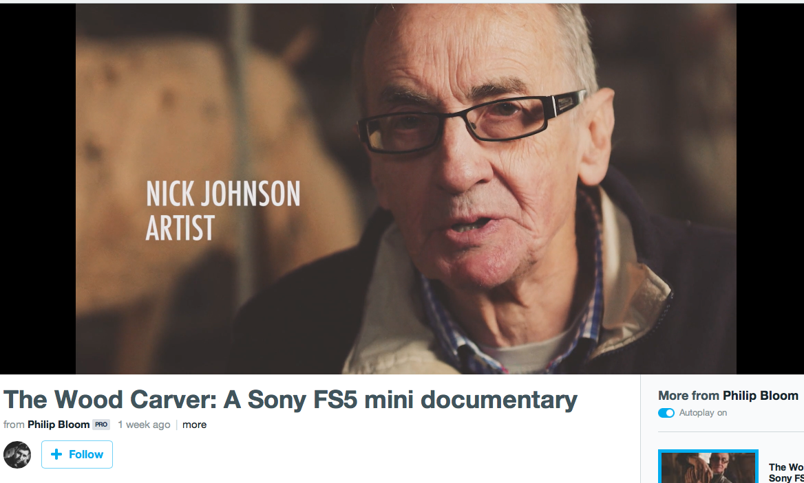

Administrators Andrew Reid Posted January 3, 2016 Author Administrators Share Posted January 3, 2016 I find Sony has a slight blue/magenta cast on skintones... When you warm those skintones to make them more natural, you also warm areas of the scene that then could look unnatural.Maybe this is why they now have 3 colour temperatures of S-Gamut on the FS5.Anyone had experience with FS7 raw? Issues? Link to comment Share on other sites More sharing options...

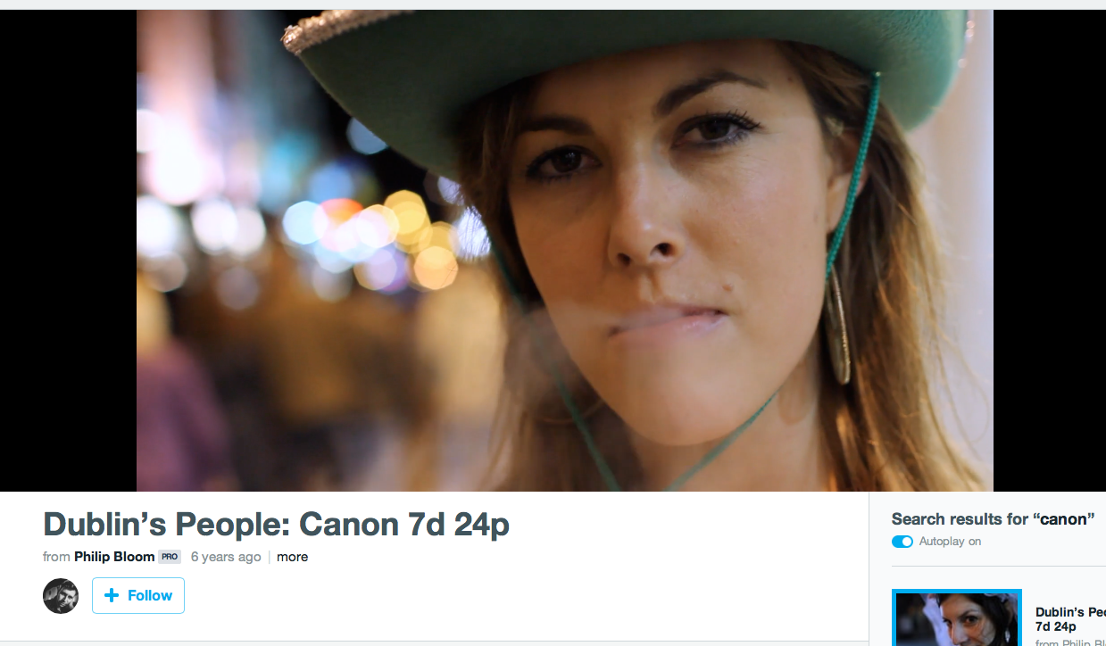

BenEricson Posted January 3, 2016 Share Posted January 3, 2016 This is a pretty good example of what happens in the real world. 6 years later... blondini 1 Link to comment Share on other sites More sharing options...
Administrators Andrew Reid Posted January 4, 2016 Author Administrators Share Posted January 4, 2016 7D doesn't do 240fps though does it? Link to comment Share on other sites More sharing options...
BenEricson Posted January 4, 2016 Share Posted January 4, 2016 7D doesn't do 240fps though does it? Your bookshelf doesn't look any different in 240 I want to love Sony. I have been shooting 5D3 raw for a personal project, FS700/7Q for work. High frame rates are great, wish the FS700 could shoot 24/30 like the 5D3 Raw does. Link to comment Share on other sites More sharing options...
