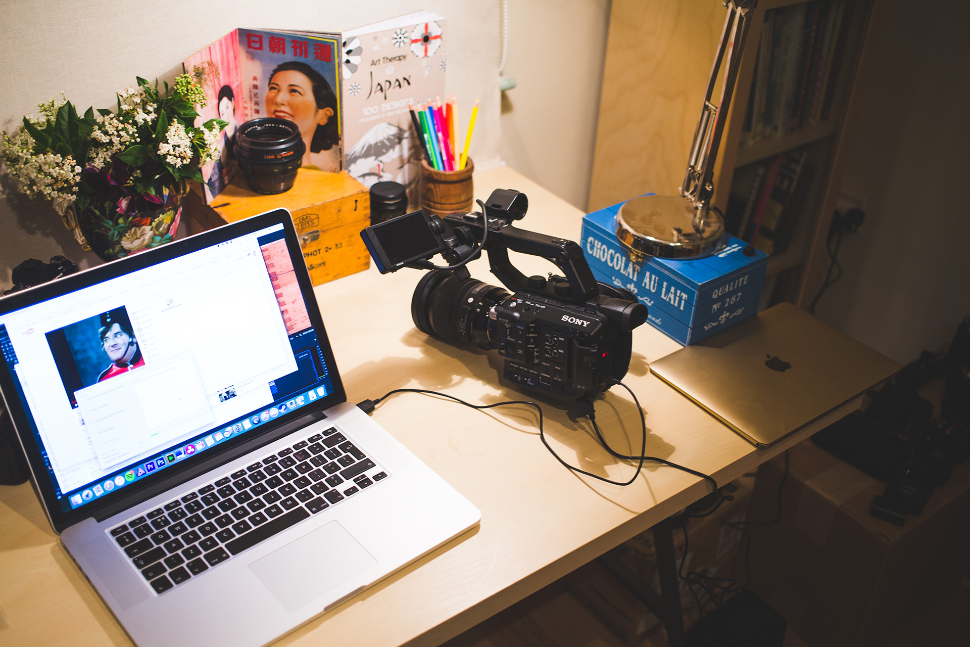

Administrators Andrew Reid Posted January 4, 2016 Administrators Share Posted January 4, 2016 Today I gave my early FS5 feedback to Sony and the good news is they confirmed another firmware update is in the pipeline.I am allowed to give you some of the confirmed new features, although the release timing and full details are yet to be fully decided.It is clear Sony is going to support the FS5 extremely well!Read the full article Link to comment Share on other sites More sharing options...
