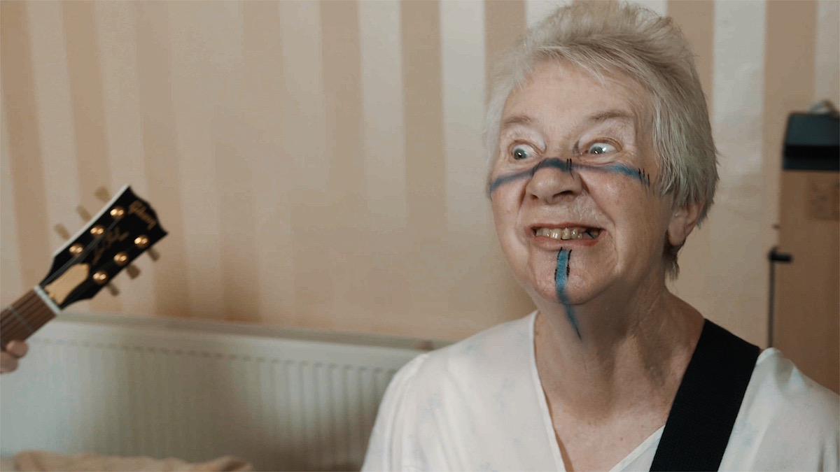

Oliver Daniel Posted January 5, 2016 Share Posted January 5, 2016 I don't understand why you wouldn't shoot in XAVC-I then?Argh not this again.... I do shoot in XAVC-I, but like I've said before sometimes I've had to switch due to a lack of card space or because I'm comparing it to an XAVC-I shot for laughs. I've attached a shot here which I recorded at the end of a shoot. Cards were nearly out of space so just recorded some stuff for giggles - still properly lit and all that. Look at the wallpaper though. Slog3 with a bit of grading. XAVC-L. (XAVC-I doesn't do this). Is that in 10bit?Compression is the enemy of skies and walls isn't it! They need a WALL MODE on the camera It's really bad if the FS7 does this in 10bit 4K. I didn't think it did.They need to prioritise less detailed areas in the image, give them more of bit rate allocation.Good point about having a camera that you don't have to worry about undoing your good work in terms of lighting and setting up the shot. A camera with a limitation I can work around with good lighting (i.e. a noisy high ISO camera) is preferable in that situation to one with a severe codec retardation.Do you have any 'broken' FS7 original files you can share to give me an idea of how severe the problem is?Canon's codec expertise seems better. Doubt the C300 II has such issues.To be fair to XAVC-L though, I am able to bring the shadows / blacks up A HELL OF A LOT on my FS5, more than I remember being able to do with XAVC-S. Very little noise in them. It can wrok in a lot of situations. Some of my shots look great and it grades pretty well. But it breaks. A lot. Sadly i can't share actual files because of the contracts. Link to comment Share on other sites More sharing options...
Administrators Andrew Reid Posted January 5, 2016 Author Administrators Share Posted January 5, 2016 That is in 10bit on the FS7?Oh dear!Maybe FS5 not so far off then.XAVC-L is such a disappointment. If they had some noise to dither the banding or to keep low detail areas of the image intact from too much compression, it would really help.Turn the noise reduction off Sony! Link to comment Share on other sites More sharing options...
Oliver Daniel Posted January 5, 2016 Share Posted January 5, 2016 That is in 10bit on the FS7?Oh dear!Maybe FS5 not so far off then.XAVC-L is such a disappointment.If they had some noise to dither the banding or to keep low detail areas of the image intact from too much compression, it would really help.Turn the noise reduction off Sony!Yes indeed!I've said it before and I'll say it again. XAVC-L is a bag of crap (sometimes, not always, but enough to annoy the hell out of you). Link to comment Share on other sites More sharing options...
