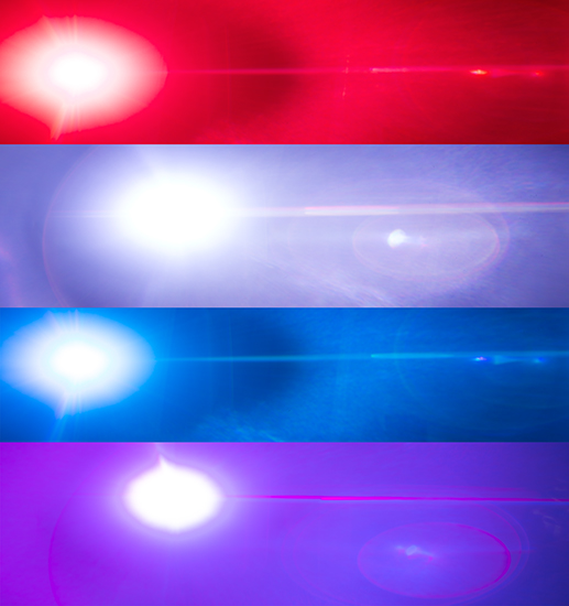

danreddingvideo Posted January 11, 2016 Share Posted January 11, 2016 I'm shooting on a Kowa 8Z and am currently using a Helios 44-2 58 F2 as a taking lens. I've found it surprisingly hard to get flares that resemble the classic anamorphic streaky look.. I've only really taken it out on one shoot, but I've had a play around with is quite a bit and a mate mentioned that the taking lenses will (obviously) influence the shot looks, but I wondered if changing the taking lens would change the flare characteristics substantially? Like I say, I've only taken it out once and I was pointing it right into the light most of the time (video below), although obviously not on the silly grade time lapses. I've been hunting around on ebay and am considering the following, but can anyone tell me how much difference they're going to make, or show me some footage from a similar set-up? I'm not unhappy with the Helios, and perhaps it's not flaring because of LED lights in squares, instead of one focussed light source...Potential Lenses:Rokkor 58 1.2 or 1.4Jupiter 9 85 F2Carl Zeiss Jenna 80 F2.8Reckon these are worth the investment, or will it make no difference? Rudolf 1 Link to comment Share on other sites More sharing options...
Rudolf Posted January 11, 2016 Share Posted January 11, 2016 I don't know the classic anamorphic streaky look. The Helios is great with the Kowa and the Jupiter 85mm is a perfect addition (they are very prone to flares). If you choose a modern multicoated lens there is much less flare. The thing is though that anamorphics were not invented to produce flares or oval bokeh. They determine the composition and you can shoot with longer lens and get more shallow depth. It is a matter of the subject if you go the anamorphic route or not. But nowadays nearly everything is shot/cropped in 2.40. Not sure if even L. Trier does it now instead of his dogmas (didn't he say they are obsolete?) danreddingvideo 1 Link to comment Share on other sites More sharing options...
danreddingvideo Posted January 11, 2016 Author Share Posted January 11, 2016 I don't know the classic anamorphic streaky look. The Helios is great with the Kowa and the Jupiter 85mm is a perfect addition (they are very prone to flares). If you choose a modern multicoated lens there is much less flare. The thing is though that anamorphics were not invented to produce flares or oval bokeh. They determine the composition and you can shoot with longer lens and get more shallow depth. It is a matter of the subject if you go the anamorphic route or not. But nowadays nearly everything is shot/cropped in 2.40. Not sure if even L. Trier does it now instead of his dogmas (didn't he say they are obsolete?) So I just meant the cliche' long anamorphic flares, by "the streaky look".... Well, personally, I think the real thing looks a million times better than the short cropped digital thing, but maybe I'm just a bit keen as it's all new to me.... I guess it's obvious that the characteristics of the taking lens will show through in the work, but I just wondered how much and how different they are. I'll buy a jupiter 9 and do a comparison... If nothing else, the different focal lengths would be handy. Link to comment Share on other sites More sharing options...
DanC1 Posted January 11, 2016 Share Posted January 11, 2016 I recently compared the horizontal flare on the Helios to a Nikon 50mm f1.8 both with the Sankor 16c attached. I found the Helios gave a more subtle flare and the Nikon a stronger 'blue line' horizontal flare. danreddingvideo 1 Link to comment Share on other sites More sharing options...
danreddingvideo Posted January 11, 2016 Author Share Posted January 11, 2016 I recently compared the horizontal flare on the Helios to a Nikon 50mm f1.8 both with the Sankor 16c attached. I found the Helios gave a more subtle flare and the Nikon a stronger 'blue line' horizontal flare.Ah, thanks! Good to know, and another lens to consider. I was in need of justification to spend my not very hard earned money.... I shall go back to scouring ebay in the quest for another lens to try. I'll look up the Nikon,,, might be a good shout as hopefully there's a better Nikon to Canon adapter than the M42 ones, which seem a bit loose... Link to comment Share on other sites More sharing options...
nahua Posted January 11, 2016 Share Posted January 11, 2016 @danreddingvideo You have all good old lenses there. I have owned all of them and they all flare well. In fact there's a ton of flaring in your video. But you're looking for sharp long streaks, and if you want more then you need to look at other lenses. The older lenses flare because of the old single-coating of the lenses. But the drawback is that they have a more "smeared" effect and not the sharp lines you're looking for. Those sharp lines occur more with double or more modern coating on lenses. But that drawback is you need to have a very very bright lightsource, like the sun. You can look at some old zooms, like the Tokina 28-80mm F2.8, Nikon 28-80mm F2.8, or something similar. The more lens elements, the more flaring artifacts there is. It's hard finding the right combination of taking lens with Anamorphic. Here's an old test I did with my Kowa B&H 2x (Same as your Kowa 8z). Strong lights will get the flares you're looking for. https://vimeo.com/108202883 danreddingvideo 1 Link to comment Share on other sites More sharing options...

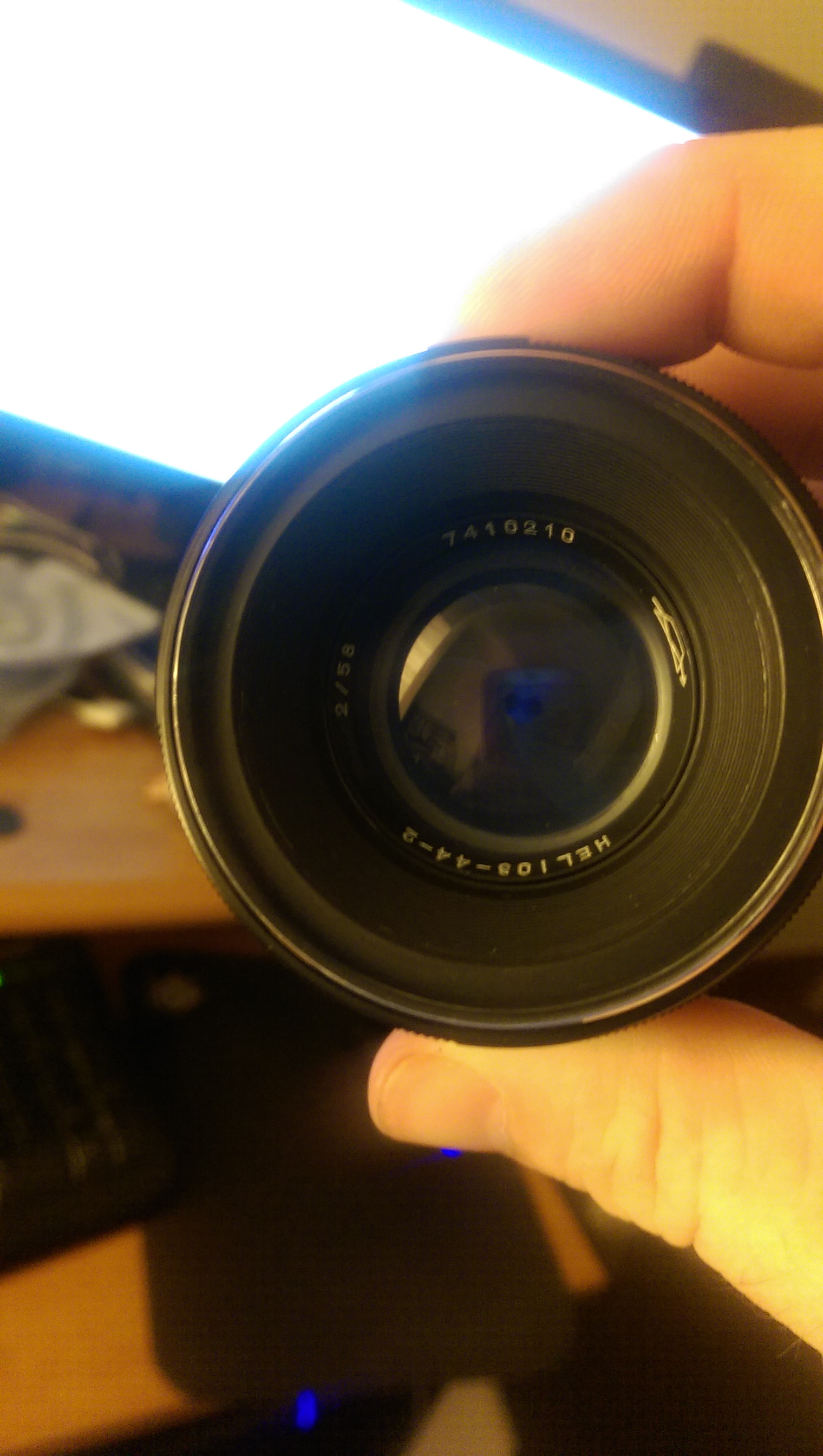

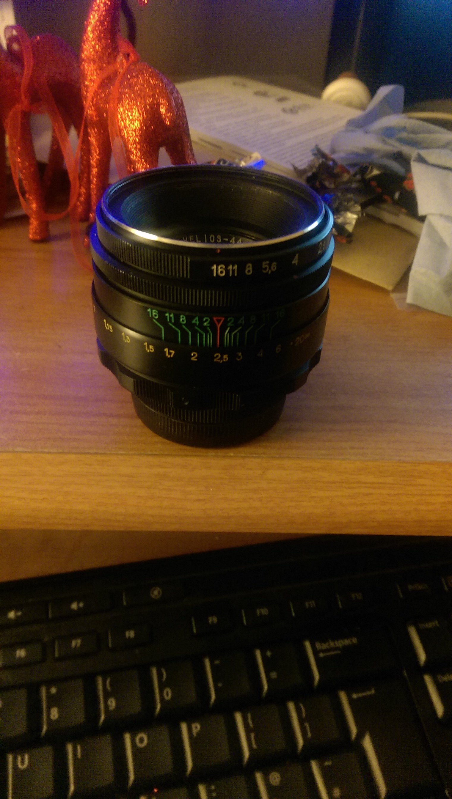

Hans Punk Posted January 12, 2016 Share Posted January 12, 2016 I'm shooting on a Kowa 8Z and am currently using a Helios 44-2 58 F2 as a taking lens. I've found it surprisingly hard to get flares that resemble the classic anamorphic streaky look.. I've only really taken it out on one shoot, but I've had a play around with is quite a bit and a mate mentioned that the taking lenses will (obviously) influence the shot looks, but I wondered if changing the taking lens would change the flare characteristics substantially? I've been hunting around on ebay and am considering the following, but can anyone tell me how much difference they're going to make, or show me some footage from a similar set-up? I'm not unhappy with the Helios, and perhaps it's not flaring because of LED lights in squares, instead of one focussed light source...I might be completely wrong but it looks like the Helios you have might be the more 'modern' type - has more flare suppression coating on the optics. But it could also be completely due to the light source in the setup. Also if you are shooting smaller than s35 sensor, you will only be capturing part of the Helios' potential for flare - as some of the charm of older Helios models are the 'secondary' rings and rainbows that tend to fall at the edge of the frame. When coupled to anamorphic front, this can greatly add to the overall impact of the 'streak flare.' I would expect more flare from an older model such as the 'Zebra' or pre '2' model called simply the 'Helios 44' (simple golden coating) - or the KMZ Helios 44-2 with green and yellow distance markings (this model should compliment your kowa 8z's flare colour the best). These are the better lenses to achieve flares with, as they are the earlier models that have less refined coatings and are more prone to bouncing light inside the optic edges when wide at f2. Having an older model such as the KMZ Helios 44-2 will greatly increase flare when opened up.Jupiter-9 is a good 85mm pairing to the Helios-44 58mm (again look for older model).Other lenses worth considering (not primarily for 'crazy' flares) are the Pentacon preset type, 14-15 blades ensure circular aperture throughout stops - resulting in constant oval bokeh when paired with your Kowa. The 135mm pentacon f2.8, Meyer Orestor 100mm 2.8 and TAIR-11A 135mm f2.8 are particularly good for anamorphic use. Older Nikkor's flare very nicely, but have fewer aperture blades - so they cut into the oval bokeh quite harshly.Older Olympus OM's are a very good choice too - as they are very sharp, flare is not so pronounced but can easily be acquired to make a nice matched shooting set. As for light source, the LED lights in squares will give a blocky diffused streak (as do fluorescent tubes/kino's), best to use a point source (such as the sun for exteriors) or for interiors - a single bright lamp such as a single chip LED desk lamp...or even better a tungsten/halogen light source. A very cheap light to use for some interior shoot's like your example video can be a 'pinspot' - a par-36 lamp that is very pokey and can be easily rigged on a stand or set on the floor to give a shaft of light that you can maneuver to lens in and out of : http://www.ebay.co.uk/itm/Pinspot-PAR-36-30W-Black-Lantern-suitable-for-Mirrorball-Includes-Lamp-Stage-DJ-/181599693906?hash=item2a482f6c52:g:y1kAAOSwGWNUV7WoThere are LED 'pinspot' versions out there that are also good - that have focusable spots, they are lighter to rig but can flicker at some shutter speeds. (but tungsten lamp tends to give a nicer/more natural look IMHO and almost immune to flicker at most shutter speeds). Xavier Plagaro Mussard and danreddingvideo 2 Link to comment Share on other sites More sharing options...
danreddingvideo Posted January 12, 2016 Author Share Posted January 12, 2016 I might be wrong but it looks like the Helios you have might be the more 'modern' type - has better flare suppression coating on the optics. But it could also be due to the light source. Also if you are shooting smaller than s35 sensor, you will only be capturing part of the Helios' potential for flare - as some of the charm of older Helios models are the 'secondary' rings and rainbows that tend to fall at the edge of the frame. When coupled to anamorphic front, this can greatly add to the overall impact of the 'streak flare.' I would expect more flare from an older model such as the 'Zebra' or pre '2' model called simply the 'Helios 44' (simple golden coating) - or the KMZ Helios 44-2 with green and yellow distance markings (this model should compliment your kowa 8z's flare colour the best). These are the better lenses to achieve flares with, as they are the earlier models that have less refined coatings and are more prone to bouncing light inside the optic edges when wide at f2. Having an older model such as the KMZ Helios 44-2 will greatly increase flare when opened up.Other lenses worth considering (not primarily for 'crazy' flares) are the Pentacon preset type, 14-15 blades ensure circular aperture throughout stops - resulting in constant oval bokeh when paired with your Kowa. The 135mm pentacon f2.8, Meyer Orestor 100mm 2.8 and TAIR-11A 135mm f2.8 are particularly good for anamorphic use. As for light source, the LED lights in squares will give a blocky diffused streak (as do fluorescent tubes/kino's), best to use a point source (such as the sun for exteriors) or for interiors - a single bright lamp such as a single chip LED desk lamp...or even better a tungsten/halogen light source. A very cheap light to use for some interior shoot's like your example video can be a 'pinspot' - a par-36 lamp that is very pokey and can be easily rigged on a stand or set on the floor to give a shaft of light that you can maneuver to lens in and out of : http://www.ebay.co.uk/itm/Pinspot-PAR-36-30W-Black-Lantern-suitable-for-Mirrorball-Includes-Lamp-Stage-DJ-/181599693906?hash=item2a482f6c52:g:y1kAAOSwGWNUV7WoThere are LED 'pinspot' versions out there that are also good - that have focusable spots, they are lighter to rig but can flicker at some shutter speeds. (but tungsten lamp tends to give a nicer look IMHO and almost immune to flicker at most shutter speeds).Thanks for the very comprehensive answer!! I'm shooting on a GH4, but with the speed booster, so I think I'm cropping at 1.7 ish... I'm also in anamorphic 4:3 mode, so not sure if that effects things too?I've attached some images of the Helios 44-2... Does the 1st two digits of the serial number reflect the date? That a good one you reckon?I'll look into all the lenses you mention! The lighting advise is VERY useful too.. Hans Punk 1 Link to comment Share on other sites More sharing options...
Hans Punk Posted January 12, 2016 Share Posted January 12, 2016 Yep - that is a '74 and should be all good. It must be the light source in the scene that is not pokey enough to flare. Makes sense if it is a LED brick light with multi points of light - especially if diffused. If you are ever looking for another Helios to try, I'd recommend the 'Zebra' Helios 44 with glossy black finish - it's a variation on the theme but can give some nice alternate flare artifacts. Sometimes even getting a cheaper/older Helios that is beaten up a little and has coating wear can actually increase the effects without affecting sharpness.richg101 on this forum is the guy to talk to regarding all the flavors of Helios 44 and the nuances of every year and factory release.In addition to recommending the 30w par-36 pinspot, if you want something less powerful yet really lightweight are portable - the Ikea Jansjo LED is a very handy light to rig to fire into the lens and get the results that you were after in your example video. http://www.amazon.co.uk/dp/B00I9A2Z2Y/ref=pd_lpo_sbs_dp_ss_1?pf_rd_p=569136327&pf_rd_s=lpo-top-stripe&pf_rd_t=201&pf_rd_i=B0055IVM1I&pf_rd_m=A3P5ROKL5A1OLE&pf_rd_r=1VJBC9JC5PDQJ7J8FTJ9 Link to comment Share on other sites More sharing options...
Daniel P Redding Posted January 12, 2016 Share Posted January 12, 2016 Yep - that is a '74 and should be all good. It must be the light source in the scene that is not pokey enough to flare. Makes sense if it is a LED brick light with multi points of light - especially if diffused. If you are ever looking for another Helios to try, I'd recommend the 'Zebra' Helios 44 with glossy black finish - it's a variation on the theme but can give some nice alternate flare artifacts. Sometimes even getting a cheaper/older Helios that is beaten up a little and has coating wear can actually increase the effects without affecting sharpness.richg101 on this forum is the guy to talk to regarding all the flavors of Helios 44 and the nuances of every year and factory release.In addition to recommending the 30w par-36 pinspot, if you want something less powerful yet really lightweight are portable - the Ikea Jansjo LED is a very handy light to rig to fire into the lens and get the results that you were after in your example video. http://www.amazon.co.uk/dp/B00I9A2Z2Y/ref=pd_lpo_sbs_dp_ss_1?pf_rd_p=569136327&pf_rd_s=lpo-top-stripe&pf_rd_t=201&pf_rd_i=B0055IVM1I&pf_rd_m=A3P5ROKL5A1OLE&pf_rd_r=1VJBC9JC5PDQJ7J8FTJ9 Thanks again! I've just brought the pin shot par 36 and will do an experiment with it to see how it matches with my usual set up. Not sure the colour temperature will match, but we will see. When I get another lens I'll try and buy something else a bit older and more roughed up... Looking forward to trying out that light, thanks for the advise! Link to comment Share on other sites More sharing options...

Bioskop.Inc Posted January 13, 2016 Share Posted January 13, 2016 You've got everything you need to make the Kowa flare (Helios is the King), but not with that square light (as Hans has stated) - you'd get better results with the light on your phone. The best light source to make your lens flare (like the ones in Star Trek), is to use a high powered torch.A few pointers about flare:ISO/ASA & F/T Stop can all play their role (some cameras produce better flares with High ISO & some with Low ISO - you shouldn't stop down too much on your taking lens).You can actually focus on the flares (ie. make them sharper/stand out more) & you'll notice that there should be 2 sets of horizontal flares (one closer to your camera & one further away).You don't have to have the lens pointing directly into the light source to create flares (so the light creating the flare doesn't have to be in shot).Lastly, practice, experiment & get to know your lens set up.Oh & if you do start buying other lenses, buy the ones with the Golden-ish tinted coatings for the best/craziest flares. Hans Punk 1 Link to comment Share on other sites More sharing options...
Daniel P Redding Posted February 3, 2016 Share Posted February 3, 2016 thanks to everyone that contributed to this post. I went out and brought a Zeiss 1.8 pancolor and shot this with it last week. Much happier with the flares I getting now, although I think I could probably find something a bit sharper. Been looking at a few Nikon 50mm ai 1.4 lenses, but not sure my addiction to buying taking lenses will end there. Thanks to everyone for their great advice! I want to shoot everything in anamorphic right now! Link to comment Share on other sites More sharing options...
