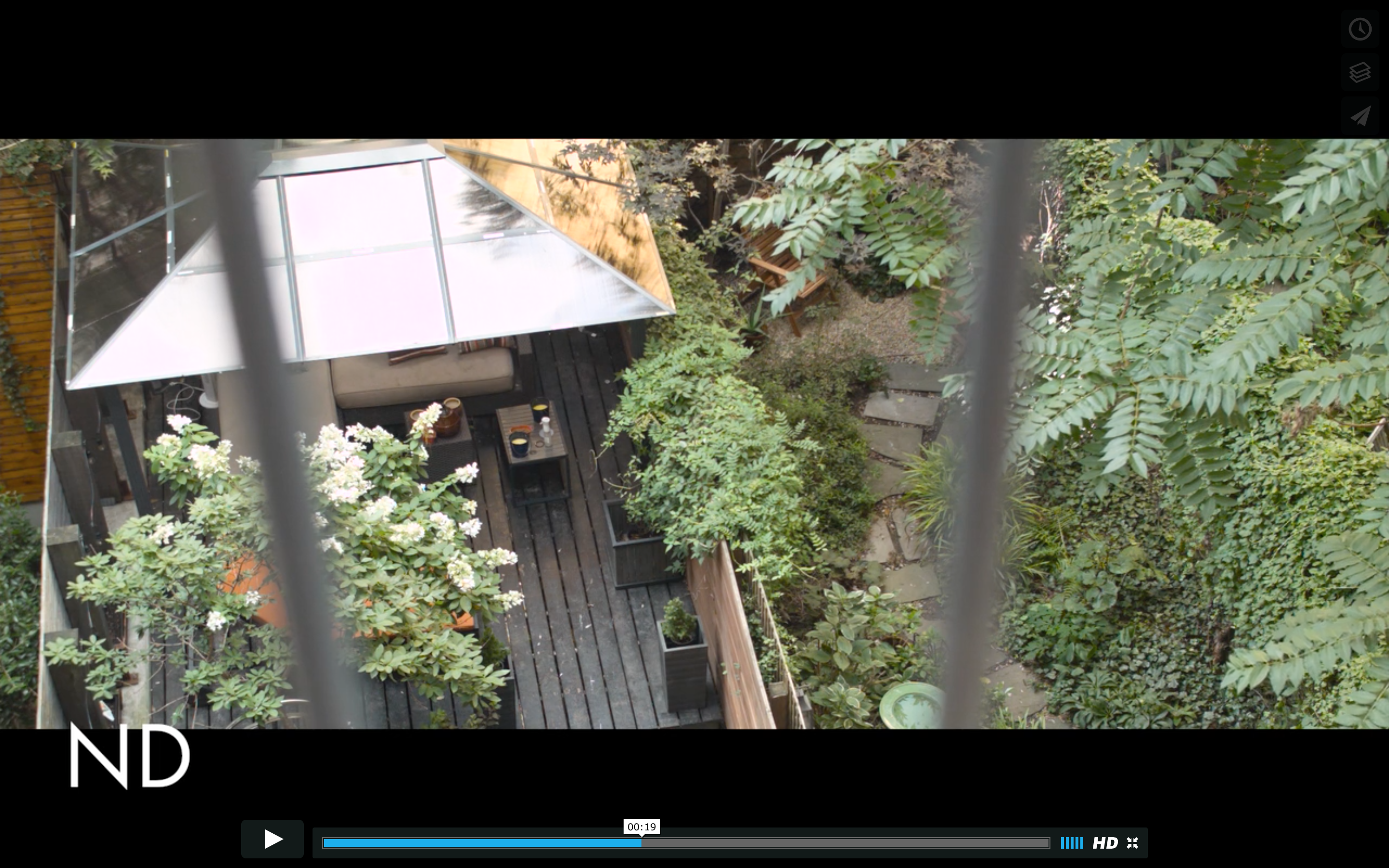

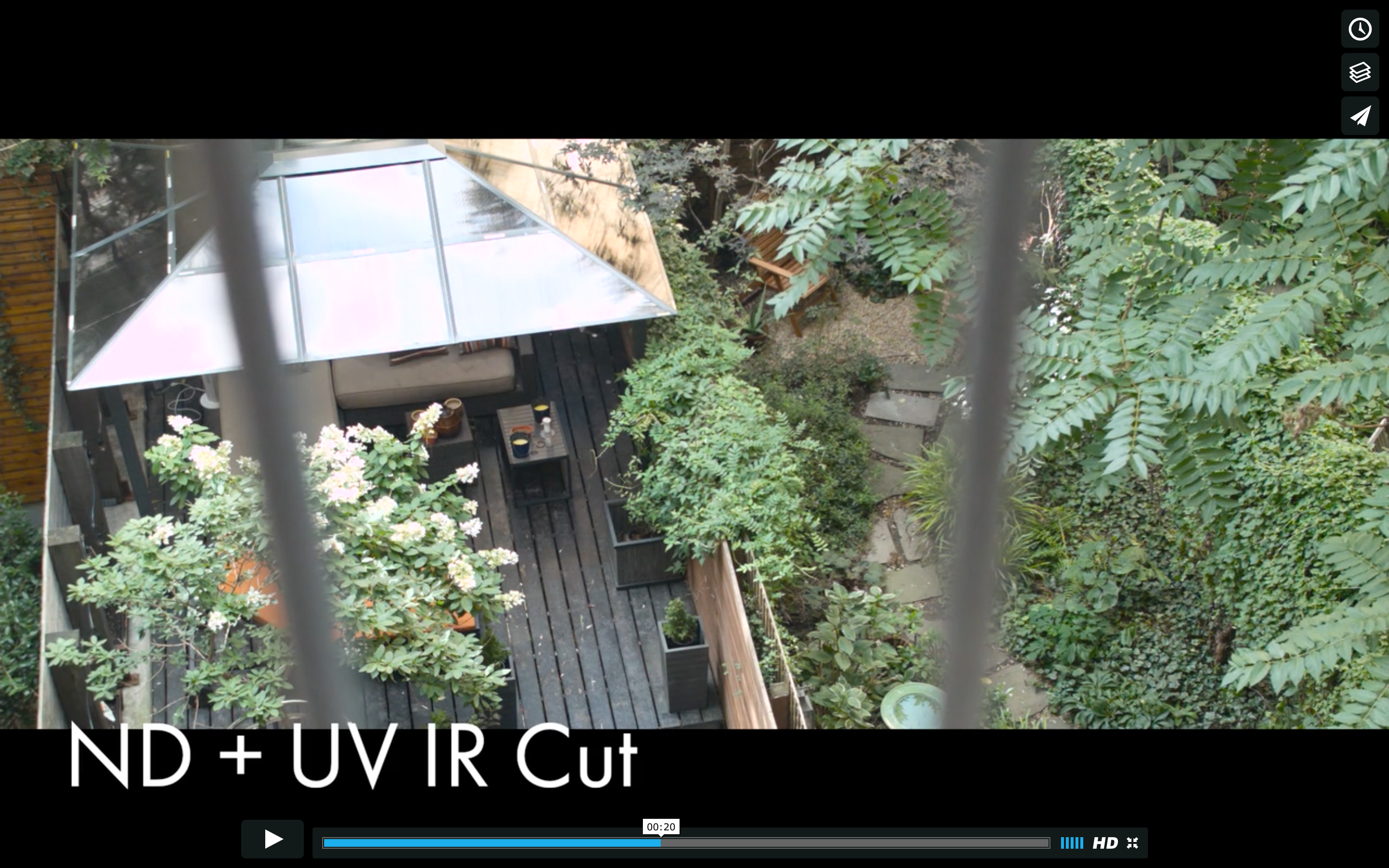

cantsin Posted January 15, 2016 Share Posted January 15, 2016 Seems you have infrared pollution on your footage (this is why the image looks brownish). Strong recommendation: get IR cut filters for your lens. You should always use them when you shoot with the BM Pocket. Link to comment Share on other sites More sharing options...
BenEricson Posted January 15, 2016 Share Posted January 15, 2016 Seems you have infrared pollution on your footage (this is why the image looks brownish). Strong recommendation: get IR cut filters for your lens. You should always use them when you shoot with the BM Pocket.This.. ^You can get such amazing color with an IR cut filter. It really makes the imagine just that much nicer. I wish there was a moire/IR cut internally... Lintelfilm 1 Link to comment Share on other sites More sharing options...
Lintelfilm Posted January 15, 2016 Share Posted January 15, 2016 This.. ^You can get such amazing color with an IR cut filter. It really makes the imagine just that much nicer. I wish there was a moire/IR cut internally...Yeah lets hope the Micro Cinema Camera needs less fixes by the end user. If it ever arrives. Link to comment Share on other sites More sharing options...
Turboguard Posted January 16, 2016 Share Posted January 16, 2016 Just look at this difference Foliage is always a good spot to find the IR pollution. Link to comment Share on other sites More sharing options...
