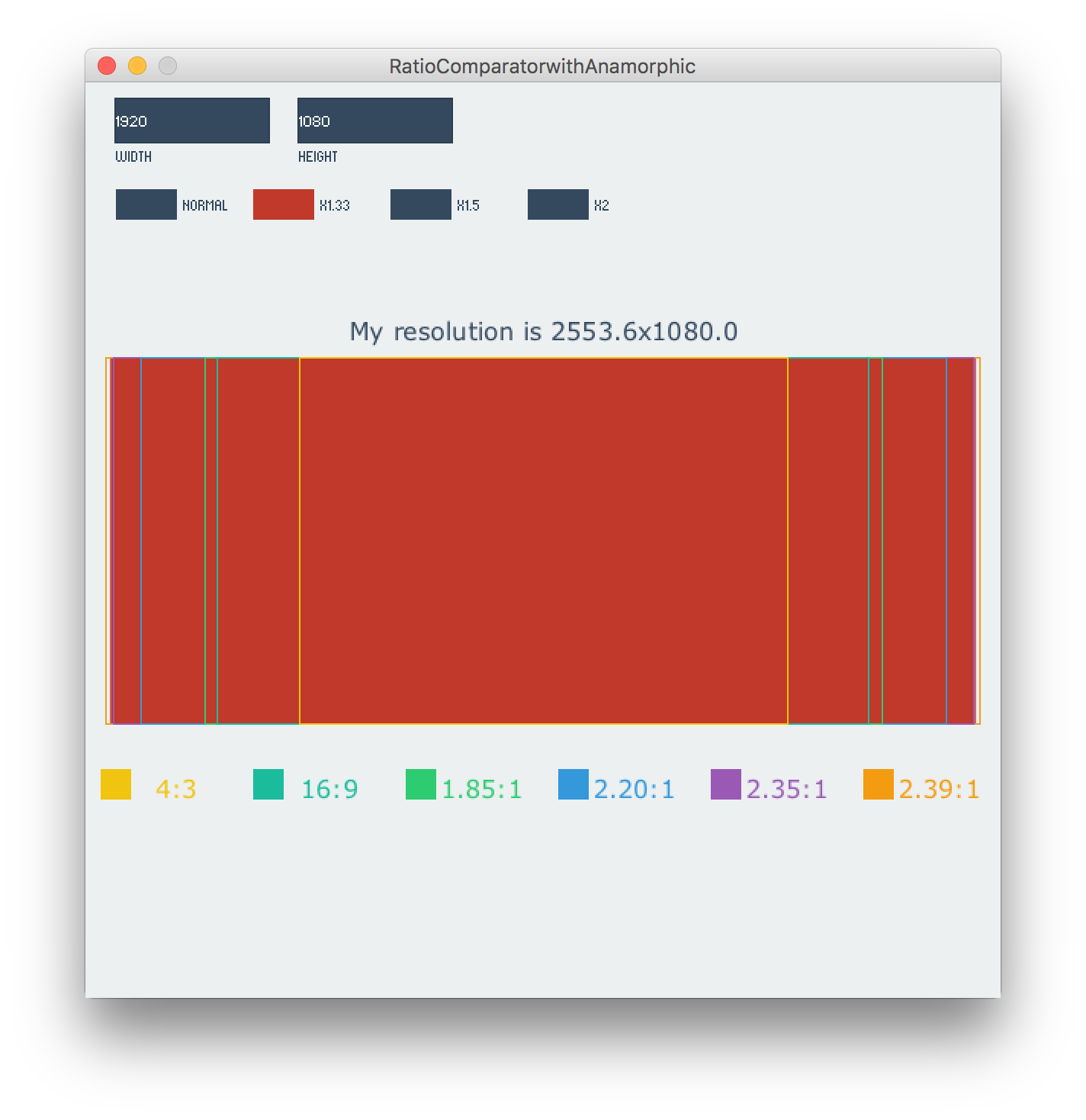

sandrobrito Posted January 22, 2016 Share Posted January 22, 2016 Hello guys, I'm creating this post to share something I did for myself to help me understand the difference between the original aspect ratio and end aspect ratio after de-squeeze with the different anamorphic lenses. Maybe it will be helpful for someone else. You can download it for mac of pc here http://www.sandrobrt.com/ratio-comparison-tool Xavier Plagaro Mussard, Timotheus, Tito Ferradans and 2 others 5 Link to comment Share on other sites More sharing options...

Rumple Posted January 24, 2016 Share Posted January 24, 2016 How come you are upscaling the width, instead of downscaling the height? Link to comment Share on other sites More sharing options...
sandrobrito Posted January 25, 2016 Author Share Posted January 25, 2016 I can do both. I've seen a lot of approaches online and I just opted for that one here. The tool is more to see the small visual difference between the ratios rather than the resolution itself. Maybe I will add a toggle in case people rather downscale the height instead. Thanks for that Olá Tito!I thought of doing it online too put since I just did this for my own purposes initially I just went with what I was more comfortable coding. Link to comment Share on other sites More sharing options...
Tito Ferradans Posted January 25, 2016 Share Posted January 25, 2016 How come you are upscaling the width, instead of downscaling the height?It doesn't matter much, as the tool is calculating the aspect ratio, not the final resolution. If you downscale height or upscale width, the ratio h/w in both cases will be the same.I can do both. I've seen a lot of approaches online and I just opted for that one here. The tool is more to see the small visual difference between the ratios rather than the resolution itself. Maybe I will add a toggle in case people rather downscale the height instead. Thanks for thatOlá Tito!I thought of doing it online too put since I just did this for my own purposes initially I just went with what I was more comfortable coding. Olá Sandro! Brasileiro? hahahahaCool cool cool. I'm still gonna LEARN javascript and jQuery for mine, so it might take a while. What did you use for yours, Python? Link to comment Share on other sites More sharing options...
sandrobrito Posted January 26, 2016 Author Share Posted January 26, 2016 Português I did it in Processing, its kind of a simplified java framework. Tito Ferradans 1 Link to comment Share on other sites More sharing options...
Tito Ferradans Posted February 13, 2016 Share Posted February 13, 2016 Sandro, I took a few hours to work mine out. Javascript and wordpress plugins. If you wanna check it out: http://www.tferradans.com/blog/?p=8615 Bold 1 Link to comment Share on other sites More sharing options...
