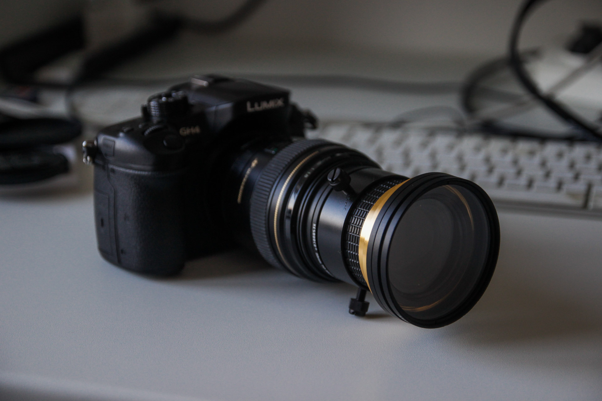

funkyou86 Posted April 4, 2016 Share Posted April 4, 2016 Hey, Bought a Moller few weeks ago. It's an awesome piece of gear, got it with a custom housing and threads. As you can see, it is very hard to pull focus properly. This was shot handheld, without external monitor. Because of the anamorphic lens attachment, there isn't coming too much light throug, so the Gh4's focus peaking does not work very well, so I had to judge the focus just by my eyes. The lens was set to f2.8, but note that there is a speedbooster in the chain as well. The setup was: GH4 + Mitakon Lens Turbo + Canon 85mm f1.8 + Moller 1.5x anamorphot + 0.5 diopter I did not spend much time with the edit... Byron Yang 1 Link to comment Share on other sites More sharing options...
