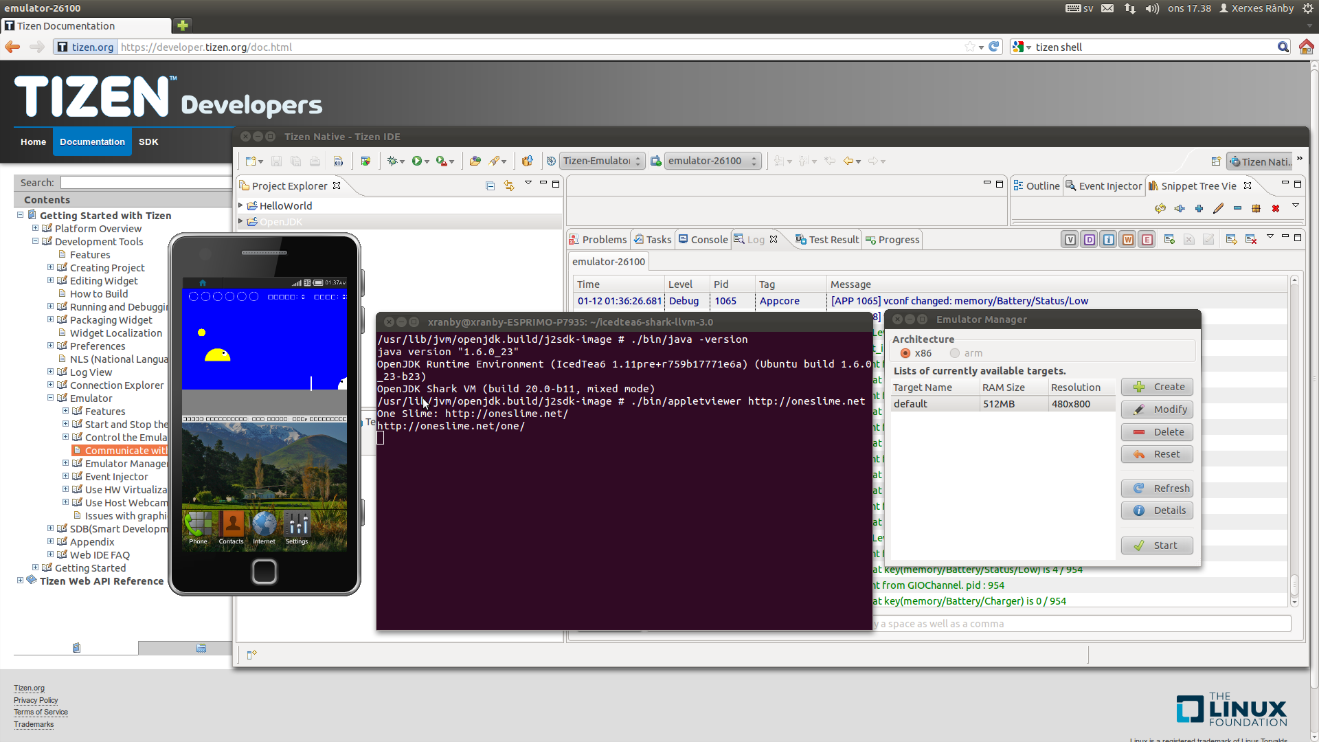

Marco Tecno Posted March 2, 2016 Share Posted March 2, 2016 chant. very interesting. a big question: do you have a vr emulating a nx1? did you write it? Link to comment Share on other sites More sharing options...
