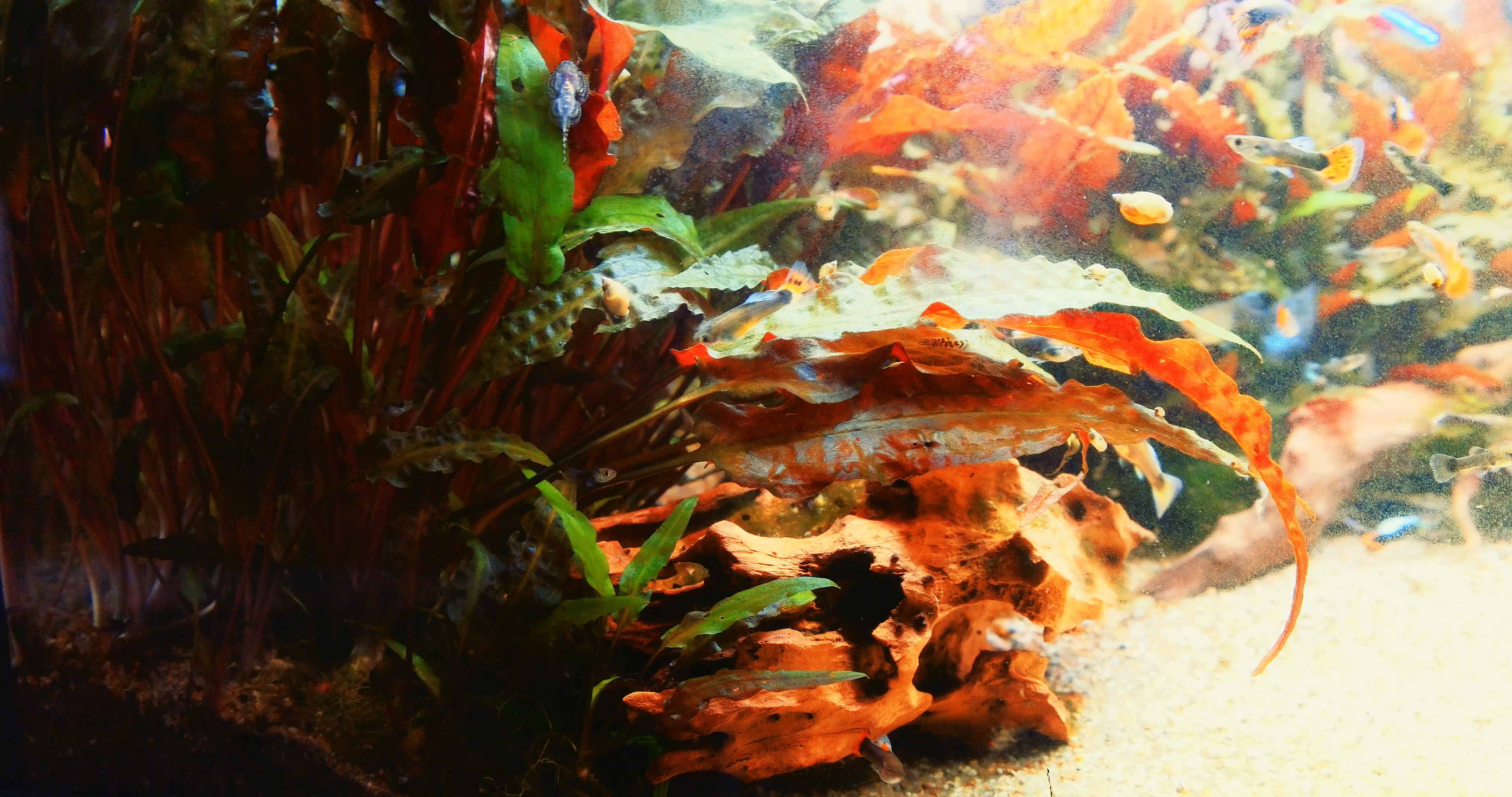

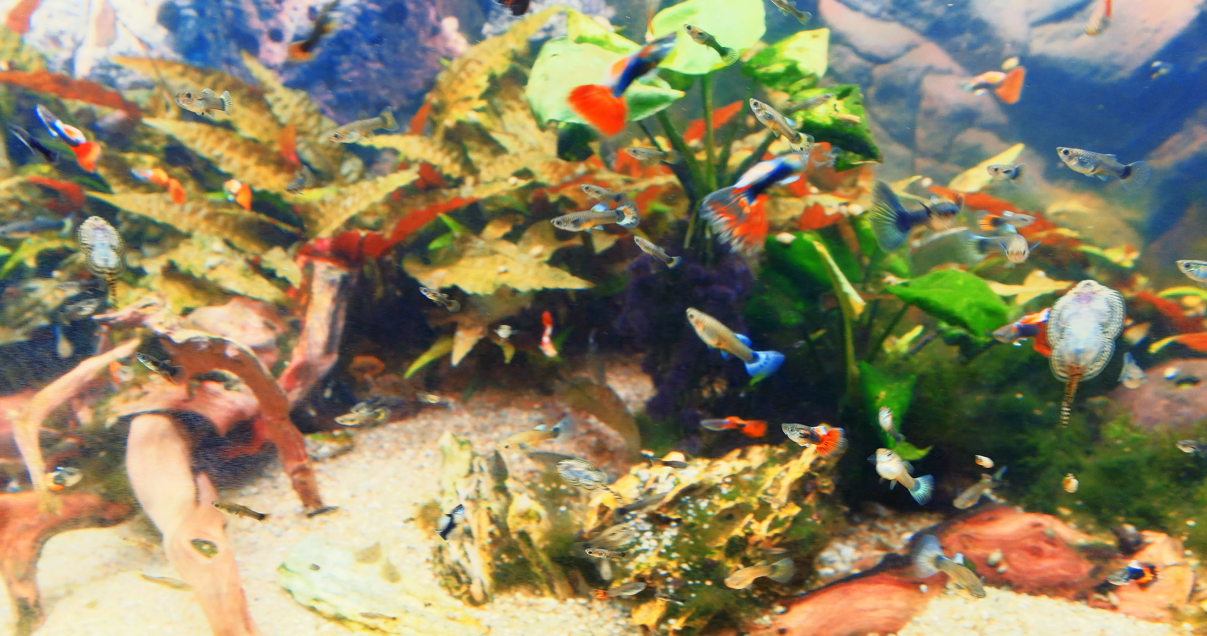

SMGJohn Posted March 19, 2016 Share Posted March 19, 2016 No one seemed to have graded the video footage from Vasile so I decided to have a go and oh boy its glorious, the image has a very analogue feel to it at least in my opinion, I have tried to push the colours very far, much further than I normally would with the regular NX1 footage to see what happens, the NX1 suffers from colour bleeding at times specially when there is strong colour light on a scene like concerts etc. In this footage I did not notice any so that in itself is pretty glorious. Everyones favourite, the Vasile Frame EOSHD GammaDR2LOG LUT Applied Quick Grade with VisionColor's Impulz LUT - Tetrachrome 400 and high colour saturation A more colourful frame Kisaha, Otto K and Marco Tecno 3 Link to comment Share on other sites More sharing options...
