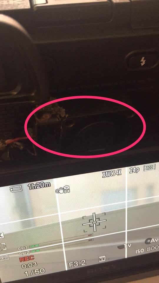

Tony Anastasi Posted March 16, 2016 Share Posted March 16, 2016 bad news is those without fans but using external recorders are also reporting over heating without recording incamera.. so fans it is.. bunch of guys over in max's private a6300 facebook group (1300 users already) have already started hacking their a6300's with tiny fans.. first couple of guys are getting 1.5hrs straight no over heating ( they run out of battery and memory at about 1.5hrs ) when they attach tiny maglav fans like this ( sunon maglev GM0502PFV2-8, DC5V, 0.4W as shown) . user reports " it's actually surprisingly powerful, and runs directly from 2 AA batteries making the build easy. Maglev type, so it runs at least 6 hours with one pair and is very silent. " next up are the battery hackers - one user using vlock got 2.7hrs before he got bored.. another has built a grip like out of a couple of phone battery packs and feeding the usb.. i think he is still going lol -> so, ext recorders, tiny silent fans and usb charger battery hacks it is also for headphones for those who are asking, has anyone got any ideas about this http://aspenmics.com/collections/all/products/cell-phone-lavalier-adapter - will it work ? anyone got one to test for those who like recording onboard ? personally i use ext sound recorders but for those who want to use onboard might find this handy ( aspens sales spill - aspens spelling errors! lol ) This adapter is to be used with our AspenMics HQ-S Stereo LavalierMicrophones Turns 3.5mm audio output port into one 3.5mm headphone jack and one 3.5mm microphone port This product has only been tested and used on our AspenMics HQ-S Stereo Lavalier Microphone Compatible with iPhone, iPad, and iPod Touch The adpater may not work on some laptops and mobile devices due to hardware incompatiblity and is not a limitation of the product.) Link to comment Share on other sites More sharing options...
