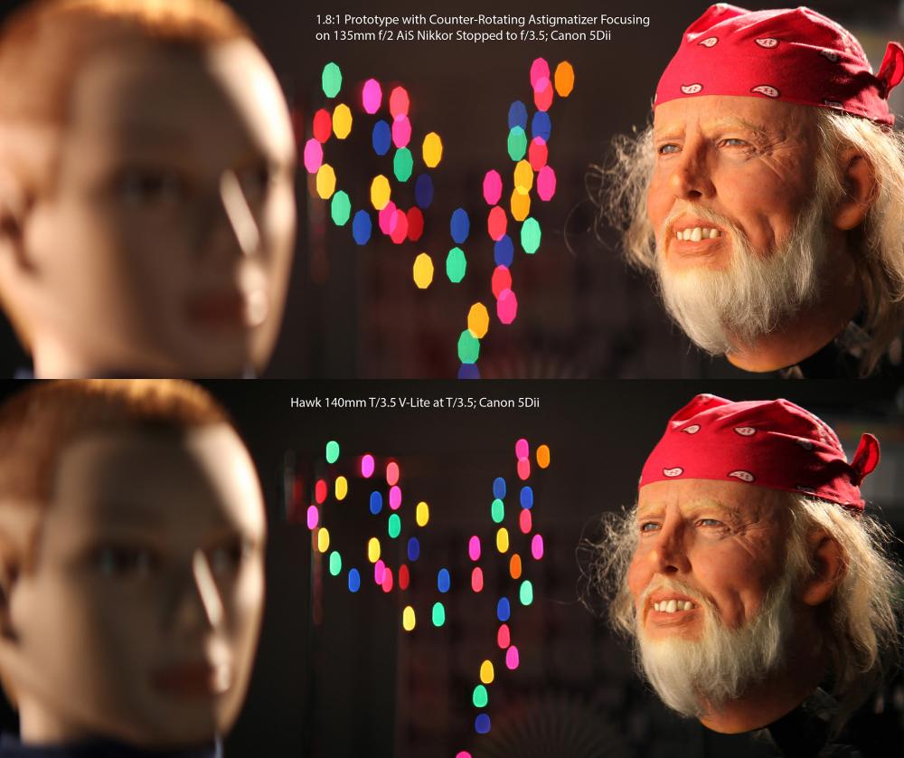

Brian Caldwell Posted February 3, 2016 Share Posted February 3, 2016 I've recently started numerous anamorphic lens projects based on the idea that 1.79x squeeze is the ideal ratio when dealing with a 4:3 sensor . It's often stated that 2x squeeze on 4:3 gives you the DCI standard 2.39:1 scope ratio, but of course this isn't quite true. If you really want a perfect mapping of 4:3 to 2.39:1 without having to crop the sides, then the correct math is: 2.39/(4/3) = 1.7925, which I'll round off to 1.79. So, for the ARRI Alexa, RED Dragon and Panasonic GH4 used in 4:3 mode it seems to me that 1.79x is ideal. Also, if you consider the Alexa in its Open Gate format (1.55:1) you get 1.55 * 1.79 = 2.77:1, which is almost exactly equal to the classic Ultra Panavision 70 (2.76:1 aspect ratio).You might be concerned that 1.79x wouldn't give enough anamorphic artifacts, but based on my experience so far it seems that the artifacts are very similar to 2x, and in addition there are significant advantages in size, weight, cost, and image quality. Some time ago I built a 1.80x prototype that used very traditional rear-group focusing with counter-rotating astigmatizer aberration compensation, and found that it compared very favorably to a similar-spec 2x 140mm Hawk V-Lite: So, my question is, since I'm about to start spending money like crazy developing this stuff, am I crazy to be going in this direction? nahua, shanebrutal and Julian 3 Link to comment Share on other sites More sharing options...

wallpaperviking Posted February 4, 2016 Share Posted February 4, 2016 Sample image looks very promising indeed... My only criticism is the hexagonal bokeh that is shown.. If integrating with a dedicated prime, this would need to have as "circular" bokeh as possible.. Anamorphic loses a lot of its look to me when it becomes hexagonal, which I do not find as appealing..Look forward to more updates! nahua 1 Link to comment Share on other sites More sharing options...
Zak Forsman Posted February 4, 2016 Share Posted February 4, 2016 Thanks for this - its really useful information! Out of curiosity, do you know anything about the Cineroid viewfinders?no sorry.Sample image looks very promising indeed... My only criticism is the hexagonal bokeh that is shown.. If integrating with a dedicated prime, this would need to have as "circular" bokeh as possible.. Anamorphic loses a lot of its look to me when it becomes hexagonal, which I do not find as appealing..Look forward to more updates!that only comes from shooting wide open (or near wide open). anamorphic lenses stopped down will show bokeh that's been shaped by the blades. Link to comment Share on other sites More sharing options...
Brian Caldwell Posted February 4, 2016 Author Share Posted February 4, 2016 Sample image looks very promising indeed... My only criticism is the hexagonal bokeh that is shown.. If integrating with a dedicated prime, this would need to have as "circular" bokeh as possible.. Anamorphic loses a lot of its look to me when it becomes hexagonal, which I do not find as appealing..Look forward to more updates!Thanks for your comments. I agree regarding the bokeh shape. In the case of my test shot the bokeh is actually nine-sided, which is created by the iris shape in the Nikon 135mm f/2 AiS Nikkor that I used as a spherical backer lens. Upcoming integrated primes will use a very circular iris to yield nice smooth elliptical bokeh. Tito Ferradans, Xavier Plagaro Mussard and nahua 3 Link to comment Share on other sites More sharing options...
