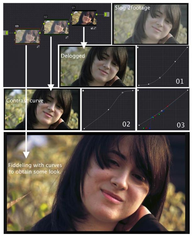

bunk Posted February 5, 2016 Share Posted February 5, 2016 Ebrahim Saadawi showed his method to grade Slog footage in the Sony A6300 thread. In this case Slog 2 footage.http://www.eoshd.com/comments/topic/19110-sony-a6300-4k/?do=findComment&comment=131104 Ebrahinm used a random S-curve. I think by doing so he missed a change to better grade his footage. If you delog your footage with the curve used to created the footage you get way better results, I think. Imho this not only works for Log footage but for every profile from your camera. For some reason that is beyond me you have to rotate the curves from the “normal” profiles 180 degrees to make this methode work. Except for the GH4 (thanks to Balazer) it’s pretty hard to find info on those curves. So that’s kind of a problem. But info on the Log curves can be found everywhere. Back to the Slog-2 footage. The picture below shows it graded in DaVinci. The node 01 correspondents with the curve 01, etc. Last node [01] is the delog node but is the one you start with, kind of backwards. I attached the .dpx file so you can test it out in DaVinci your self. Not sure if you need the .drx slog2_example_2.1.1.dpx slog2_example_2.1.1.drx I would like to hear from others how they grade there (log)footage or is it something you leave to the LUTs? Liam and ricardo_sousa11 2 Link to comment Share on other sites More sharing options...
