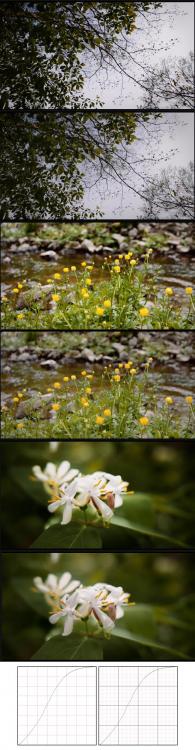

bunk Posted February 6, 2016 Share Posted February 6, 2016 3 hours ago, shanebrutal said: I have yet to find the secrect sauce for grading but I think it's an acceptable image given the price. It's not a secret sauce, but you might want to try this Natural profile curve that was traced from a picture that Balazer posted on dvxuser http://www.dvxuser.com/V6/showthread.php?340370-Exposing-V-LOG-L&p=1986581829&viewfull=1#post1986581829 After tracing it in Photoshop it was placed and rotated 180 degrees within the diagram with the transform tool. I used the curve on your footage and even though you already applied a LUT it shows what it can do. You will need to adjust Lift/Gamma/Gain as well. Link to comment Share on other sites More sharing options...
