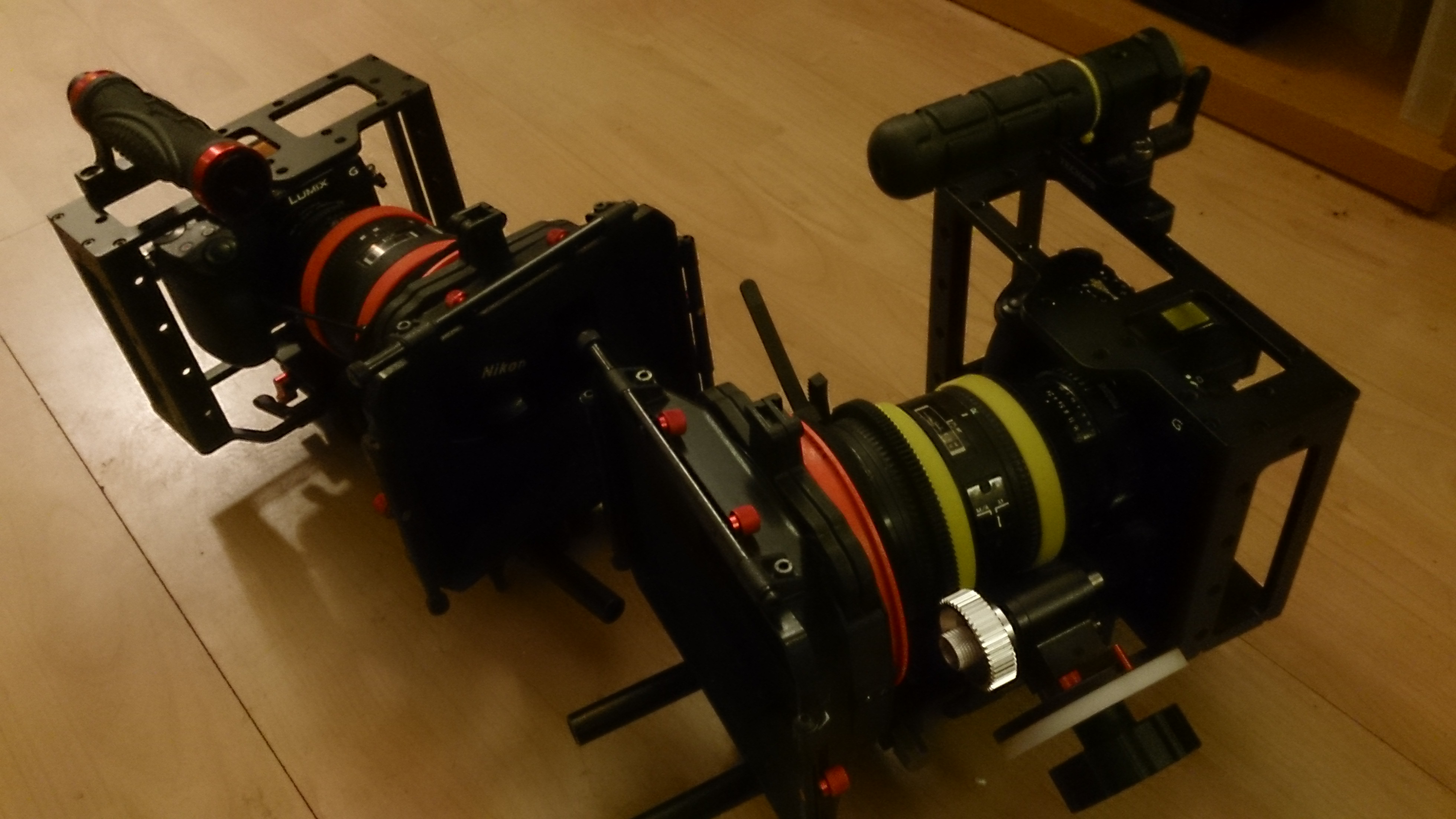

andy lee Posted February 6, 2016 Share Posted February 6, 2016 your XL speedbooster is an amazing essential piece of kit as it makes the 4k Panasonic cameras into very serious film making tools when paired with Nikon 2.8 Zooms , As I mentioned Im DOP on a British Feature film Pandora , we will be shooting this film with PANASONIC G7 4K cameras and Metabones XL Speedboosters. We have done extensive tesing of the G7 camera in 4k 24p mode with Metabones XL Speedbooster at Media City in Salford UK with my post production house - We Create - (Rod Edney and Paul Whiting) and we have found the G7 / Metabones XL Speedbooster combination to be better in low light and less noise in the blacks than the RED 4K files we compared it against and found it also almost indistinguishable from Arri Alexa files we compared it against. The guys at Media City where very impressed with the Metabones XL Speedbooster. All in all we are committed to making the whole movie with Metabones XL Speedboosters on all 4 camera Rigs. Brian I have just PM's you some info - thanks Andy dhso22, TheRenaissanceMan, Cinegain and 2 others 5 Link to comment Share on other sites More sharing options...
