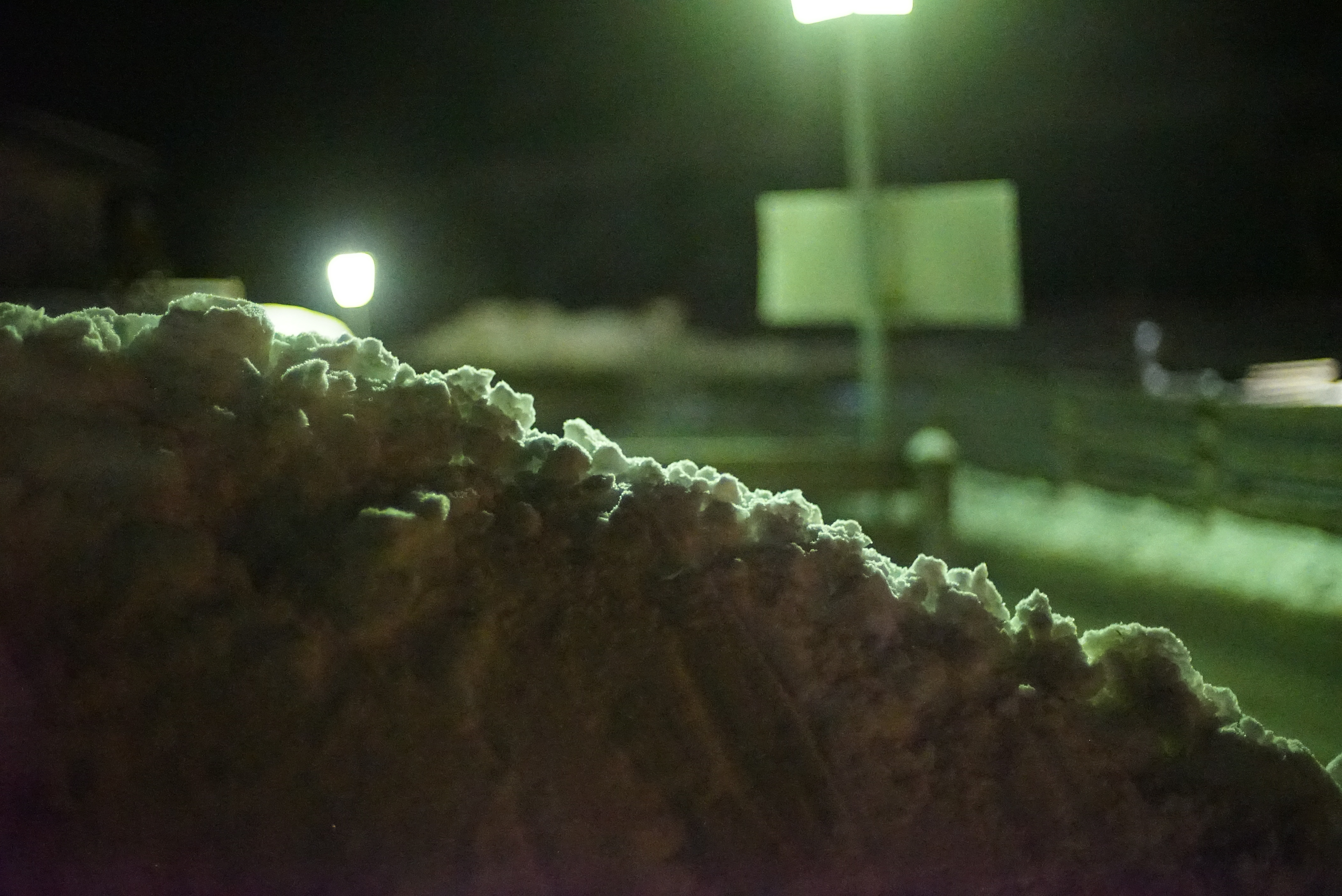

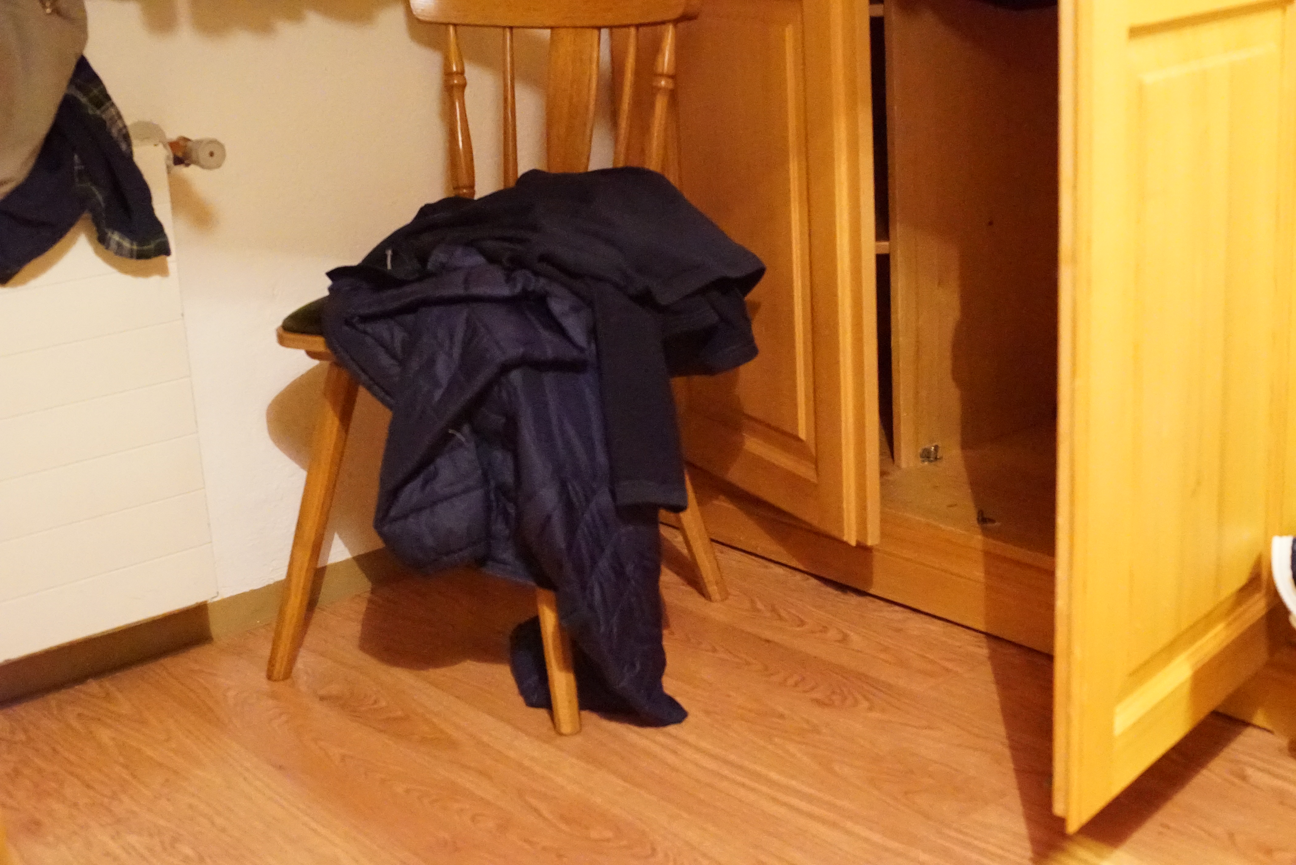

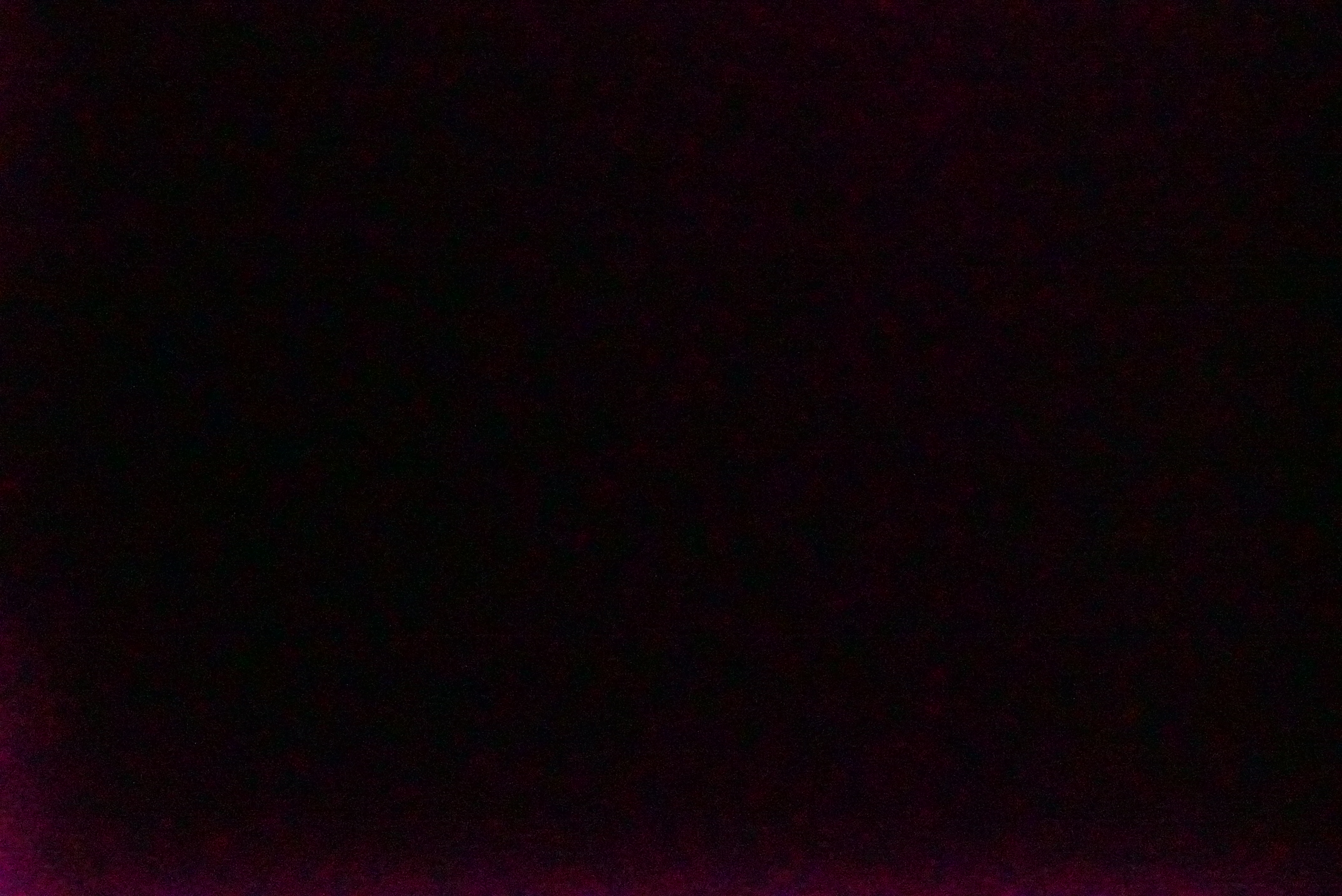

Nikolas Hoose Posted February 7, 2016 Share Posted February 7, 2016 Hi everyone, I have an issue with my A7sII and would like to know if others are experiencing similar things with their A7sII or if I have a faulty unit. Whenever I take a picture in high ISOs (20000 and up) I can see pink color noise in the lower left corner and the bottom of the picture if this area is underexposed. This error doesnt occur if the area is exposed correctly or in any other areas of the image. Also its not visible in live view on the back lcd or evf, but in both the jpeg and raw file (and also Video). Im not surprised to see noise in such high ISOs, but Im concerned about the concentration on one particular area of the picture. Does anyone have similar issues with their A7sII, and if not, what could be the reason for it? Thanks alot in advance! Nikolas Test shot with ISO 51200. Pink noise at bottom definitely visible. Another Test shot with ISO 51200 - this time well exposed. The noise is not visible anymore! Test shot with ISO 409600 and Body-Cap attached. You can clearly see how theres strong pink noise only in the lower left corner and bottom. Link to comment Share on other sites More sharing options...

Nikolas Hoose Posted February 7, 2016 Author Share Posted February 7, 2016 On 2/7/2016 at 4:33 PM, andy lee said: you are at a very very high ISO and pushing the camera to it limits , I never shoot over 800 iso and light the scene for that , Expand I know, and Im very impressed with what this camera can do in low light, but why does this pink noise only occur in this specific area of the image? Link to comment Share on other sites More sharing options...
andy lee Posted February 7, 2016 Share Posted February 7, 2016 its just maybe a charactistic of that particular sensor in your camera , another identical camera may look slightly different at such very high iso Link to comment Share on other sites More sharing options...
agolex Posted February 7, 2016 Share Posted February 7, 2016 In my book it's normal, I've complained about it before. Has been on the original A7S and at least isn't as pronounced on the Mk 2. Nikolas Hoose and BrorSvensson 2 Link to comment Share on other sites More sharing options...
BrorSvensson Posted February 7, 2016 Share Posted February 7, 2016 to me it looks like a super tiny bit of light leakage Link to comment Share on other sites More sharing options...
agolex Posted February 7, 2016 Share Posted February 7, 2016 On 2/7/2016 at 5:10 PM, BrorSvensson said: to me it looks like a super tiny bit of light leakage Expand It's not, I've posted about it before and there have been other threads on it. You have it in dark areas in normal pictures as well. Must be codec/NR/processing related. BrorSvensson 1 Link to comment Share on other sites More sharing options...
Nikolas Hoose Posted February 10, 2016 Author Share Posted February 10, 2016 Thanks alot for the replies! Glad to hear that i probably dont have a faulty unit! Link to comment Share on other sites More sharing options...
