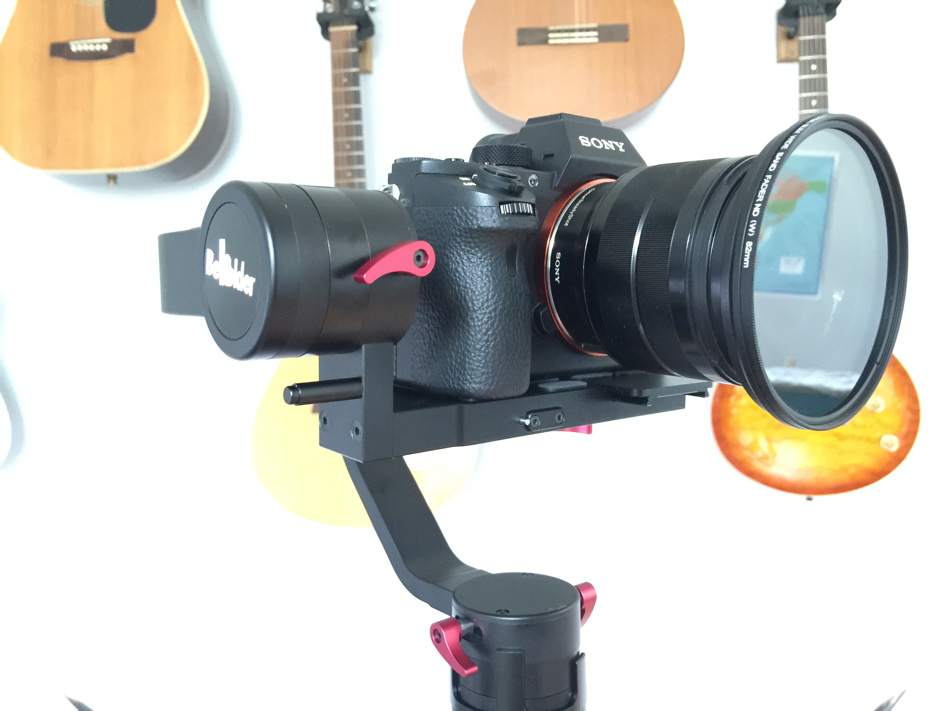

The Chris Posted May 16, 2016 Share Posted May 16, 2016 1 hour ago, Davey said: Spent the last hour looking for a solution - even though mine hasn't broken yet. Might just use another plate at 90 degrees and clamp it in two places. If I drill the arm or weld the original plate in place, I cannot see me being able to sell it in the future. Could you post a picture of your balanced camera when done? I've had the DS1 for a couple months, only used it a few times, but the plate locks in really tight on mine. I spent time when I first got it to make sure my A7rII wouldn't slide out. Once clamped tight, I can't get the camera to move at all. I can't see the camera falling off, its really solid. Did something break on yours? The DS1 is on and balanced without any tuning to the stock PID's in this shot, just positioning the camera until its level. I'm getting no vibration, though in one of the modes it tilts slightly to one side. Davey 1 Link to comment Share on other sites More sharing options...
SR Posted May 17, 2016 Author Share Posted May 17, 2016 7 hours ago, Davey said: Could you post a picture of your balanced camera when done? Well, if only I could get the camera to stay on the DS1. Link to comment Share on other sites More sharing options...
Davey Posted May 17, 2016 Share Posted May 17, 2016 9 hours ago, The Chris said: I've had the DS1 for a couple months, only used it a few times, but the plate locks in really tight on mine. I spent time when I first got it to make sure my A7rII wouldn't slide out. Once clamped tight, I can't get the camera to move at all. I can't see the camera falling off, its really solid. Did something break on yours? The DS1 is on and balanced without any tuning to the stock PID's in this shot, just positioning the camera until its level. I'm getting no vibration, though in one of the modes it tilts slightly to one side. Nothing broken yet, but I can see the tiny screw that secures the base plate's dovetail failing after minimal use - just doesn't feel right. Decided to ditch the 16-35, take another break for a few weeks, try the 55mm on the height plate and perhaps a bit of added weight on the hot shoe. Once I see it working properly and not spinning to the left, I will purchase the less front heavy 28mm F2. Thanks for the picture. Link to comment Share on other sites More sharing options...
The Chris Posted May 17, 2016 Share Posted May 17, 2016 4 hours ago, Davey said: Nothing broken yet, but I can see the tiny screw that secures the base plate's dovetail failing after minimal use - just doesn't feel right. Decided to ditch the 16-35, take another break for a few weeks, try the 55mm on the height plate and perhaps a bit of added weight on the hot shoe. Once I see it working properly and not spinning to the left, I will purchase the less front heavy 28mm F2. Thanks for the picture. I've thought about adding a arca Swiss base and just using a L bracket. I'll take a closer look at the screw, it's not difficult to replace with a higher grade steel screw if needed. The 16-35 is much heavier than the 10-18 I usually fly, even though it's within spec, that's a setup that's really front heavy. That's a small benefit of the a7rII s35 mode, aps-c lenses are much lighter. I can also use the 16-50pz. If I were shooting FF I would use the 28/2 or the Loxia 21. Being able to easily flip the DS1 and get low shots is what sold me on it over the H1 since the H2 wasn't shipping when I bought mine. Hopefully you can get your issues sorted. Cheers Davey 1 Link to comment Share on other sites More sharing options...
