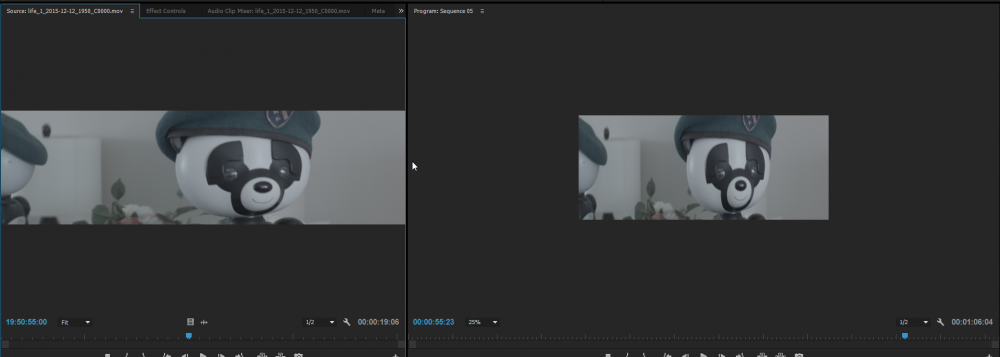

I am doing something wrong here.
1 - I created new sequence 1080 by 800
2 - I right click on my anamorphic video went in to conform to anamorphic2 it squeezed my anamorphic to proper size
3- Keep existing settings when i drag the file in to  sequence
4- Then went in to effect motion tab used scale height scale width to equalize the 2 x in to 1080 by 800
As you can see in the image my left side 2x look properly squeezed but the image on right side does not look right at all specially bears head which is oval in shape not round.
Thanks guys for your help i an new to this premiere
