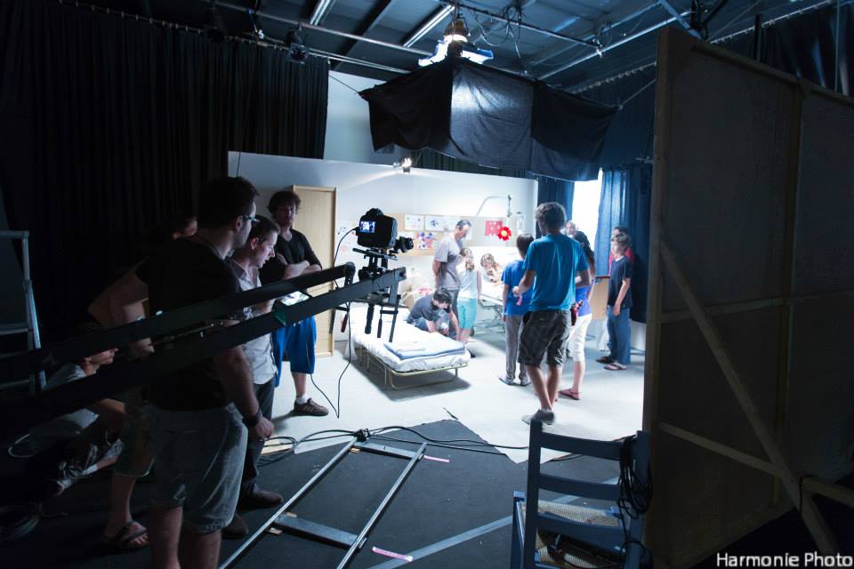

Nicolas MAILLET Posted March 3, 2016 Share Posted March 3, 2016 Hi, 2 x 2K "blond" with diffusion panels in front of them and gels to correct the yellowish tint 3 x 650W ARRI fresnels with diffusion panels most of the time too 1 x 150 ARRI junior fresnel light with some manfrotto magic arm most of the time to reach some points... 2 x LED panels with 200 leds more or less (Chinese cheap ones Aputure) that i almost never use... Low CRI and mixing with other lights is not an easy task. 1 x Chinese ball that is sometime interesting to work with. 400W if i remember well. When i need more, i rent... tomastancredi and Ed_David 2 Link to comment Share on other sites More sharing options...
