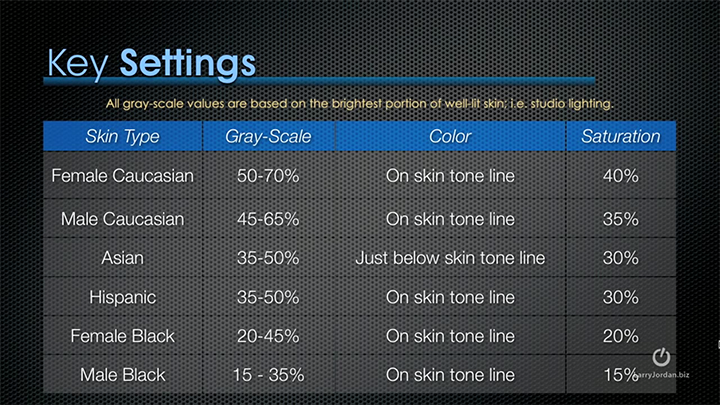

User Posted March 6, 2016 Share Posted March 6, 2016 No sweat Tomsemiterrific, under the gun here but happy to help when I can. I believe these 'values' are for C-Log. But take a look at this thread an contact Cinegain as he (to his credit) put this chart in front of me: And please, feel free to update this thread with your result which are valuable to us all! Link to comment Share on other sites More sharing options...
Cinegain Posted March 6, 2016 Share Posted March 6, 2016 That's the beauty, it shouldn't matter, because your project ultimately isn't working in C-Log colorspace. And the assumption is that you're basing your corrections offa the waveform/vectorscope within your project (not the footage) read-out as well-lit skin should appear already color corrected. That doesn't really change, as Larry states: our brains are programmed to know three colors: blue skies, green grass and skintones. Working with greyscales and the skintone line allows us to have a reference that shouldn't look off. Of course these are just guide values and ranges and apply to well-lit skin, which might not be the case in your scene, or perhaps you were shooting the Hulk or some fellow from Avatar. But you could correct a whole scene, just by nailing bare well-lit skintone. So you do have to eyeball the ultimate tweaks. But those general values should get you darn close. The video that goes with it shows it nicely I think... You might want to check this Color Correction Handbook by Alexis van Hurkman : http://www.amazon.com/Color-Correction-Handbook-Professional-Techniques/dp/0321929667 who talks in great depth about this. The actual referenced book in the video: the Encyclopedia of Color Correction is from 2006, the later Handbook (2nd ed) from 2013. P.s. I'm no authority on color correction or Canon footage, I'm just a guy who conviently comes across the helpful stuff of others. User 1 Link to comment Share on other sites More sharing options...
