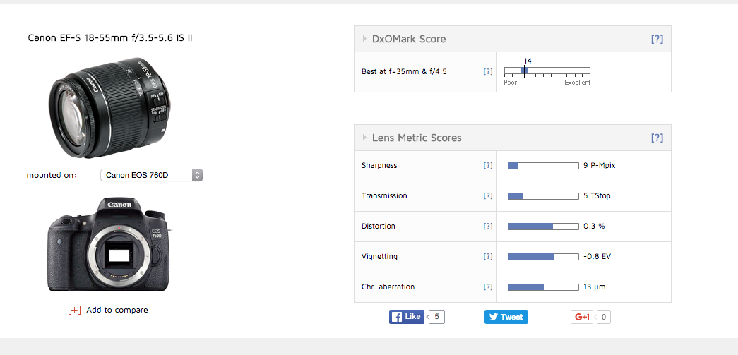

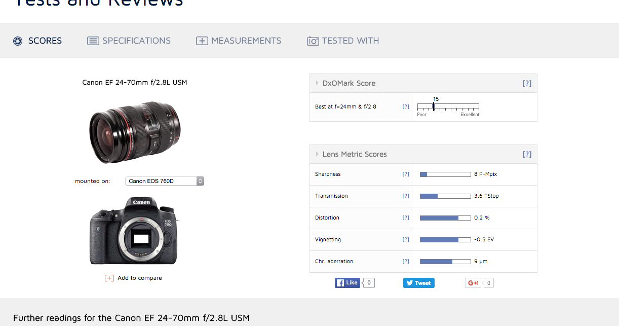

BrorSvensson Posted March 11, 2016 Share Posted March 11, 2016 3 minutes ago, richg101 said: the 24-70/2.8 is designed with the a7rii in mind.. so even cropping into it, the lens will outdo most purpose built aps-c lenses. The 24-70 is tested to perform similary to the canon 24-70. Here is that lens on the 24mp canon vs the cheapest apsc on the same camera. I think you the a6000 with 16-70 and a6300 with 24-70 GM would give similar results. Link to comment Share on other sites More sharing options...
richg101 Posted March 11, 2016 Share Posted March 11, 2016 i'll wait for the dxo test of the G 24-70. Sony won;t get away with selling a modern 24-70 that doesnt deliver on their flagship camera. it'll have been optimised and since there is no mirror to hinder the design approach the sony g will certainly outdo the canon. the above comparison shows that the aps-c lens has almost twice the chromatic aberration. - double the CA equates to a lot more usable perceived resolution loss IMO Link to comment Share on other sites More sharing options...
BrorSvensson Posted March 11, 2016 Share Posted March 11, 2016 19 minutes ago, richg101 said: i'll wait for the dxo test of the G 24-70. Sony won;t get away with selling a modern 24-70 that doesnt deliver on their flagship camera. it'll have been optimised and since there is no mirror to hinder the design approach the sony g will certainly outdo the canon. the above comparison shows that the aps-c lens has almost twice the chromatic aberration. - double the CA equates to a lot more usable perceived resolution loss IMO About the last line, keep in mind that the 18-55 is a 100 dollar kit lens. the 16-70mm f4 is 1000 dollar lens. Link to comment Share on other sites More sharing options...
