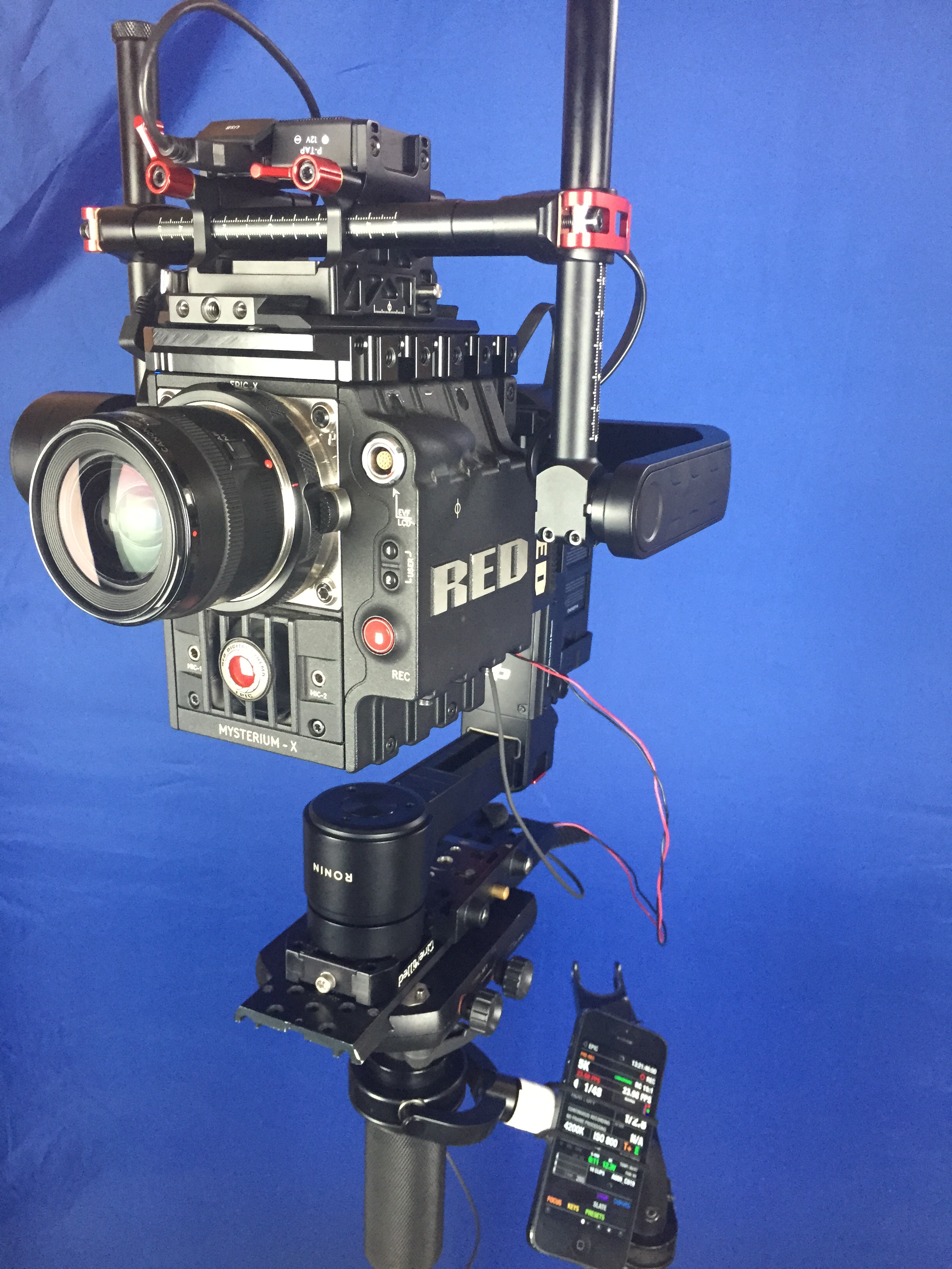

bzpop Posted March 15, 2016 Share Posted March 15, 2016 mount your Ronin M on steadicam and that's where the fun begins! Link to comment Share on other sites More sharing options...
Snowfun Posted March 15, 2016 Author Share Posted March 15, 2016 Why didn't I think of that! Link to comment Share on other sites More sharing options...
