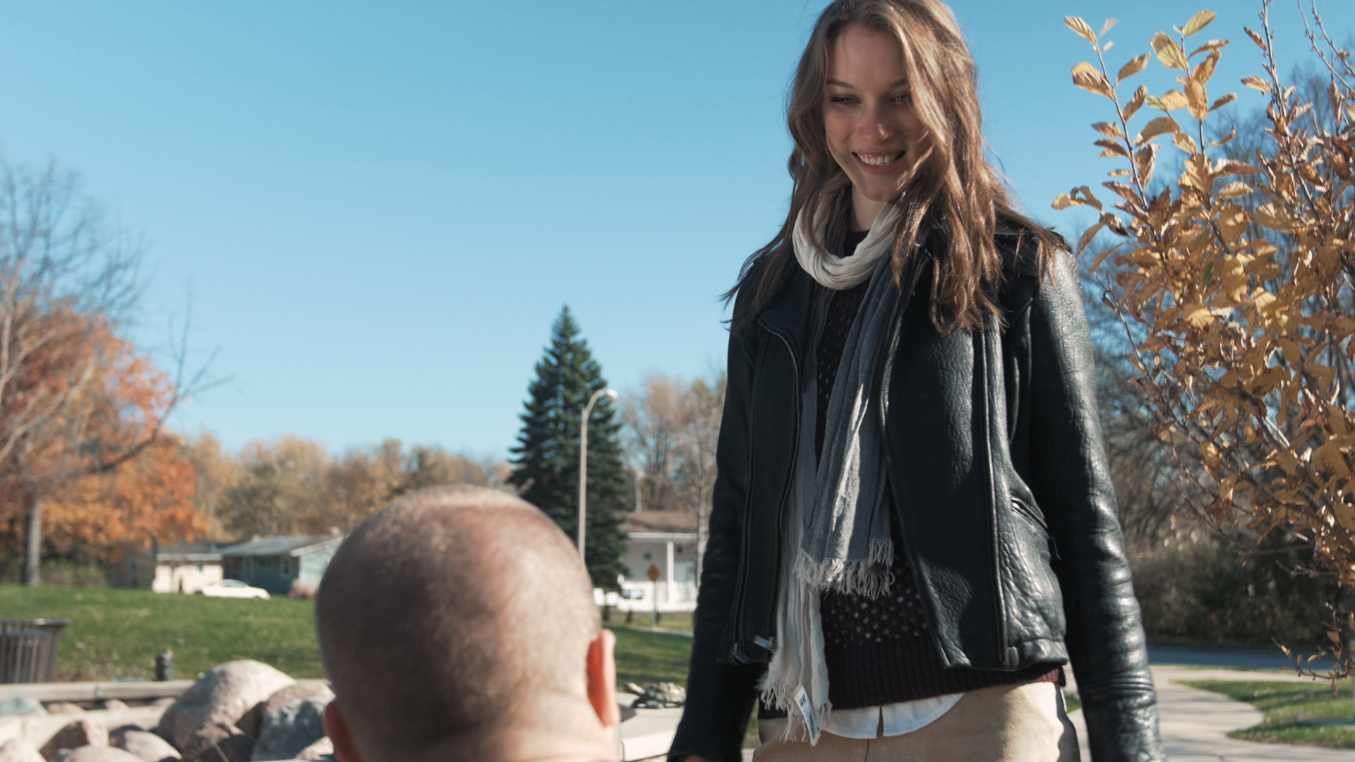

Vesku Posted March 16, 2016 Author Share Posted March 16, 2016 7 minutes ago, AaronChicago said: Something is definitely wrong here b/c I use the GH4 all the time outside and never see banding in the sky (other than V Log). Can you post a GH4 video capture frame without banding in sky gradient? Link to comment Share on other sites More sharing options...
AaronChicago Posted March 16, 2016 Share Posted March 16, 2016 Here is a JPEG, as well as a TIFF for download on dropbox: https://www.dropbox.com/s/guci7tvzdo560ck/SkyTiff.tif?dl=0 It was the most extreme example I could find of a gradient sky. Link to comment Share on other sites More sharing options...
Vesku Posted March 16, 2016 Author Share Posted March 16, 2016 Thanks, Aaron. Looks quite good. There is still some roughness in sky. GH4 codec adds dithering. It helps but the JPG photo is still better. How did you do that capture? Can you remember settings? Looks cineD to my eyes: AaronChicago 1 Link to comment Share on other sites More sharing options...

AaronChicago Posted March 16, 2016 Share Posted March 16, 2016 4 hours ago, Vesku said: Thanks, Aaron. Looks quite good. There is still some roughness in sky. GH4 codec adds dithering. It helps but the JPG photo is still better. How did you do that capture? Can you remember settings? Looks cineD to my eyes: Yeah this was from 2014 so I'm 99% sure it's Cine D. I just opened the old project in Premiere and exported the frame from a timeline to JPEG and TIFF. Link to comment Share on other sites More sharing options...
Danko Posted March 16, 2016 Share Posted March 16, 2016 6 hours ago, Vesku said: Thanks, Aaron. Looks quite good. There is still some roughness in sky. GH4 codec adds dithering. It helps but the JPG photo is still better. How did you do that capture? Can you remember settings? Looks cineD to my eyes: I saw your post few days ago and only today got around to look at the projects. I found only one instance, a pretty bad one. When I looked into it better, I realised it was pushed hard, hard. Over the past few years I've been filming corporates for two agencies and almost raped the London skyline to the extent that I have it in some iteration up to three times in four, five minute finals. I don't have banding in these shots, no matter what profile I used. Even internal V log looks good, but it's always scaled down to 1080 and Juan Melara's luts (used it with red and wanted to try and keep consistent) I would try and reset everything and start from the scratch. P.S. To crush hopes of all those who might go on to think that downscale to 1080p and JM print luts are some magic way to correct all the faults of V log, they are not. While skies are great, (non-white) walls often look mushy. Link to comment Share on other sites More sharing options...
