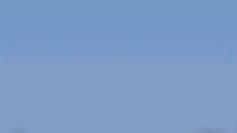

omen Posted April 21, 2016 Share Posted April 21, 2016 Few examples when the circus starts. This is with one generation loss from frame grabs taken from the video then pushed, in Resolve results are better. Intentional approach to show few principles happening and why all the fuss. A6300, 1080p XAVC-S, 1:1 crop First example - direct frame grab from S-Log3, S-Gamut3, taken into Photoshop with contrast and saturation Second example - same frame grab with test Primer applied, nothing else. Notice how the second image almost looks like it has been blurred due to more gradual transitions in between. Also, notice how the second image although has more saturated and "healthier" blues has reduced compression visibility due to finer transitions. This is because the signal has been "ironed" on micro level, to fix the hue/saturation/luminosity offsets which, once enhanced in color correction, increase the visibility of compression. This is the example when Primers help in this context. In some cases the results are the same, depending on the amount/type of compression artifacts. This is the third benefit of Primers. That particular compression related part wasn't planned, I discovered it through parallel tests later. jgharding 1 Link to comment Share on other sites More sharing options...
