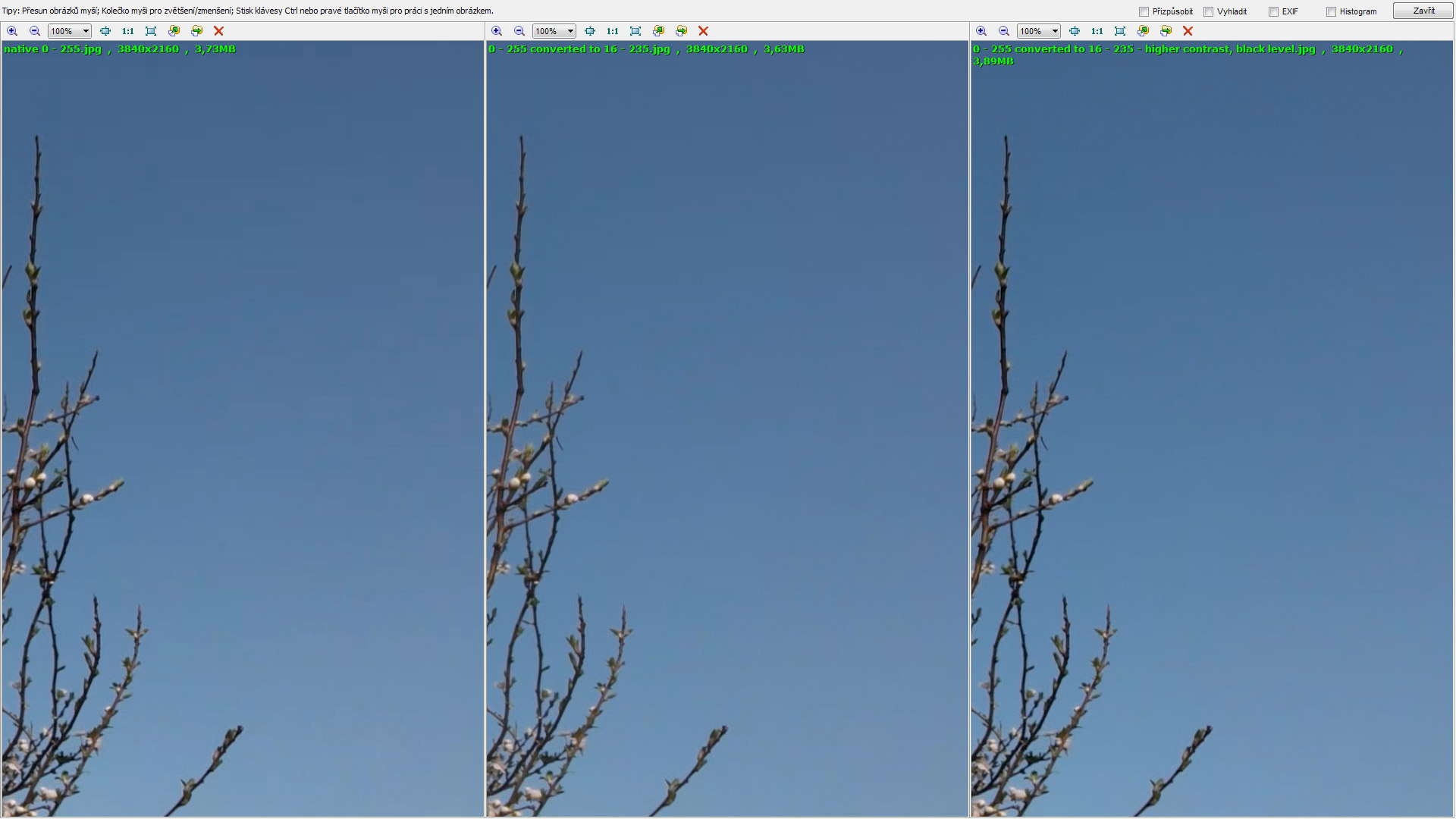

Pavel Mašek Posted April 11, 2016 Share Posted April 11, 2016 21 hours ago, Andrew Reid said: Is the top one 80Mbit and second one 160? In the top one the sky is still macro blocking quite a lot. I have to say that I shot it in 0-255 luma range, maybe it would be better with 16-235... Link to comment Share on other sites More sharing options...
Pavel Mašek Posted April 12, 2016 Share Posted April 12, 2016 On 10. 4. 2016 at 0:11 PM, Andrew Reid said: In the top one the sky is still macro blocking quite a lot. I have changed luminance levels in Premiere from 0-255 (1st image fom the left) to 16-235 and some compression artifacts disapeared, even I have pushed contrast and black level higher to prove if there are really gone (3rd image) Link to comment Share on other sites More sharing options...

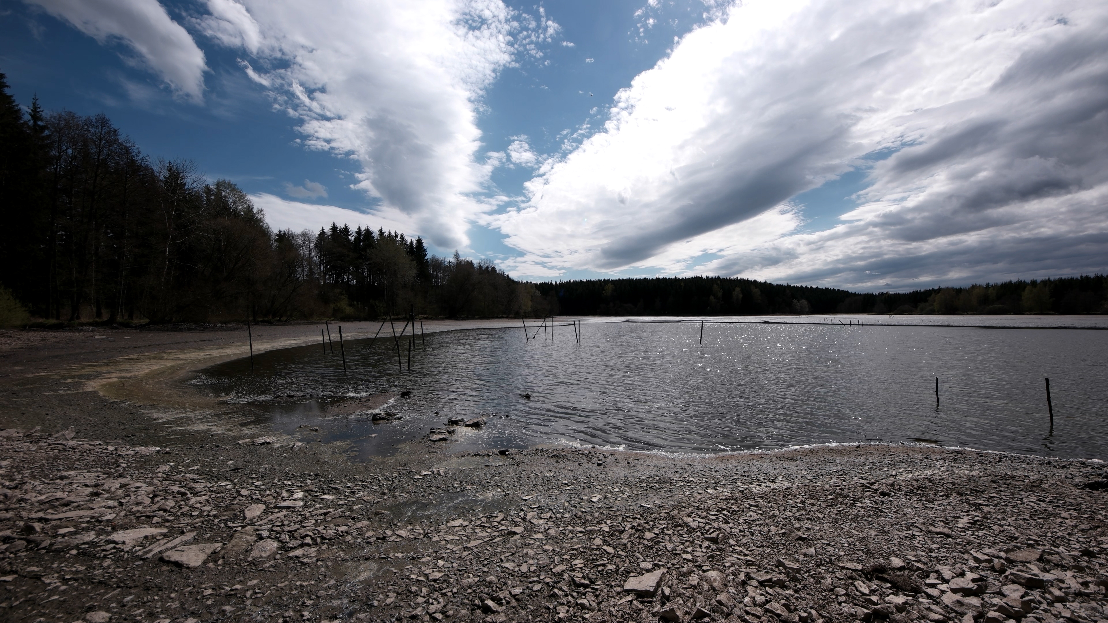

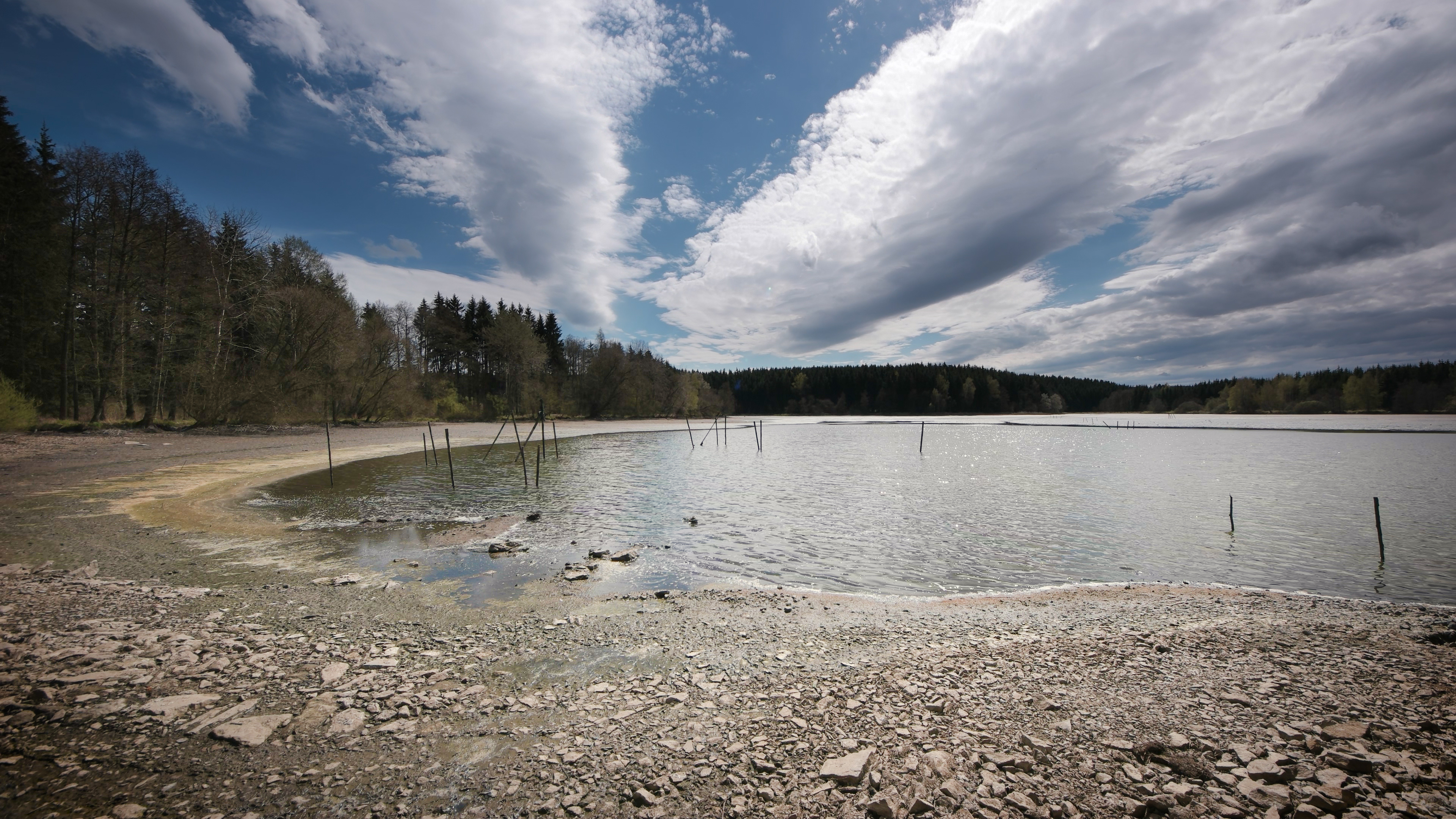

Pavel Mašek Posted April 18, 2016 Share Posted April 18, 2016 DR of 180Mbps footage. Great thing is there is no macroblocking in lifted shadows, just litle lack of details... but still very good result I think. BTW - First image is unedited 0-255, Standard, MBL +8. Second is converted to 16-235 with some grading (also added saturation becuase there was lack of colours in shadows and just a little bit sharpness to left side of image) saintsimon2016 and Hanriverprod 2 Link to comment Share on other sites More sharing options...

MountneerMan Posted April 19, 2016 Share Posted April 19, 2016 18 hours ago, Pavel Mašek said: DR of 180Mbps footage. Great thing is there is no macroblocking in lifted shadows, just litle lack of details... but still very good result I think. BTW - First image is unedited 0-255, Standard, MBL +8. Second is converted to 16-235 with some grading (also added saturation becuase there was lack of colours in shadows and just a little bit sharpness to left side of image) Wow that is amazing. is that the NX1 or the NX500? Link to comment Share on other sites More sharing options...
Pavel Mašek Posted April 19, 2016 Share Posted April 19, 2016 6 minutes ago, MountneerMan said: Wow that is amazing. is that the NX1 or the NX500? I forgot mentioned it - NX1. Moreover - it is screen grab from in-camera timelapse so it is not so static scene but quite complex with fast moving trees, waves and clouds. There was some small macroblocking in blue parts but they disappeared after conversion to 16-235. vaga 1 Link to comment Share on other sites More sharing options...
