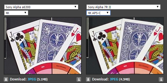

tellure Posted April 9, 2016 Share Posted April 9, 2016 DPReview gave the A6300 85% & their gold award. Guess overheating isn't a big deal for $1k camera buyers these days. The video image quality comparison is interesting.. A6300 looks over-sharpened vs. the A7R2 but I'd also say it has more detail, even comparing to the A7R2's APS-C mode: Link to comment Share on other sites More sharing options...
alexO Posted April 14, 2016 Share Posted April 14, 2016 On this dpreview's video still comparison a6300 in HD looks worse than a6000 and significantly worse than let's say NX500 or GH4. Link to comment Share on other sites More sharing options...
