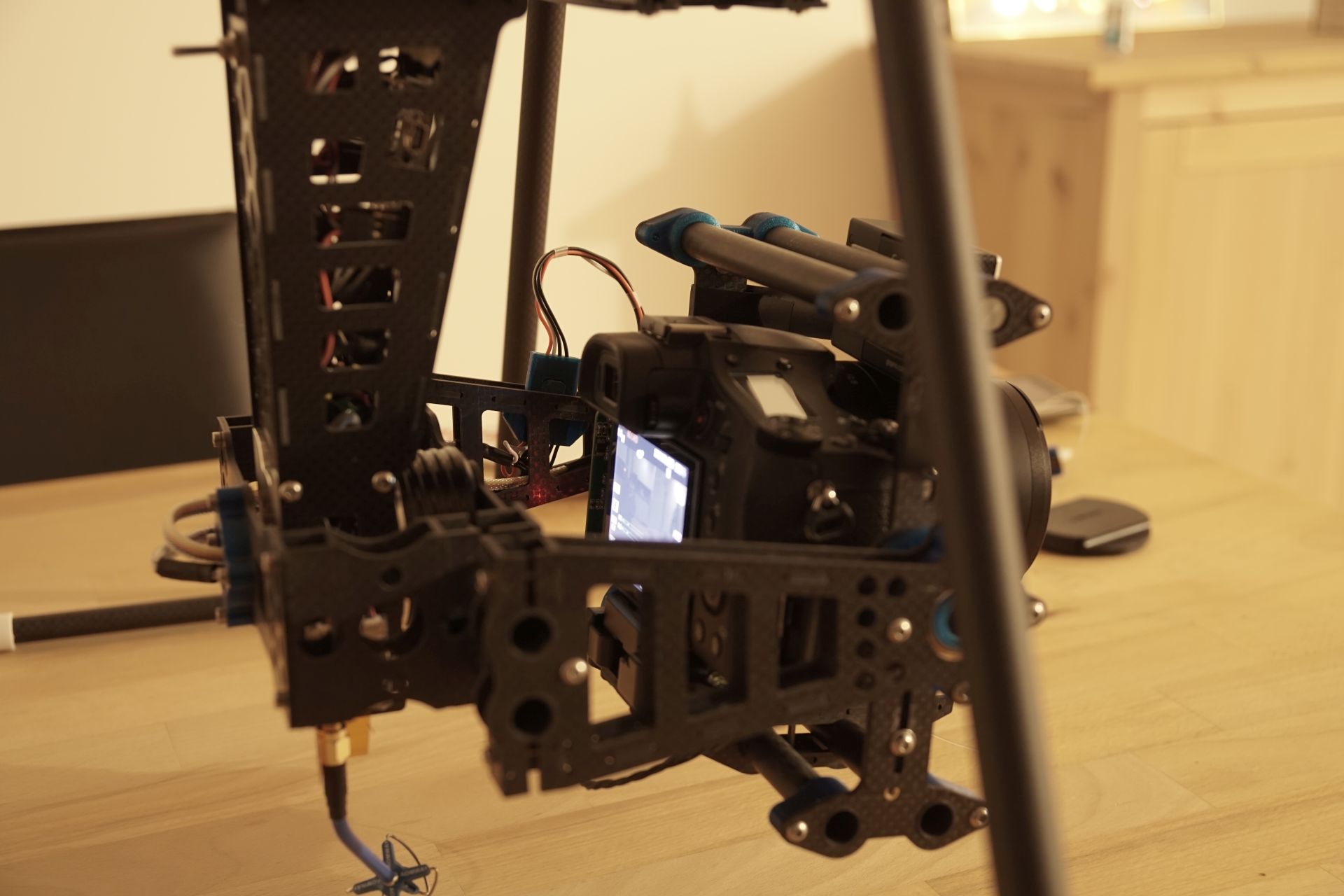

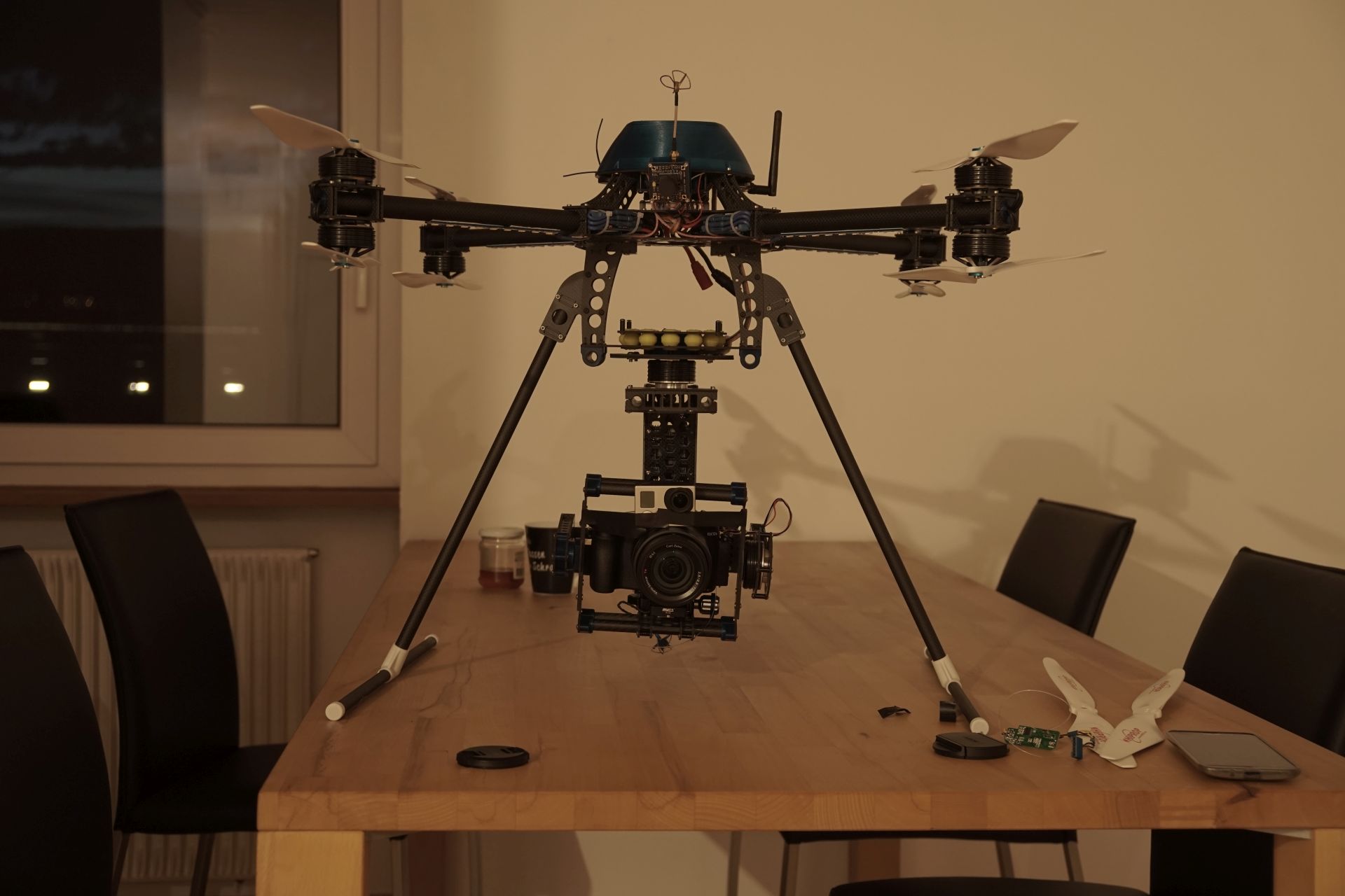

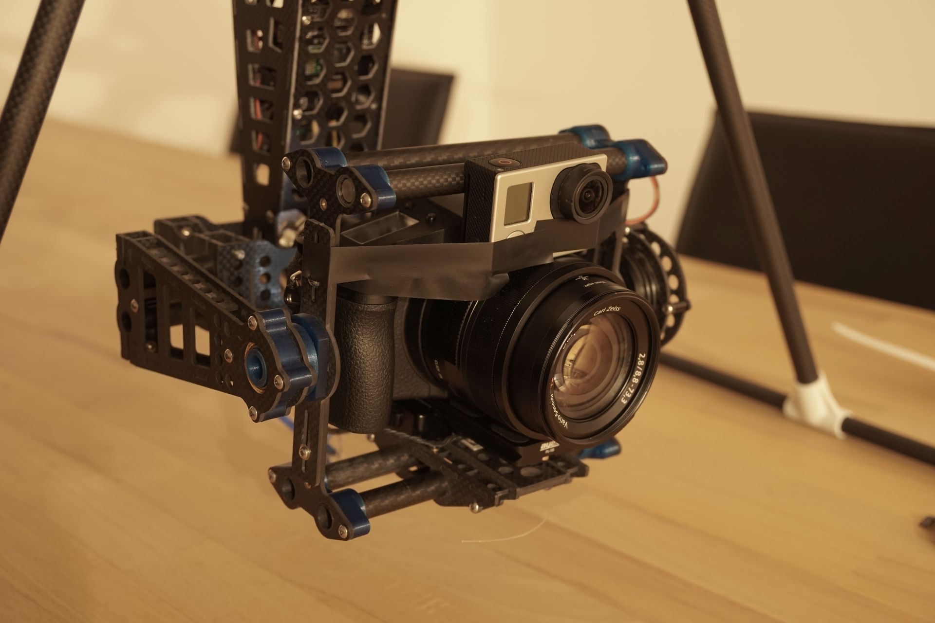

Bukker Posted March 30, 2016 Author Share Posted March 30, 2016 sooo, I did the test with the Gopro. Now it's clear, it's not a gimbal problem, it's a RX10II problem. The Gopro footage looks smooth while the RX10II looks partially really terrible. The big question is: is it lens related, is the sensor related, or something else? I hope someone from Sony can give a statement on this. This would help a lot of customers the choose the right camera for aerial shots. I upload the comparison between the RX10II and the GoPro later. BTW, this is my test setup: Ivanhurba 1 Link to comment Share on other sites More sharing options...
Bukker Posted March 31, 2016 Author Share Posted March 31, 2016 Here is the proof: It seems to be a RX10II problem... :-( Now I'm definitely depressed... Link to comment Share on other sites More sharing options...
