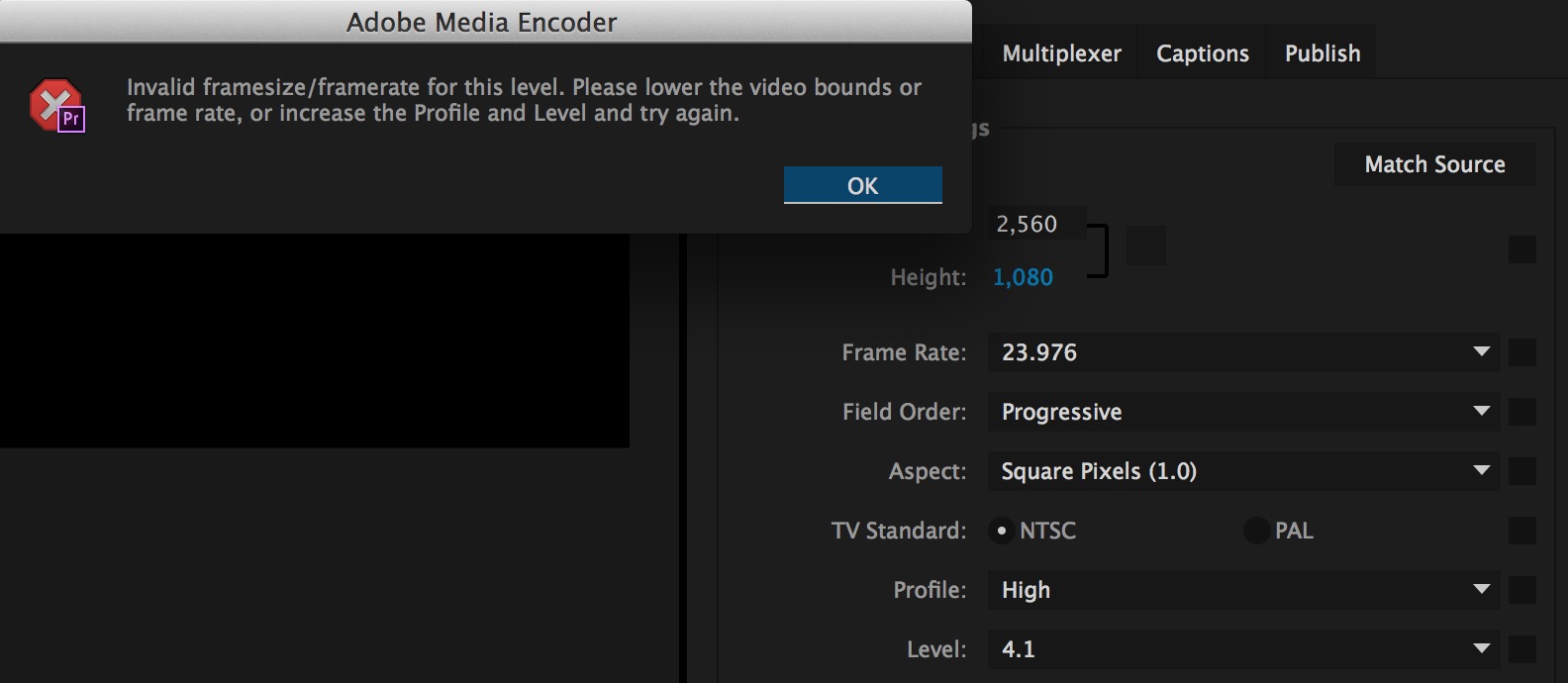

User Posted May 23, 2016 Share Posted May 23, 2016 On 4/6/2016 at 11:28 AM, Geoff CB said: Start with vimeo 1080p preset then: Export in 1440p CBR at 90 mbps for 1080p - I'm working in PPro CC. When exporting, after selecting Vimeo 1080p, I can not find the way to set 90mbps. Nor will it allow me to select 2560x1440. I can however, select CBR. What gives? Link to comment Share on other sites More sharing options...
Geoff CB Posted May 23, 2016 Share Posted May 23, 2016 25 minutes ago, User said: - I'm working in PPro CC. When exporting, after selecting Vimeo 1080p, I can not find the way to set 90mbps. Nor will it allow me to select 2560x1440. I can however, select CBR. What gives? After selecting CBR there should be a slider underneath you can drag to adjust bitrate. For 2560x1440 you need to uncheck the box beside 1920x1080 and manually enter in the numbers. User 1 Link to comment Share on other sites More sharing options...
User Posted May 23, 2016 Share Posted May 23, 2016 3 minutes ago, Geoff CB said: After selecting CBR there should be a slider underneath you can drag to adjust bitrate. For 2560x1440 you need to uncheck the box beside 1920x1080 and manually enter in the numbers. Hey Geoff, thanks for jumping in. I unchecked the box beside 1920x1080 but when I tried to enter 2560x1440 PPro wouldn't allow it. I'll give it another shot when the current export is finished but somehow I couldn't make it happen. I'll report back if I still can't swing it. Thanks again. Link to comment Share on other sites More sharing options...
User Posted May 23, 2016 Share Posted May 23, 2016 Not possible. Link to comment Share on other sites More sharing options...
