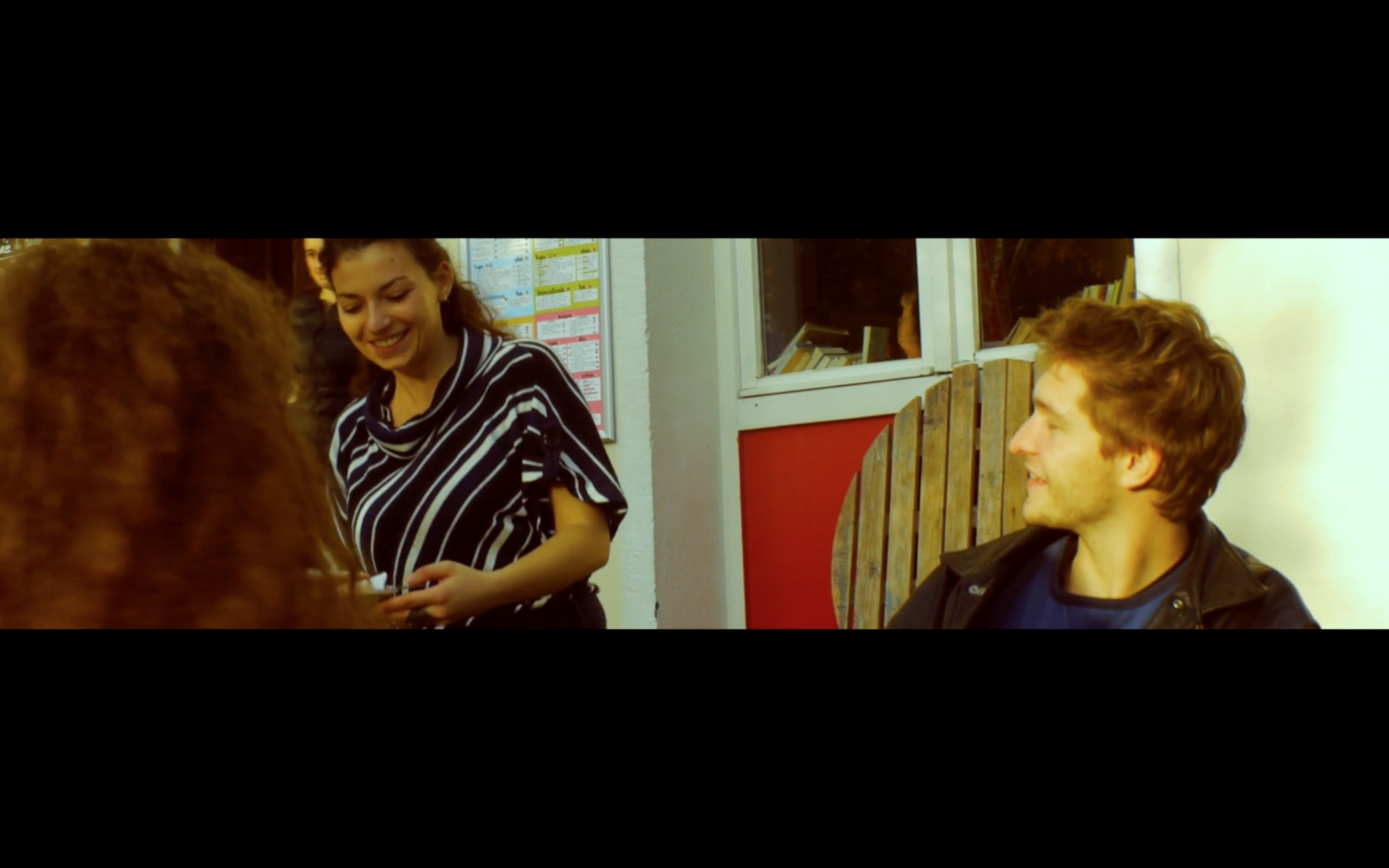

Yell'o Dylan A Lieshout Posted April 7, 2016 Share Posted April 7, 2016 I am selling a great anamorphic attachment, including a clamp adapter to 49mm and a +3 DHG diopter. The glass is thrilling. Colors are really warm and it can get really sharp when the diafragma is closed. Very smooth flares and focusses really fluently. You get a 3.6:1 ratio out of it. In my opinion it is way better than the known Bolex attachments. Reason for selling it is that I rent Kowa lenses in a set nowadays. Open to bids from 700 dollars. This is the add on the dutch ebay: http://www.marktplaats.nl/wijzigAdvertentie/m1001007585.html?c=d721e818194200feca4409741512b6e6&previousPage=mympSeller Located in Amsterdam. Local pickup possible. I send internationally. email: jellelieshout@me.com , phone: +31 6 1017 2042 footage shot with a Helios 44m (so would perform even better with a better prime) and the diafragma wasnt closed to the max. Link to comment Share on other sites More sharing options...

Yell'o Dylan A Lieshout Posted April 7, 2016 Author Share Posted April 7, 2016 just did a test wide open and all of a sudden I noticed that it does get incredibly sharp, but that the depth of field gets so shallow that you dont see easily on what it focusses. Only used it for landscapes and stages, so never noticed that. I can get a subject at 1 meter very sharp with the prime lens wide open! You know what? I will try to make a video tomorrow of the sharpness wide open! Link to comment Share on other sites More sharing options...

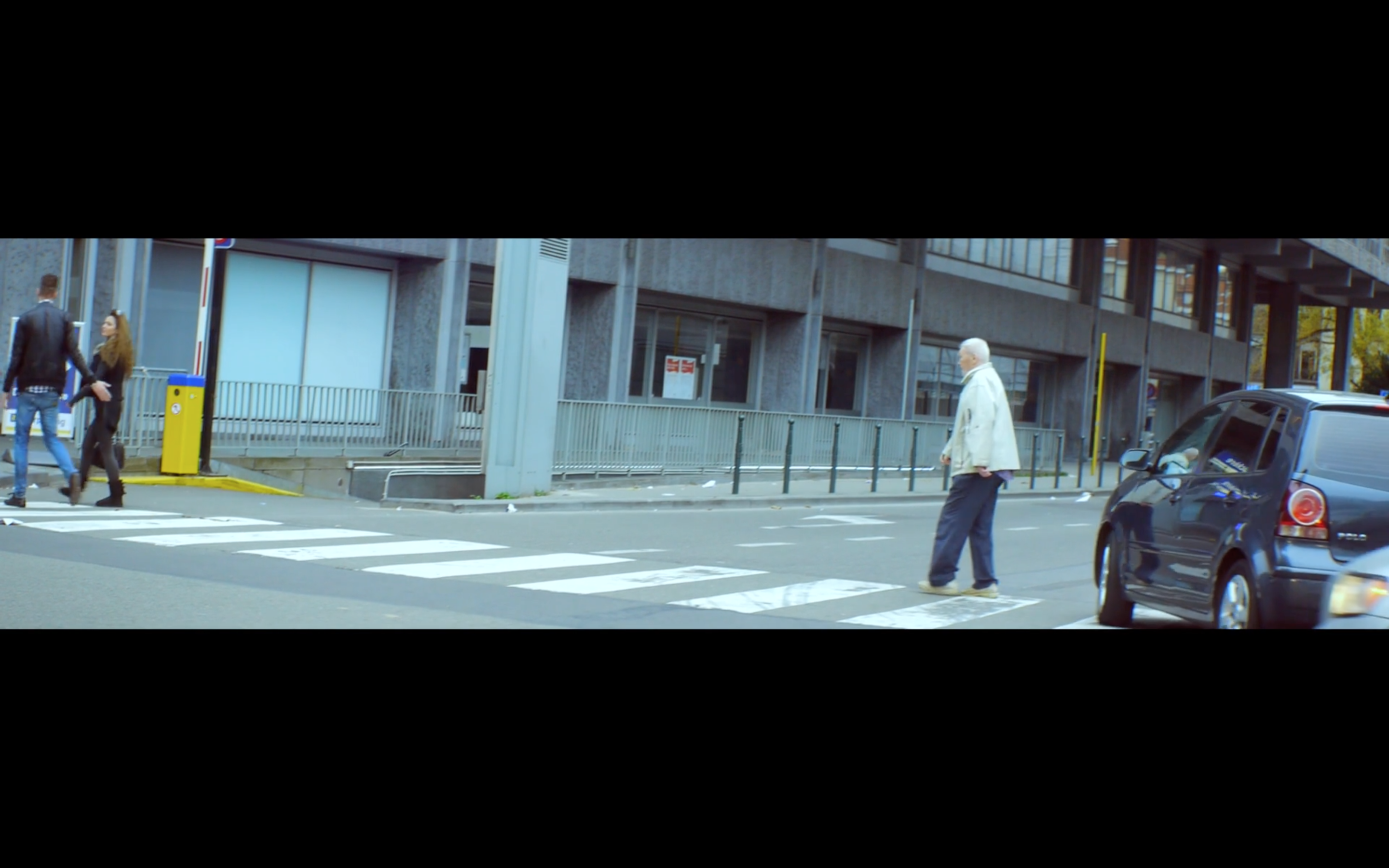

Yell'o Dylan A Lieshout Posted April 8, 2016 Author Share Posted April 8, 2016 No diopter used. When you close it to a point between f2 and f2.8 it gets really sharp. Footage is with the diafragma wide open (f2). Very shallow depth of field, even near infinity. Shot of book was at 1,5 meter. Link to comment Share on other sites More sharing options...
tweak Posted April 8, 2016 Share Posted April 8, 2016 Agreed, Kowa lenses have a lovely look. What taking lens did you use for the above video? Link to comment Share on other sites More sharing options...
Yell'o Dylan A Lieshout Posted April 8, 2016 Author Share Posted April 8, 2016 Helios 44m Gh2 with the intravenous hack Link to comment Share on other sites More sharing options...
